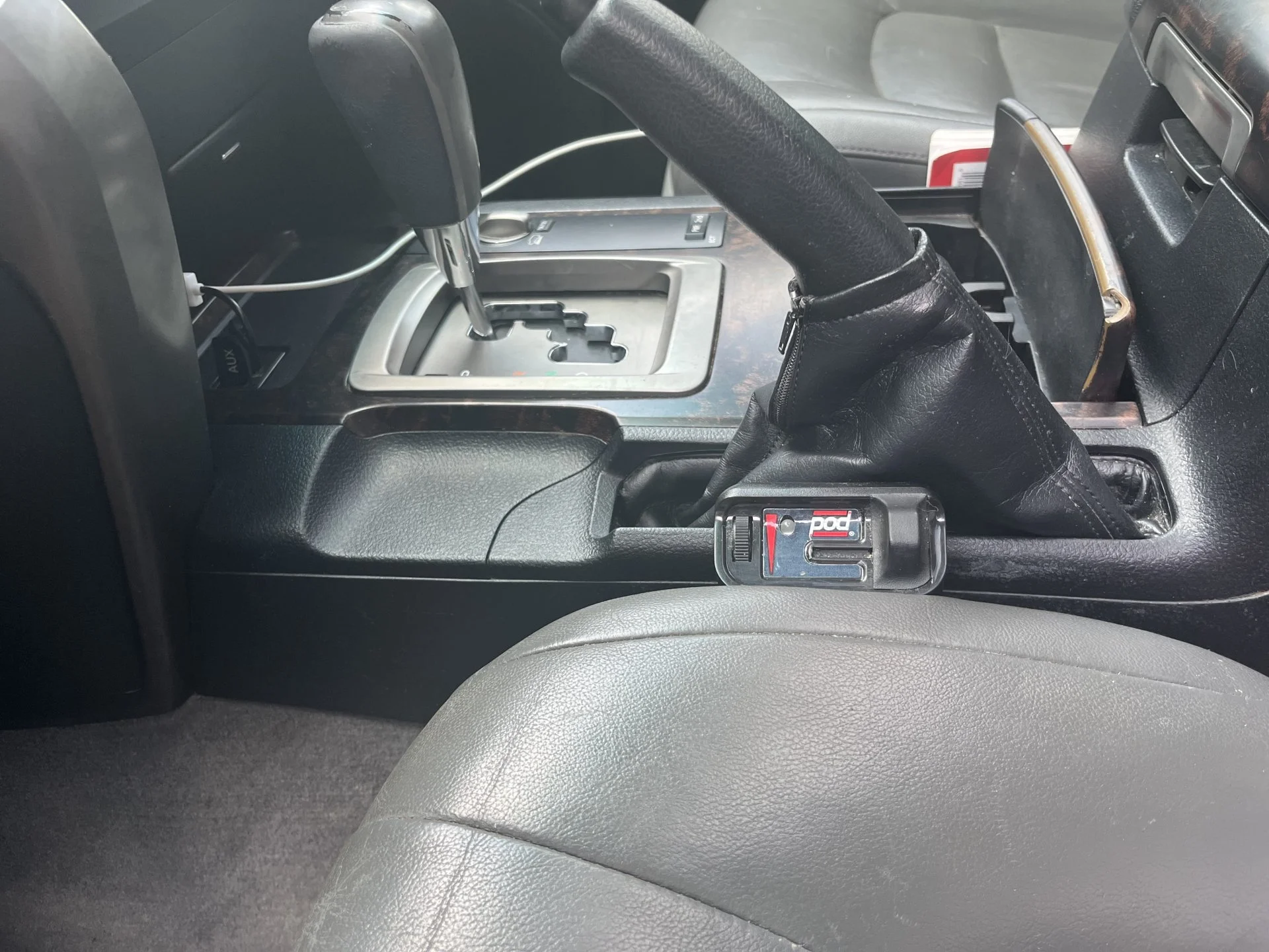

I use a Tekonsha POD in both my Tacoma and 200 series for my lightweight trailer. It is very simple, and doesn't have to be mounted in any particular orientation.
Tekonsha Pod - Amazon

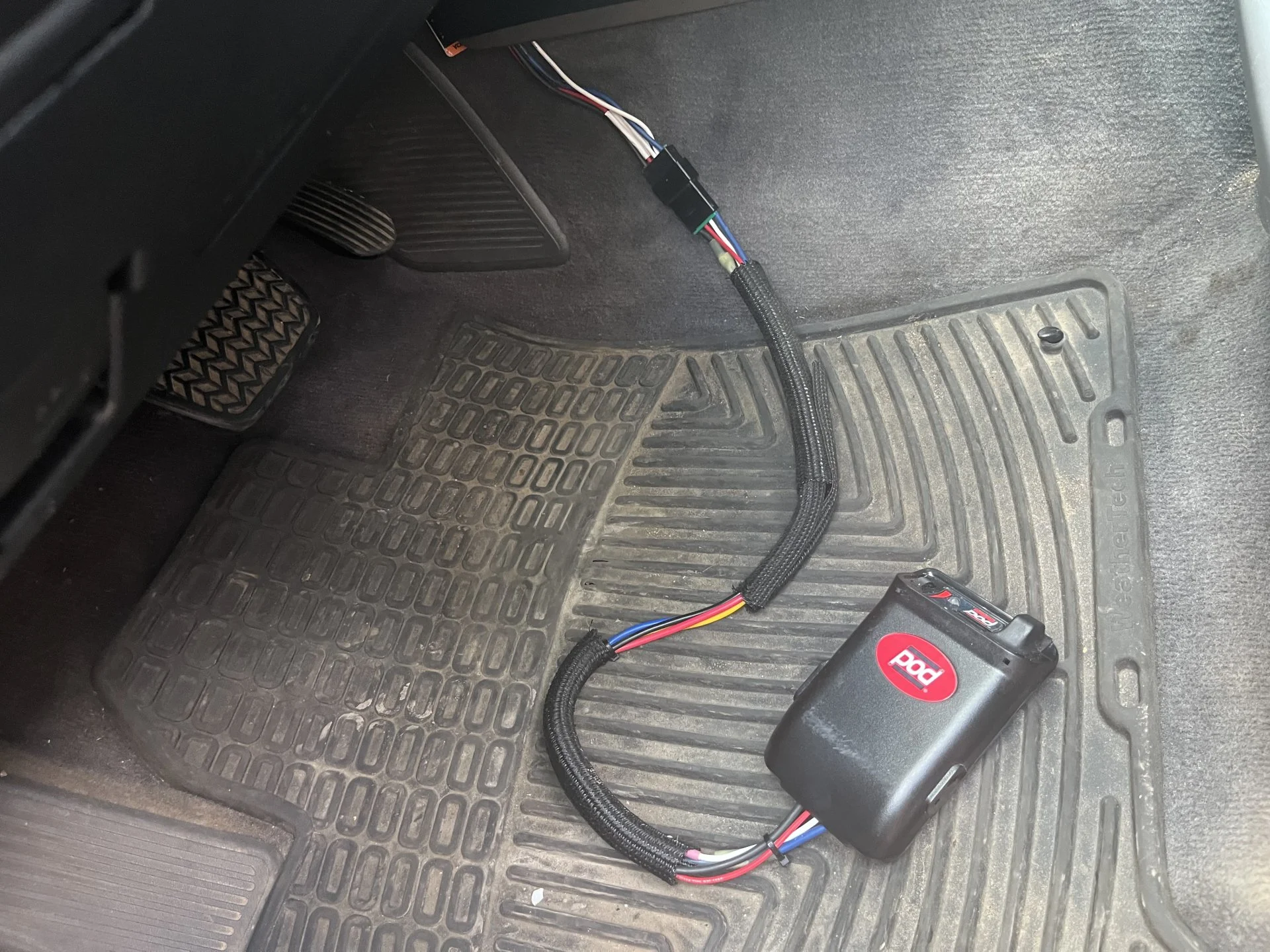

In my 200 I plugged in the factory harness and routed it to the panel just under the knee pad. Then I made a short adapter harness to attach the POD. I remove the POD when I am not using it, and when I am using it, I just stuff it between the seat and the console. I'd highly recommend this route if you tow small electric brake trailers rarely.
All of the wiring you need should be included between the Toyota electric brake harness and the POD adapter for Toyota vehicles. Here's a few quick snaps:
And yes, there are more sophisticated controllers out there than the POD, and I would recommend these for regular pulling of heavy trailers. The POD is a good low cost option that you can install without having to drill your dash to mount for occasional towing duties, especially lightweight trailers with brakes. That said, I towed 6k lbs from SC to NH with my Tacoma using this setup and never once felt that the braking performance was lacking.
