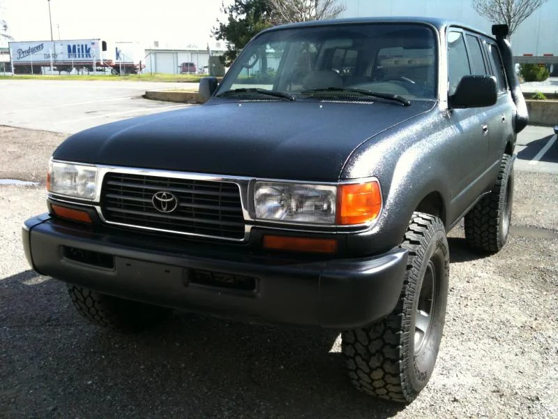

Here is my Intake setup. It was made from Fiberglass, then seam sealed to the body and then Rhyno lined. I will try to dig up the old pictures sometime. I have an old thread on here from about 5 years back. I thought it would be good to report that my rear mount turbo has been very reliable and I have only done regular maintainence and a couple tune ups. I have been able to tow very well and drivability is much better than stock. I can't imagine a N/A 80... My truck was rebuilt with stock parts just before the build. I did use the updated Toyota HG and Supra Head Studs. :)

Nice! It appears you came up through the floor on the inside? Any pics of that part? And how did you seal the floor? :cheers:
That's what I'm talking bout! Great work! I would love to see the complete setup you have. Glad to see another rear mount with some reliable mileage on it.
I used a Plumbing Coupler similar to this. My Turbo has a 4" inlet. The inside, sadly isn't pretty at all. There is a large K&N Filter in an inclosure & there is no chance that I will post a pic. It's Ghetto Fab. I plan to rebuild the inside this year sometime.
