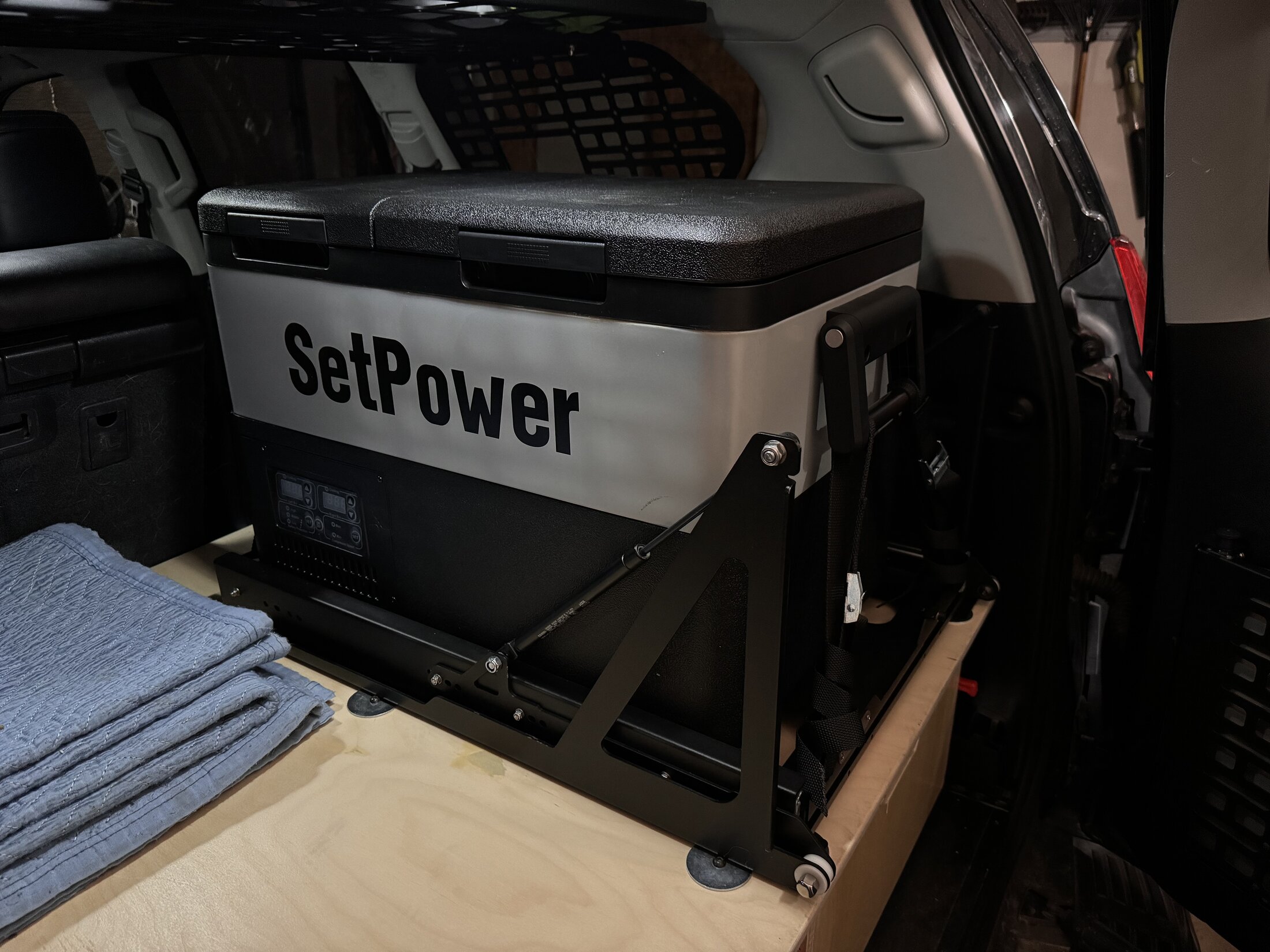

No, sorry. Went with a Bison Gear tilting slide instead.

We love the Bison gear slide. We've got a ton of use out of it in the 8 months we've had it. I'll probably do a video on it at some point. The Bison gear stuff sometimes needs a few tweaks, but overall, I think they're one of the best balances between cost and durability; plus, they're a family business, and the owner is a cool dude. My only complaint about the slide was that it rattled at first until I realized it just needed some rubber bumpers where the tilting part rests on the bolt-down bracket. Not sure why they didin't include as it was an easy $5 fix. You also have to keep an eye on the tilting screws to make sure they don't back out, it might be fixed with a removable thread lock.
