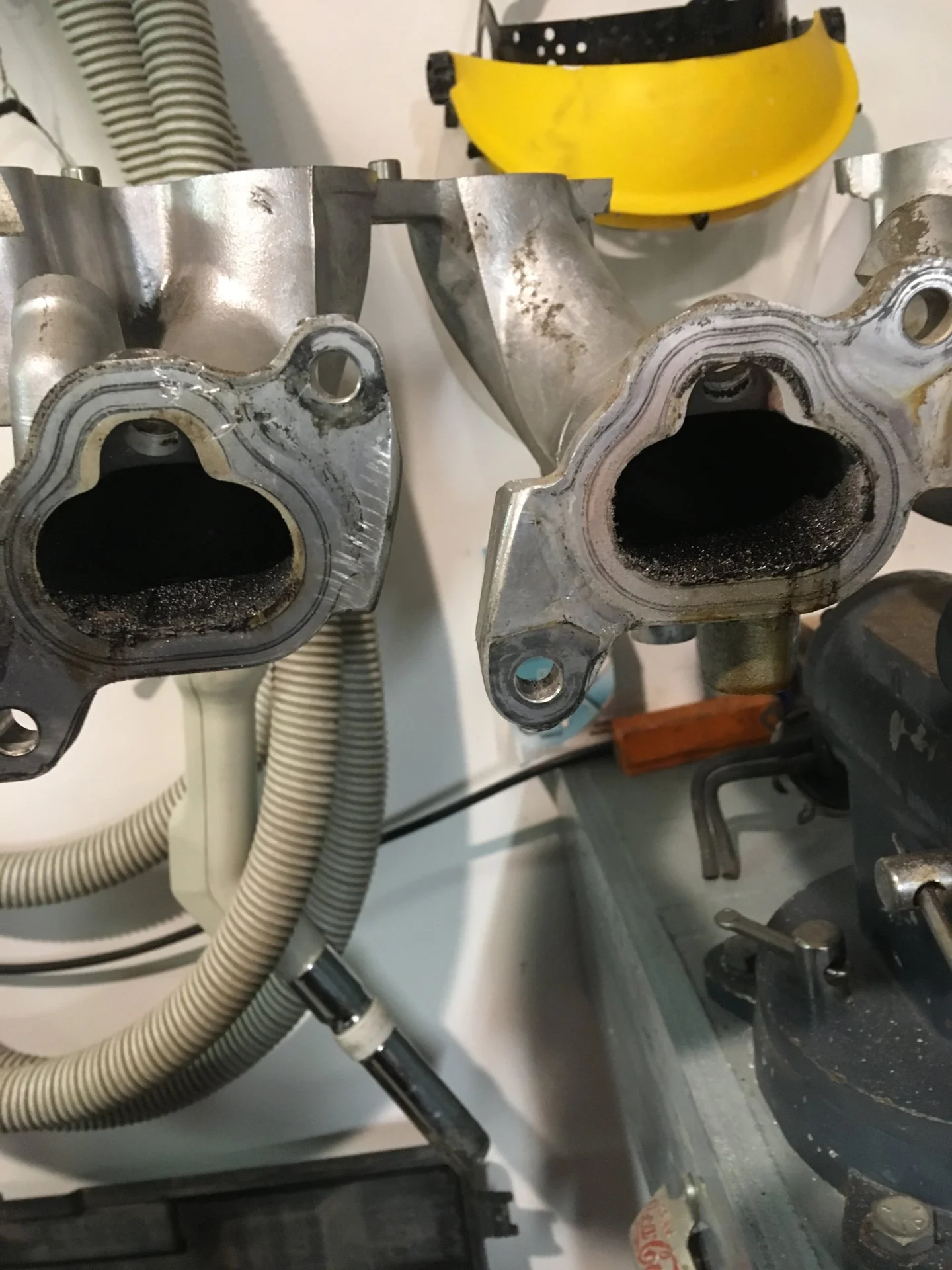

This is a 12,236 mile report. I totally cleaned this TB and both intake manifolds.
Homedepot air compressor oil separator.
Totally cleaned before installing the separator or just now cleaned everything up??
Is that all of the oil captured after 12,000 miles or did you empty the bottle (how frequently)?
How does the inside of the upper intake plenum look on the other side of the butterfly valve ie: after installing the separator?
No!? 282k mile 80? A “before” shot would be nice if you have it.
Totally cleaned before installing the separator or just cleaned everything up??
How does the inside of the upper intake plenum look on the other side of the butterfly valve?
Yes, the intake was removed and completely decarborized 12,000 miles ago. As was the TB.
I empty the separator about every 800 miles, usually about an ounce of oil/condensation.
It’s all back together now, maybe I will pop it off again and open the TB plate to see!
Wow! I have so many questions.
This it the best pic I have of before
That will answer it. Thank you.
That looks suspiciously like the blue one I have in my truck.
I did the same thing - cleaned everything and installed that separator.
But unlike yourself (sounds like), I have to empty it after every trail run where it is about half full after 8hrs or so of runtime.
