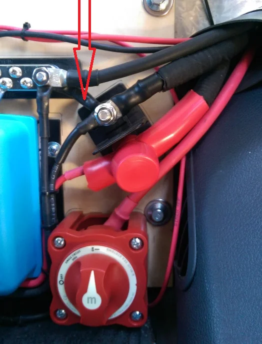

Normally my battery would not be grounded to chassis, however because I am using an isolated DC/DC charger, and I ran some DC loads off of the Blue Sea 5046 using just the positive wire, I had to add a jumper to complete the circuit (basically converting the isolated charger to non-isolated).
Regarding the radios, no issues so far, although I haven't needed to use the main radio in a condition that would generate much heat. Mostly low power chat with others in the group with HTs.
