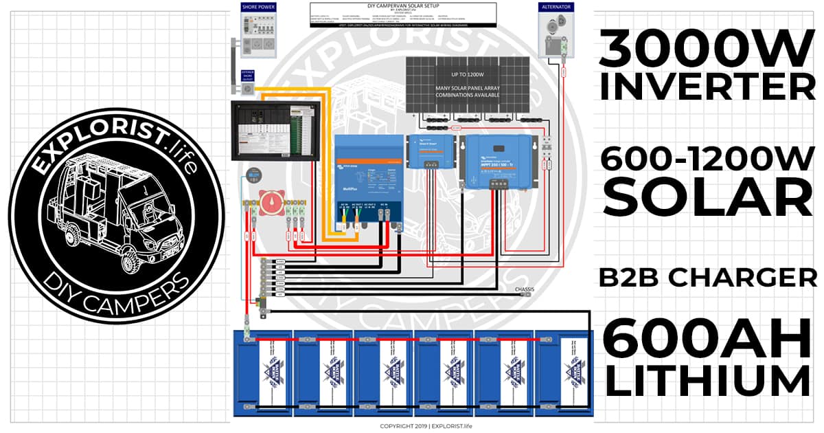

This is one example, but all the diagrams I've seen have the solar and alternator connecting to the same DC bus. The DC-DC charger is to deal with the newer style "smart" alternators, not to prevent "competing charging sources" AFAIK.
I need to get some empirical data around this but I'm certainly not the first to experience the phenomena of having two charge sources somewhat cancel/limit each's ability to supply max charge current to the battery.
Typically and consistently when towing and using the Sterling BB1260 I get larger current flow through when the roof top solar is not connected (Victron MPPT controller) to provide charge current. Likewise, when I have the BB1260 disconnected, again while towing, and using the rooftop solar only the charge gains are bigger than when both charge sources are combined.
