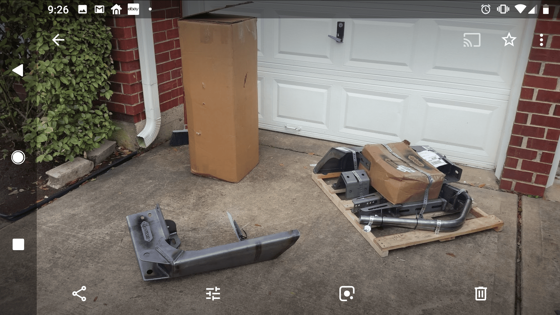

First off UPS sucks and the bumper isn't packaged well so it showed up with a bent tab on the center section that bolts into the frame bolts. I put the frame brackets on and then bolted the center section in, but couldn't get the whole thing back off the frame horns. Then had to unbolt everything, remove the center section on the frame brackets. Then back together again to shim the bumper. Then add the fact that the one winch that this almost 100 page thread said would fit doesn't so it was just A LOT of on and off with the center section with rubber hammers and I messed up my new powder coat pretty good between the center and frame brackets. I had to notch part of the center trim support as well. Then... add in the fact Ben provides zero instructions and the instructions on this thread aren't super current or complete makes the install not ideal. I have one side of the bumper that needs to be shimmed more because last weekend's trip it was making connect with my body and the thought of going through that again sucks.
All that said the bumper itself is amazing quality and I think its the best looking bumper on the market. I just wish for the price point the bumper would have been packaged better (ask Slee for some pointers) and it would have came with ANY f**king instructions. Some of us have young kids/work long hours and don't have time to sort out a bag of hardware to figure out what goes where. I ended up calling Ben 4 times and he answered all 3 of the times and was very helpful, the last time I called about the winch not fitting I left a message and didn't hear back. I really wish I wouldn't have got the "Gen 2" bumper and had an easy install like everyone else on this thread. To end with some praise for Ben, his skid plates are a work of art! My install experience with them was perfect and easy, wish I could say the same about this bumper.

I completely agree and understand that you Maybe my center section was more bent/damage that we thought? It simply didn't fit in the frame brackets well. Once you put the center section in and bolt it to the brackets with the allen bolts you can't get it off the frame horns even with 3 guys pulling on it.
I don't think that's an issue with the damages to your bumper, that's how mine is as well. It's built to go on piece by piece, not as a whole unit like most bumpers.
I tried doing that when i installed the winch, we managed to take it off but i had to remove a wing and frame mount before i could put it back.
Yes, instructions aren't there, but after doing it so many times i figured out that the gold bolts go into the frame and are clear, the the shortest ones go on top where the stinger or plates go, the medium ones go inside the center, and the longest ones go up front on the end caps.
Once you lay them out and do a count, it's pretty easy.
What i did do is replace the bolts with stainless button bolts for a cleaner look. I think Ben used to supply them on the first run of bumpers.
Somehow UPS manages to destroy pallets I kid you not my pallet didn't even make it. It was destroyed/lost during delivery and they just threw all the parts in a box along with a loose piece in the truck. I called Ben and he told me piece by piece that should be accounted for (he has them memorized) lucky everything was there. Ben stood by it even when it wasn't his fault.
Also this was the rear bumper, even with out instructions if you lay all the pieces out in order they make sense on their own. They speak to you if you will. It really does help.
