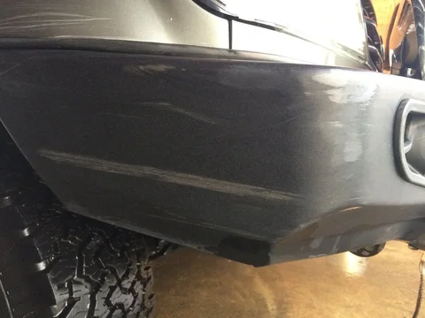

I really like the looks of this bumper and even though I have an ARB sahara have been following this thread, because if I find a grand stashed under the couch I'll happily sell my ARB and buy one of these!
That said, I'd be concerned about the strength of the modular design. The corners of my ARB have rubbed up hard against their fare share of trees, and have taken a few decent hits to trees falling down off a rock or ledge into a tree. I'd be worried that making the bumper modular would reduce the strength?
^This. Strength would be my main concern as well. Was gonna wait and point that out after Ben answered my other two questions, but might as well go ahead now :)
