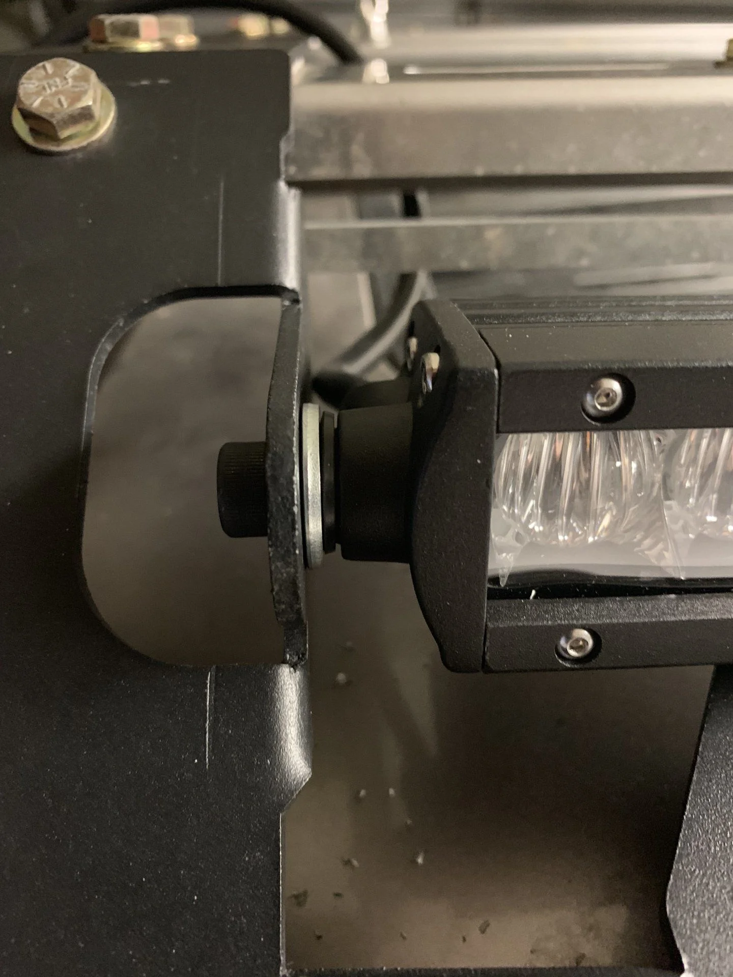

Rigid (and Baja Designs) were more than I wanted or needed to spend at the moment, so I spent a lot of time looking for something that wasn't complete crap. What I ended up with was this: S4D 40 inch Single Row OZ-USA® LED Light bar 4D reflectors spot flood combo off road 4x4 4wd race truck (Bought on Ebay for $110)
Just got it mounted up tonight. I threw a stainless and nylon washer on each side and had to go get some longer m8 bolts to close the small gap and it fits perfectly.
Comes with nice weatherproof wiring connectors. Shipped with a 30amp fuse. I cut it out and wired to my blue sea block; runs fine on a 7.5 amp fuse (it blew the 5 amp). Which I'd recommend since the wire isn't very thick.
I got this primarily for camping and setting up in the dark, I'm counting on it not being a great driving light but once I get some time with it maybe I'll come back and provide an update.
