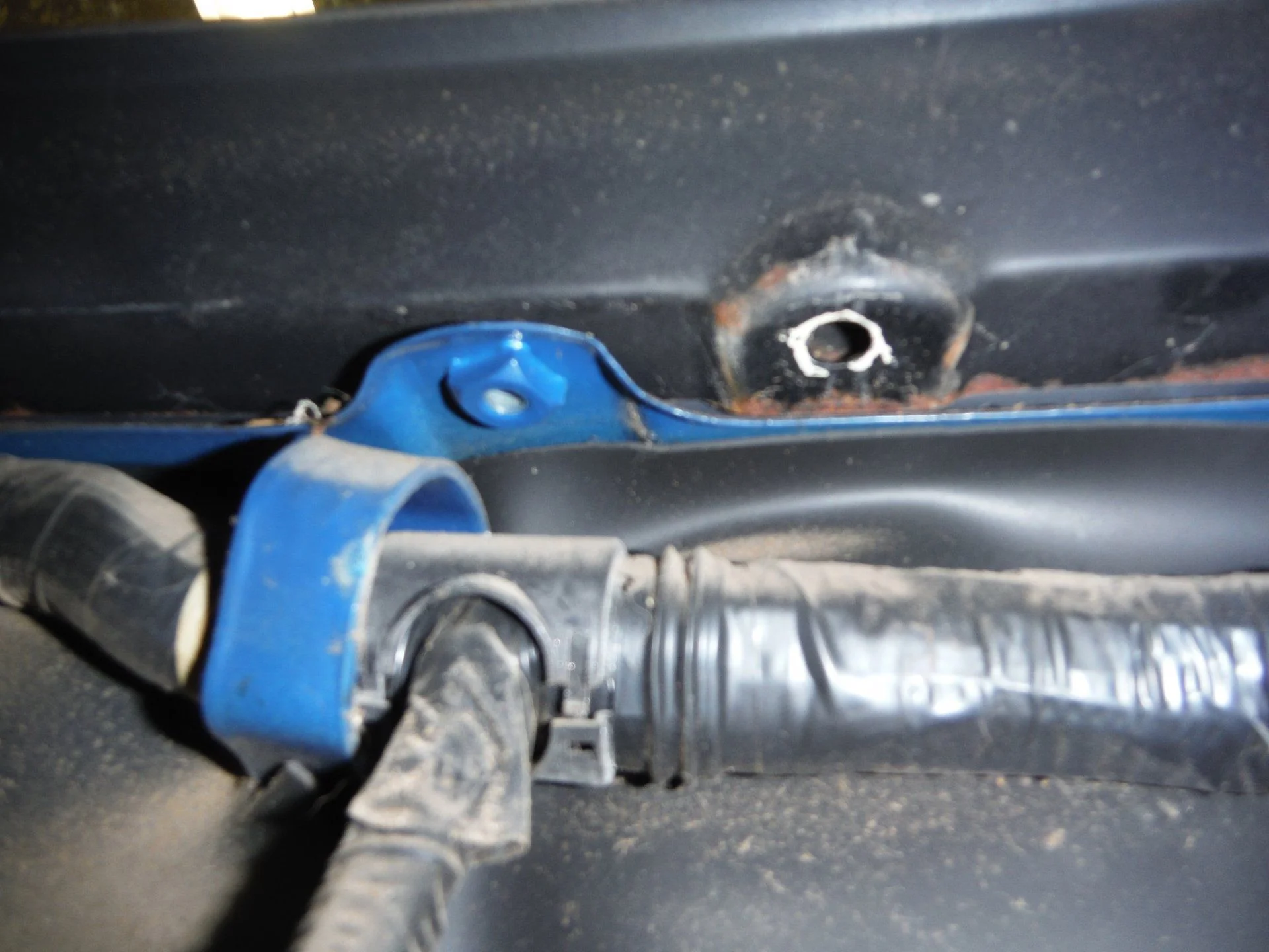

Look under the dash, there is a little spring catch, it's the thing that makes the clicky sound when you pull the handle. Push on it and push the handle towards the firewall, it will go past its normal stopping point when you release the brake, but only about 1/2" or so. That's enough to get the cable end to be able to be pulled out of the handle, on the engine side.

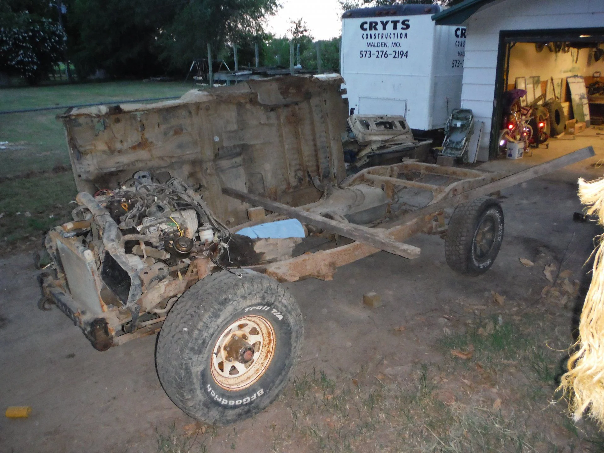

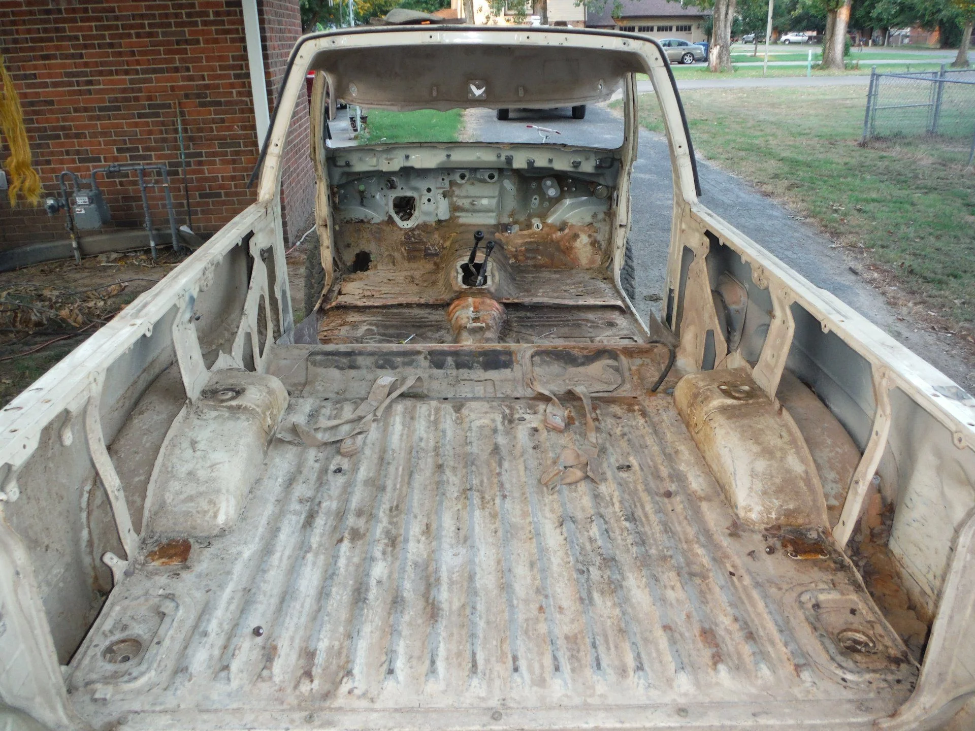

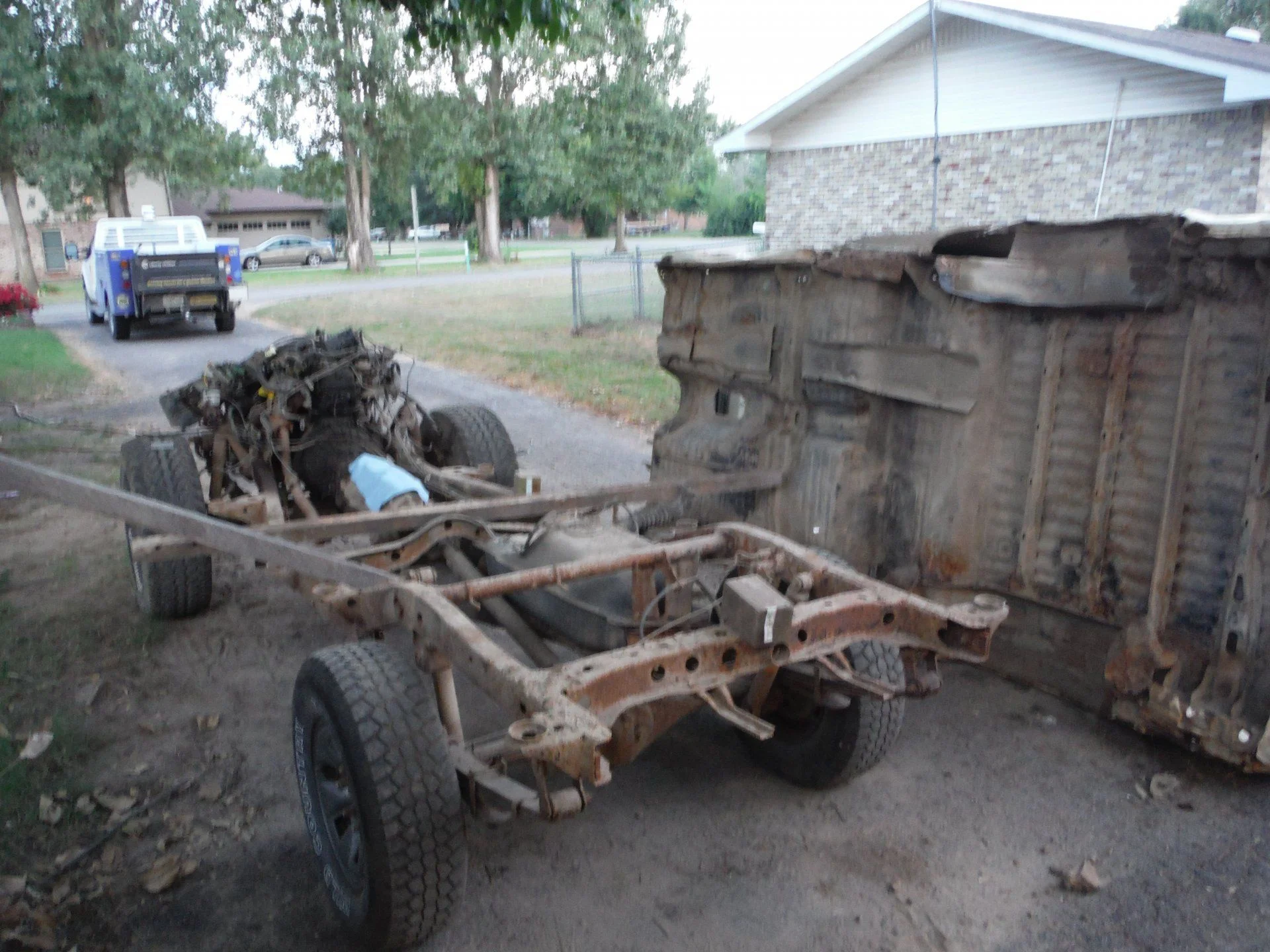

worked like a charm KLF! I got all the body mounts pulled last night.... they all came out with out a problem the bolts all still had the zinc coating on them but the bushings were shot. I'm surprised how every thing on this runner come off easy it could not have been used off-road very long at all but with 313,000 miles on it I sure suspected a lot more trouble with taking stuff off.

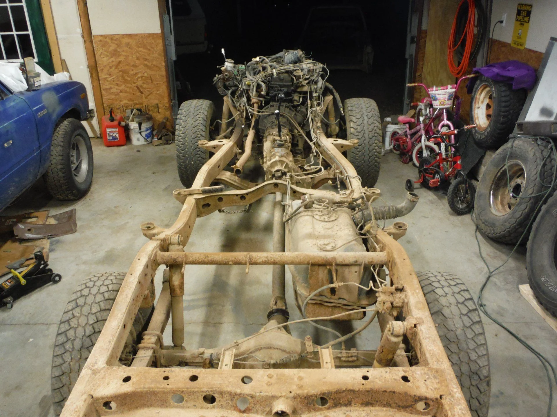

worked about 2 hours last night and got a lot done.

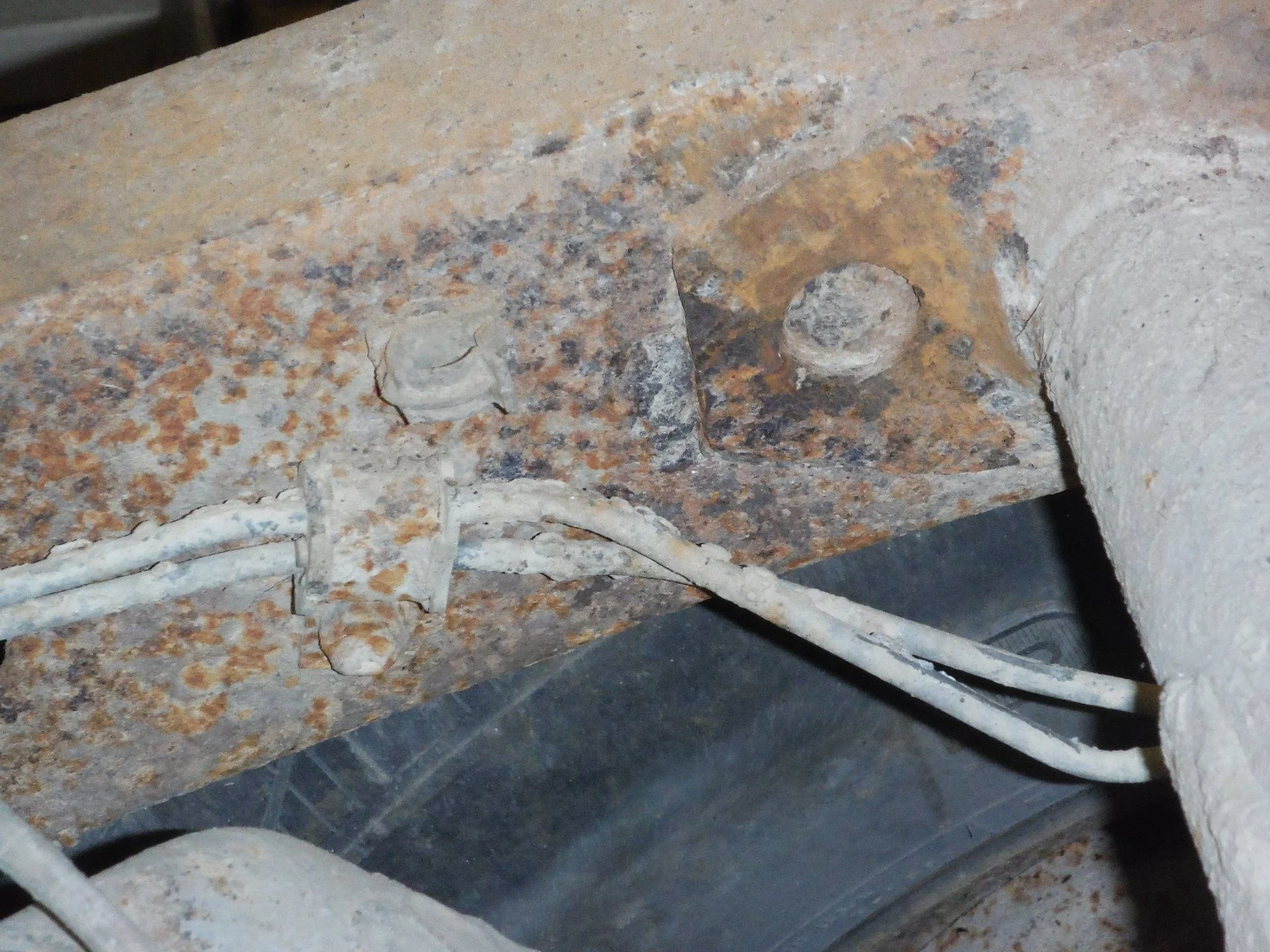

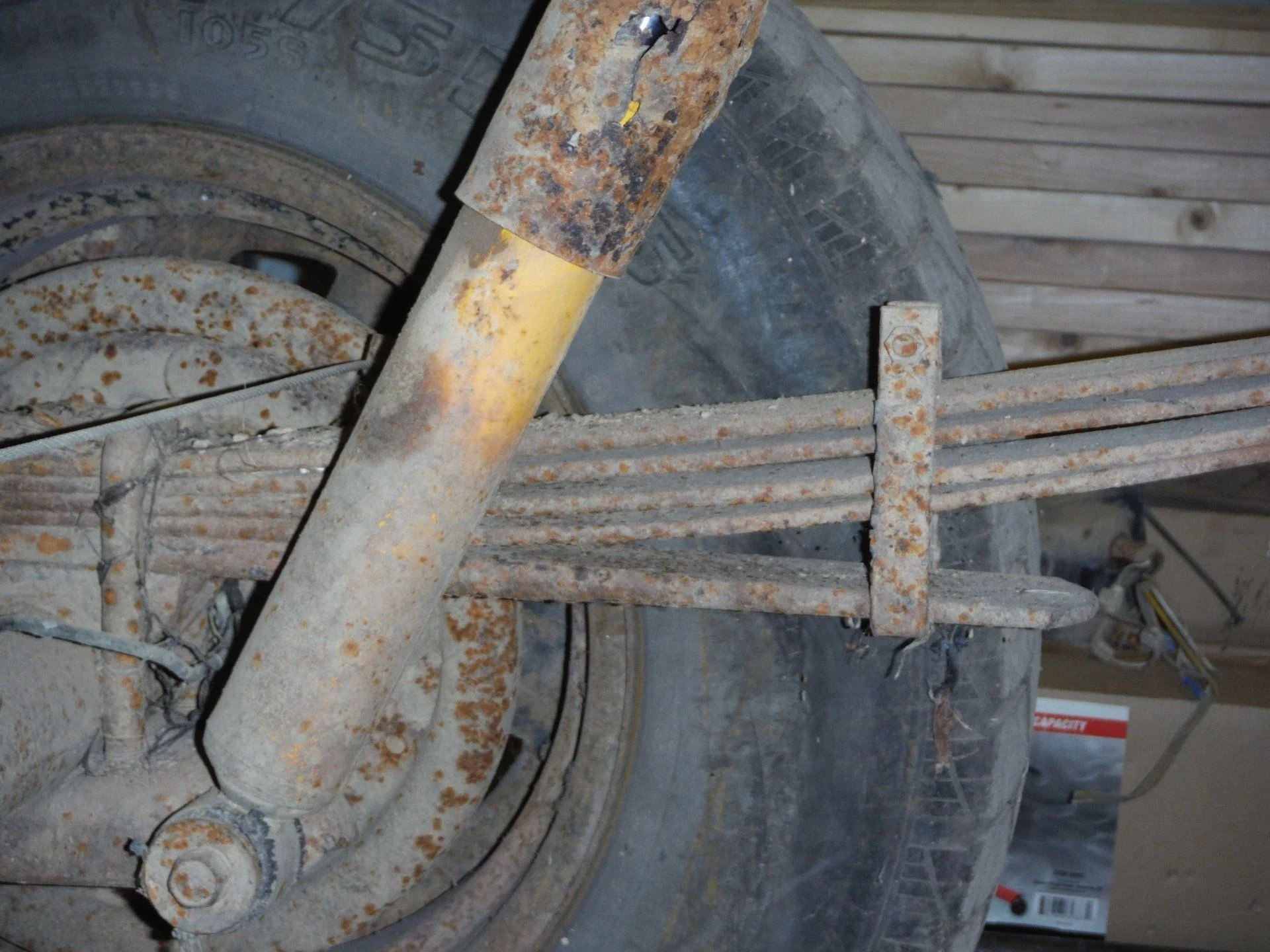

suspension is kind of messed up add a leafs in rear that are cutting into the leaf above them rear shackles are bent crooked, the front actually looks alright it even has factory markings still on them and are not too negatively arched.
