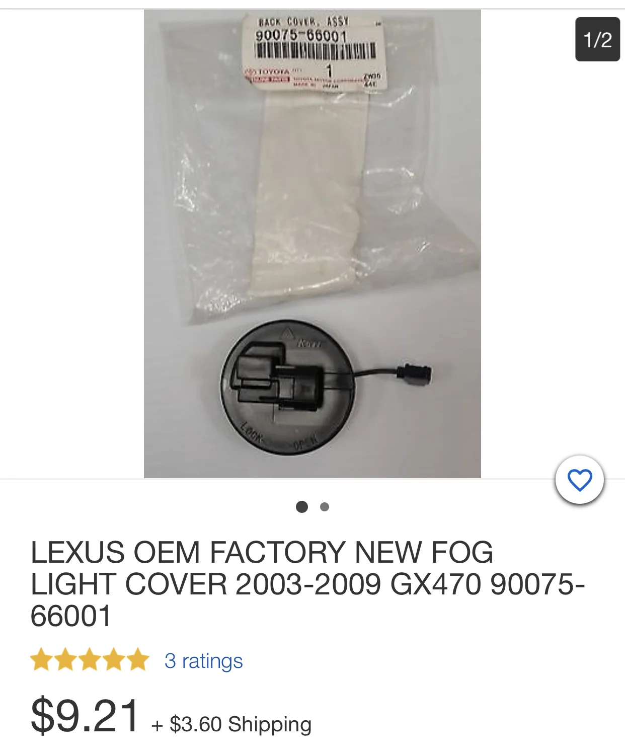

I know this post is a little old, but I'm looking to do something similar to this on my GX. How did you wire the pods to your factory wiring? Did you use a Deutsch plug from the pod and cut the factory plug off and splice the Deutsch adapter to the factory wires? Or did you use some sort of adapter with both ends on them already. I know Deutsch adapters exist out there somewhere but I can't figure out what size the male end of the factory fog light harness is to match them up.
I personally don’t like cutting the factory wires. I ordered another connector like the end that was on my old fog light and connected it to the pods. This way it’s plug and play to original wiring on vehicle
Do you know what size that plug is? The bulb is an H3 but that goes inside the housing. The plug on the outside of the housing is what you matched up, correct?
Yes correct, the plug on outside of housing. You can get something like this and then cut the end you don’t need to connect your pod.
