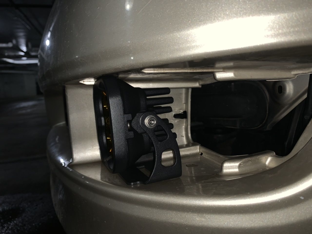

I thought about the DD SS3s, but couldn't find a definite measurement on overall height including the mounting bracket. I already had the Rigid SAE Selective Yellow lights on order so I went ahead and installed those. The room inside the OEM fog location is tight.

I suppose I'll be guinea pigging this, then. The Baja Designs are 3.3" tall with bracket, the Rigids appear to be about 3.5" with the bracket, and I think the DD SS3 cubes are about 3.6 or 3.7" (based on the CAD of the bracket on the DD website). I might need to get a little creative if space gets tight.
My squadron bracket are below the opening. I think it would be really hard to fit with the bracket in down position. You could easily make extension to hold the bracket behind the fog light surround.

It's a tight location to work with and there are ridges in the plastic that don't help with mounting. You just drill a hole in the plastic bumper wherever you want to mount the light, but make sure you have room to adjust before you drill.
The lights sit slightly unlevel so I "shimmed" one side of the mounting bracket with tape. With larger lights you can probably mount it closer to the outside edge of the bumper.

You may be able to mount the SS3 pods closer to the outside edge of the bumper for better clearance. I tucked my Rigids in because I like the way it looked better.

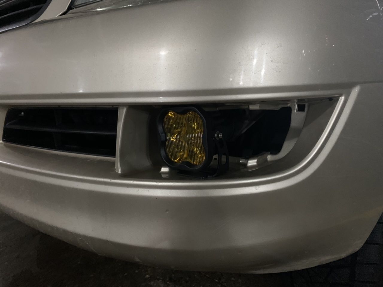

Reporting back:
With the brackets, the DD SS3 pods measure 3.75” tall and 3.3” wide. They do *just* fit after removing the fog housing. They will not fit in the housing, as some people have done.
Two will fit side-by-side with an overlap in the bezel.
I installed these last night (one on each side, so far) and will include a more complete install thread, but it’s pretty simple to remove the assembly housing and drop these in. The SS3 use a Deutsch connector. You can get an H11 (the GX plug) to Deutsch adapter for $10-15. If you plan to make this reversible or don’t like wiring work, that’d be a great option. I cut the H11 plug off the GX wires, took the included DD pigtails, and crimped on butt connectors.
As shown in the photo, go green to red, black-and-white to black. I then heat-shrinked (shrunk?) the connection to protect it.
These are wicked bright. I’ve also fuse-tapped the fogs, so I can turn these on without my low beams, and I could comfortably drive 30 mph in a snow storm last night with only these.

Looks good! I suppose if you needed more clearance to aim them higher you could oversize or elongate the adjustment holes on the mounting bracket just enough to allow the pod to sit lower.
I actually thought about that, but they fit level and aim well. Also, the website has old pictures, I guess, because the brackets now come powdercoated black in the same texture as the pods. Pretty nice, actually, and I didn’t want to grind them if I didn’t have to.
Reporting back:

Further reporting: Here you can see road illumination using only the fogs on my drive home last night. They basically have the range of low beams, but are much wider (and these are yellow, obviously). It's a pretty solid option for bad weather driving.
(Note: I've since aimed the driver's side down a bit more. No one flashed their brights at me, I just feel like they throw a lot of light and want to be courteous.)
