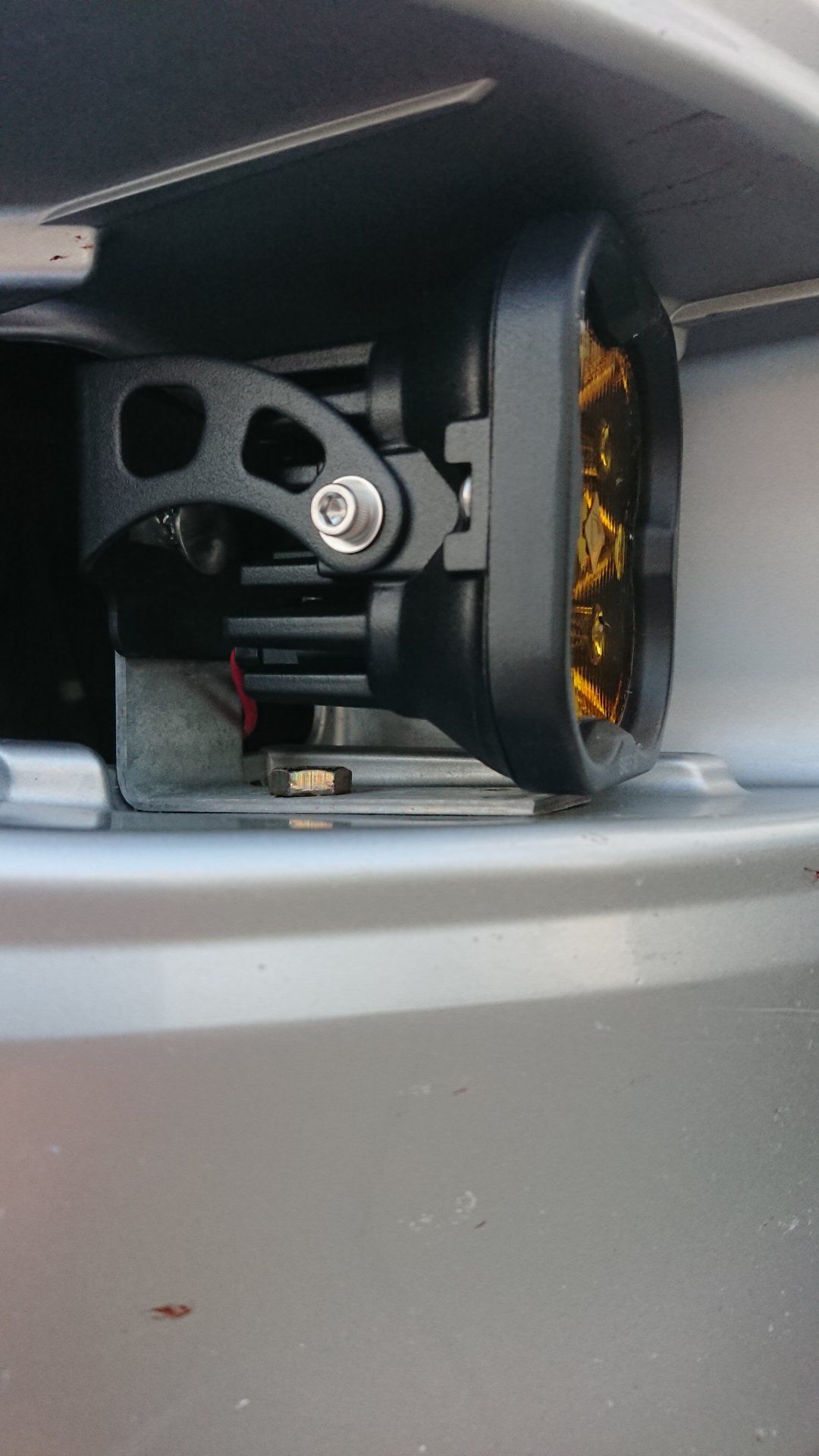

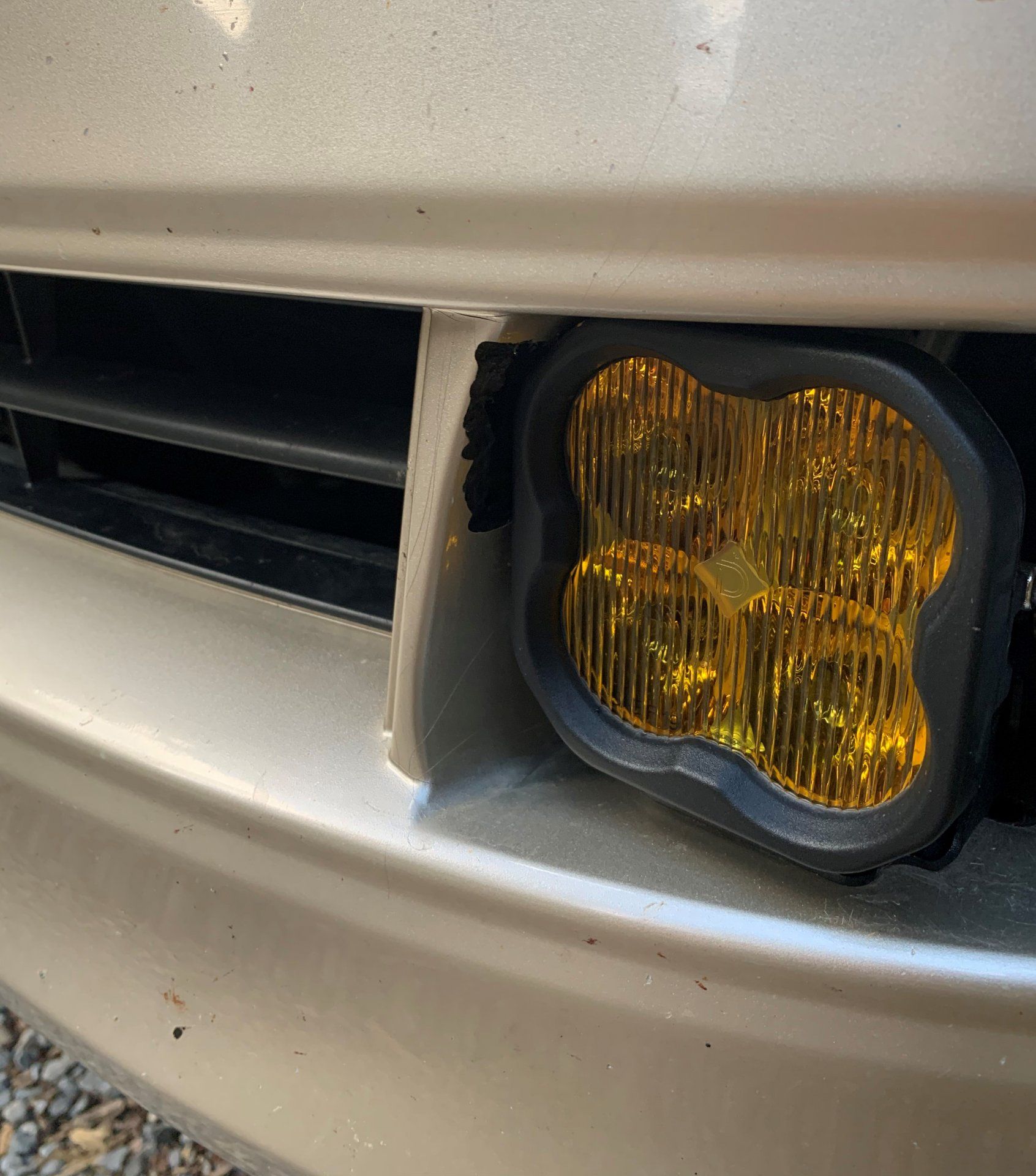

I wanted to update here: I have installed two pairs of DD SS3 Pods in the fog location. The performance is great. The fitment was tricky.
I have yellow SS3 Pro fog lamps inboard (and slightly forward) of white SS3 Pro driving lamps outboard in the sets. Fitting one set was easy. Fitting two sets took some cutting and shimming to get clearance and (relatively) level the lights. I have the fogs on the stock fog switch, and the driving lights are tapped into the high beam wires, so they come on with the high beams. Since I have switched my high beams to LEDs, also, the total draw of both the high beams and the SS3 Pros is about the same current draw as halogen lamps. The stock circuit and fuse work fine.
You could definitely do a better job than me, but this was a "get it done before the kid wakes up from her nap" job for me. Also, I plan to go with a new bumper eventually, so this isn't a permanent solution, anyway (famous last words, I know).
I set the driving lights back and tucked them behind the bezel of the fog lamps to get them to fit. The aiming is fine and I have great light coming out of them. I use them aimed at the edges of the road to illuminate animals on the sides of the roads and widen my viewing while driving. You can see the light comparison between the high beams and the Diode Dynamics SS3 Pros below:
