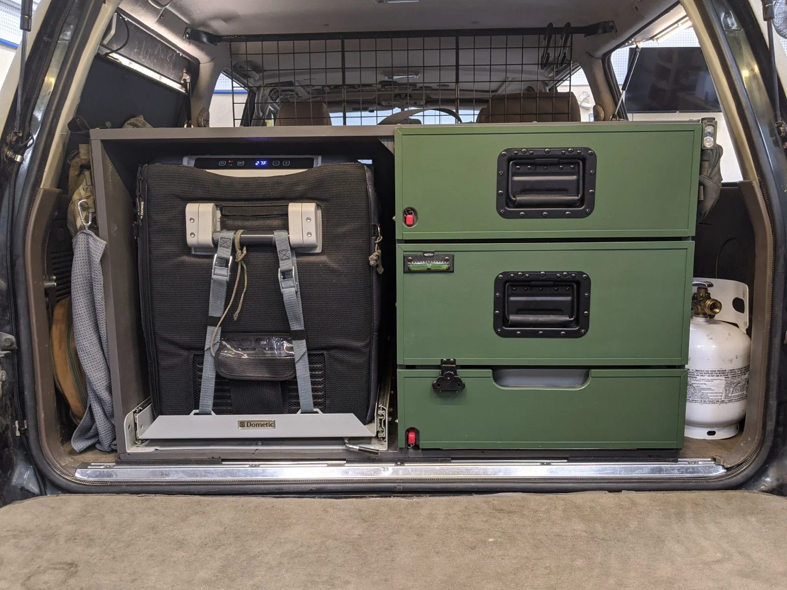

Finished the cargo shelf in lieu of the rear seats. I used boat table brackets to mount the platform to the cargo box and fabricated a bracket to mount to the seat mount points in front. I installed a Pioneer Plastics (Front Runner) 15 gal water tank underneath and ran the hose to the rear by the kitchen. I mounted a schrader valve on the tank cap to pressurize the water system.

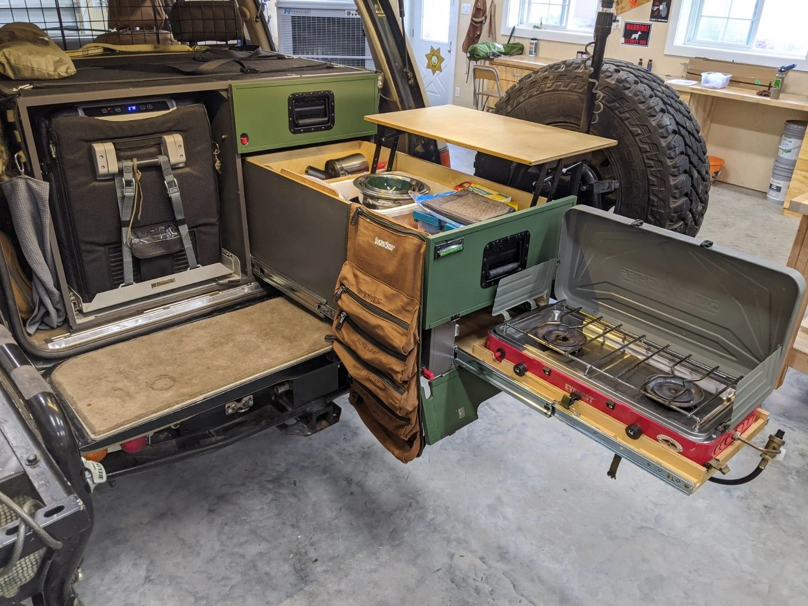

Got details on your cutlery/ utensils pouch?
Kitchen set up looks cool. Some simple creative solutions there
Thanks. Kitchen has evolved over several years and I really like the stove drawer and moving shelf.
Utensil pouch is from bucket boss. I used two screws inside the kitchen box to hang it on when in use.

Man, a lot of good stuff here. I really like the updates. A question for you (and anyone else that is watching without derailing the thread too much); has anyone placed a fridge/freezer in the back seat area? (see post #21 above). I feel like a small platform bolted to the forward rear seat mounts too "flush up" the floor would allow a medium sized unit to sit between the back of the drivers seat and where you have you water tank. I guess the caveat would be the rear door geometry, as the door would likely need to swing open to a true 90 degrees to use any sort of fridge slide right there.
A medium sized fridge could mount on the platform I've got and slide out the door (so about 12" off the upper level where the rear seats mount. Any lower and you are fighting the door.
I know Wagon Gear makes them, but they are expensive-about $1900. I built mine for under $250 if I recall.
