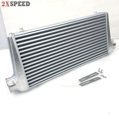

Alright guys , resurrecting old topics yet again, if anyone is willing I would love to see some pictures as to how y’all setup and routed intercoolers for their 4Bts or 6BTs… I’m currently trying to piece together a setup and am leaning towards the one from CX racing that mounts to the ARB bumper .

If you check my thread out starting here on page 11, you can see how I did my intercooler and how I ended up having the piping ran. Someday I might change it to have the piping ran under the headlight instead of through the wheel wells, but I have had 0 issues with it how it is currently.
