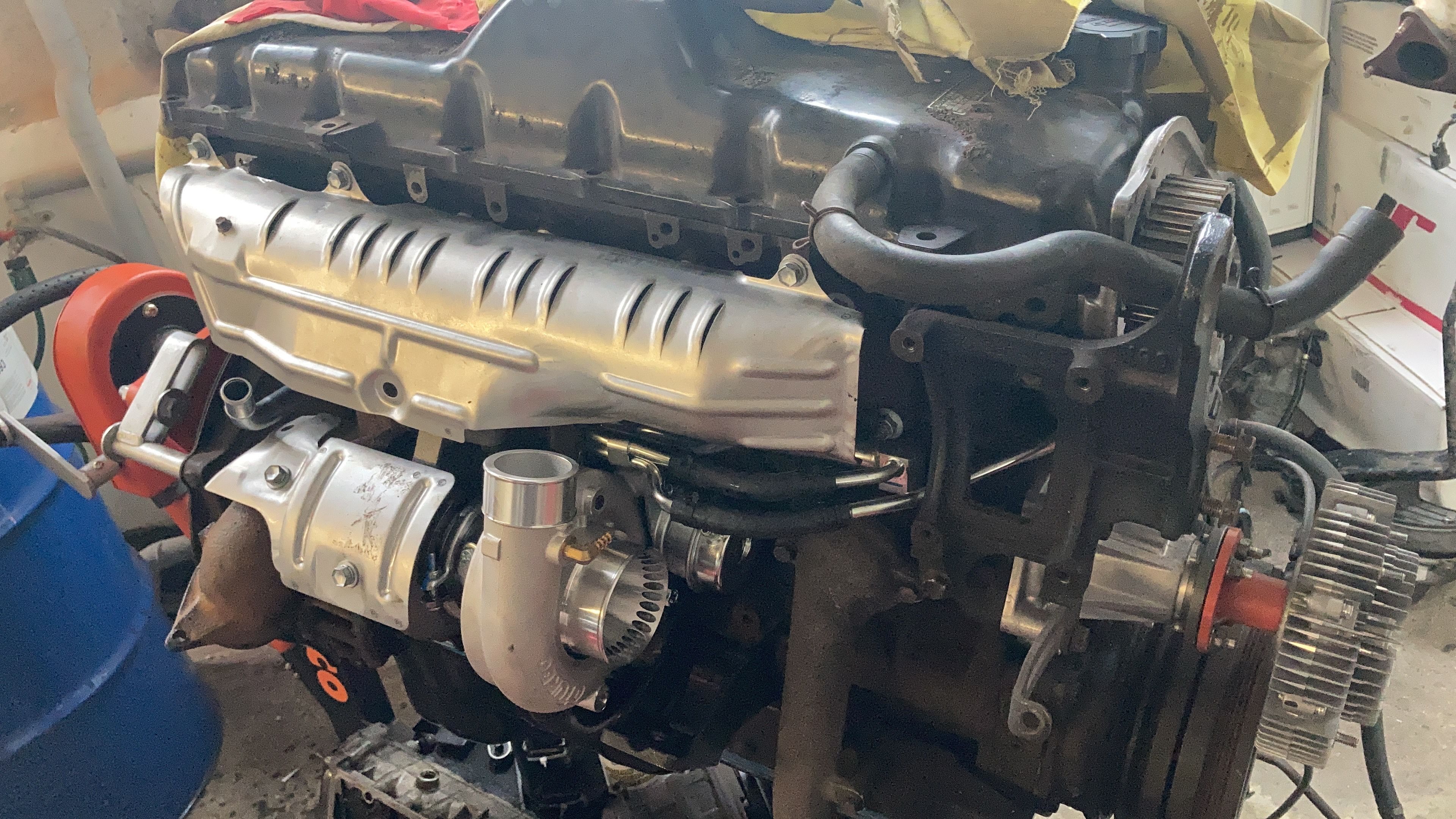

Hi Guys, I swapped to a 1-HDT engine with a manual transmission on my 80 ( Lexus LX 450) 1997. Dave Martin form Back40 imports did an amazing job and everything is working perfect!
Looks great. You will love that rig. I highly recommend installing an intercooler to save the engine. It will reduce the stress considerably. I installed a PPD on my 1HDFT and it made a huge difference.

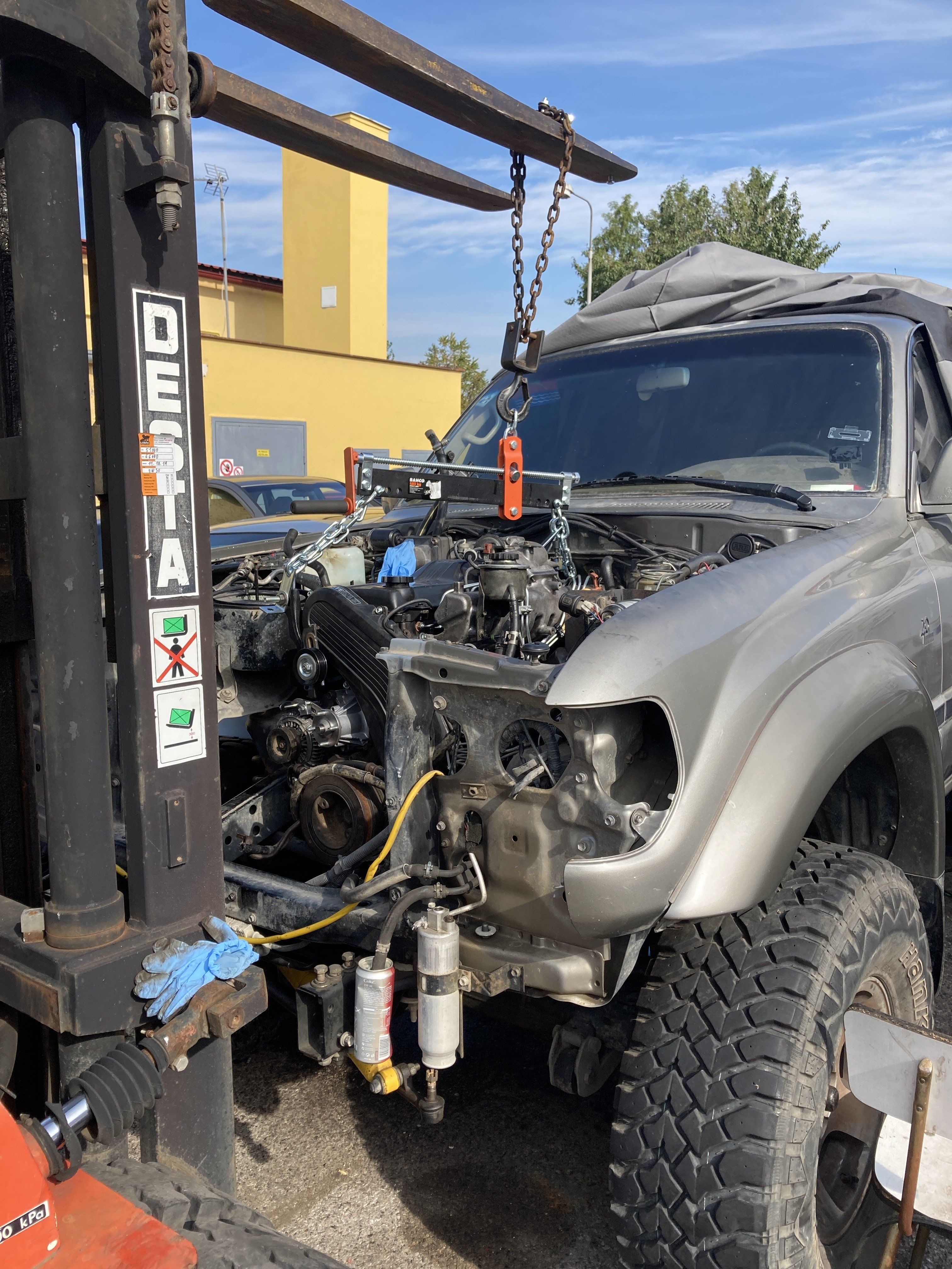

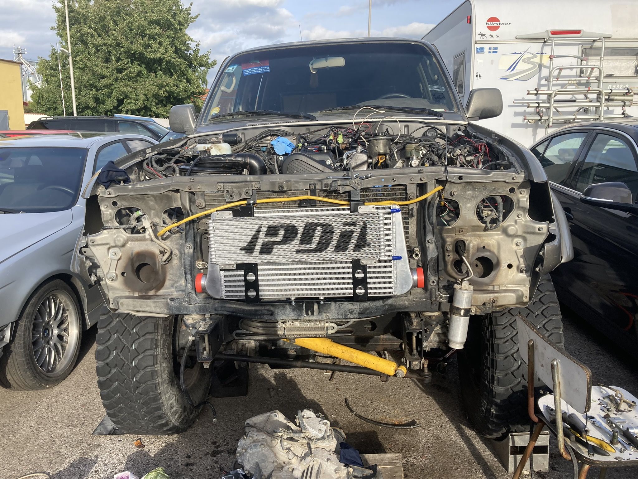

1. Year and model of the original truck.
1997 FZJ80 40th Edition
2. Brief details of the Drivetrain that was swapped in.
1998 1HD-FTE + a442f
3. What went really well with the swap?
As the FZJ80 was automatic the conversion did not need many modifications, all bolted up pretty straightforward.
4. What was unexpectedly difficult with the swap?
The electrics were a big headache, I spent a lot of hours making all work (tacho, speedo, etc. ) but still don't have many things finished (2nd start, OD button, PWR button, etc).
5. Mods...aside from drivetrain, if any?
Gturbo Grunter green wheel, Gturbo tuned DTE module, manta 3'' stainless exhaust, PDI front mount intercooler with the auto cooler, LRA long range tank, new injection pump and new injectors
6. Driving impressions after the swap...including drivability in daily driving (if applicable), highway travel, and, of course, off pavement.
Completely different car, low-end torque is great
7. Realistic fuel consumption after the swap...lol. :D
Did not measure yet
8. Five star rating for overall difficulty of the swap: *=relatively easy, *****=don't even attempt it unless you have some real good friends who are really handy.
I did most of the work myself, I have never attempted anything similar to this before. The biggest achievement prior to the conversion was the head gasket job on 1FZ. The conversion took me about a year to finish as I was working very slowly. I would give this conversion 4 stars.
The biggest issue was the wiring which was done in Australia, unfortunately, it was far from being ideal and I spent a lot of hours making basic things working. Now at least I have pretty good knowledge of the electrical on the 1HD-FTE. The fuel system was also a headache, mounting the HDJ80 fuel lines and fabricating the mounts for them, putting the LRA extended main tank was also pain. The rear propeller shaft had to be extended as the transfer box is without the viscous coupler thus it is shorter. The cross-member had to be modified to suit the a442f bushings which were different from the a343 before.
