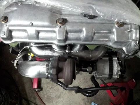

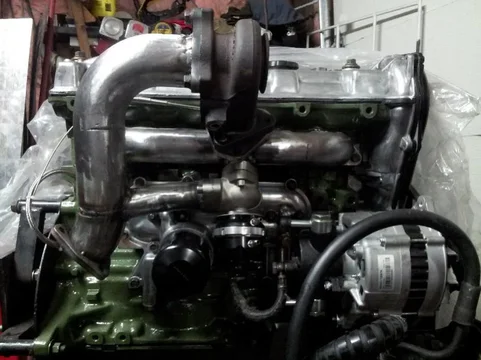

So for finishing of the manifold, on the last one I did ceramic coating. Cost me over $150 and lasted a year and then started to rust. This time I'm leaning towards VHT high heat paint (it costs around $25 for primer and paint and likely will last about as long on a good day)...unless someone has a better solution...that also can be accomplished in a reasonable time frame. I've dealt with a guy on a side job that does chrome... It would likely cost me around $75-100 for all the pieces, other ideas?
My battery was dying so I didn't get any final mock up photos, but this is it (other than a couple brackets)

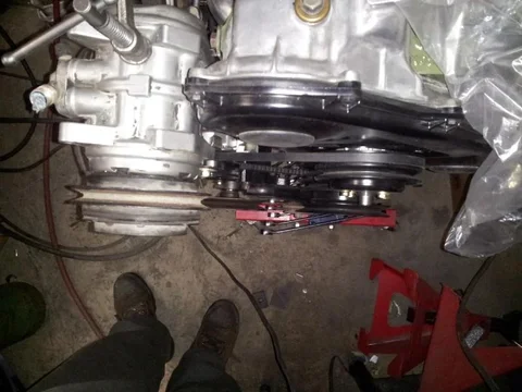

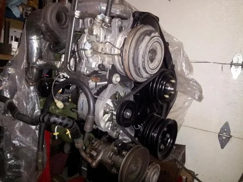

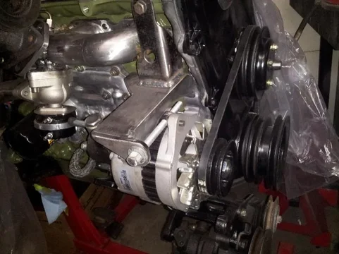

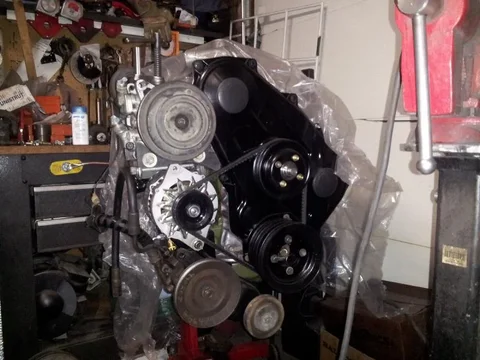

After some personal debates I decided to go with on board air in the form of an A/C compressor.

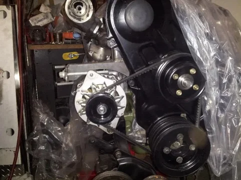

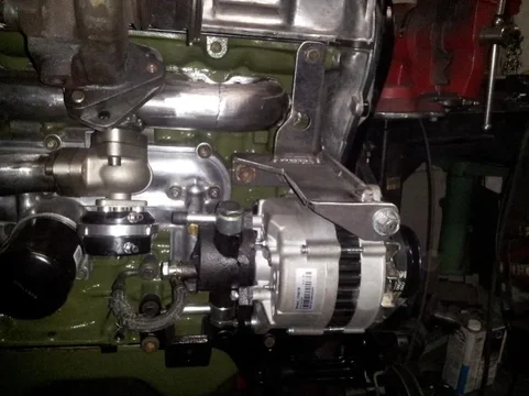

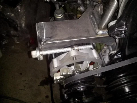

I needed to build a new tensioner bracket for the alternator anyway since I upgraded to the NPR alternator and the factory one wouldn't work.
So I built a heavy duty bench that the A/C pump can rest on.
This will be very tight, especially since the turbo inlet is right there. The A/C pump will be fixed and originally I was going to run it off the alternator/water pump and use the alternator as the tensioner but my friend David made a good point of reminding me how cheap the bearings are water pumps. So the A/C pump will be fixed and going off the crank/power steering setup instead.
The tensioner for the alternator
Tomorrow I'll be mounting and modifying the pump and other than modifying the turbo housing, I think that is it for fab work on this engine.

Just doing finish welding and clean up on the alternator/AC bracket ....which has turned into an entertaining abortion.
Now the only ...currently the only problem I can see that I have are the fittings for the AC pump. They are a special automotive fitting and getting adapters for it is next to impossible even through new line.
So I have 2 options:
1. New line can likely take the existing AC hoses, which I have, and modify them if the hose is compatible.
2. Make new fitting blocks, likely out of aluminum, that replace the current caps with something that has an NPT thread. This will be more time consuming and I don't have my mill in the shop yet so it is do-able but painful.
3. Any suggestions?
Got the bracket finished, no pics since the phone died, but it should do the trick. If I can get the hoses cut and redone with new fittings then I'm good, if I can't it will be more interesting.
