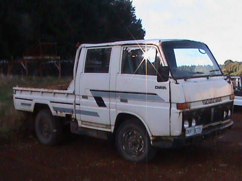

I did the same hill in a Dyna with a new pump and injectors a few years back ,and I think I was in second gear half way up and slowing.
Sorry, not familiar with Dyna's. What engine do they run? Are you comparing 1HZ to 12HT or are you comparing same engine in two different rigs? Either way, I'm certain my 12HT would be struggling on that 7.3% grade.

Sorry ,this old Dyna had a 3B They used to have the same engines as Landcruisers up until 1989 or so.
