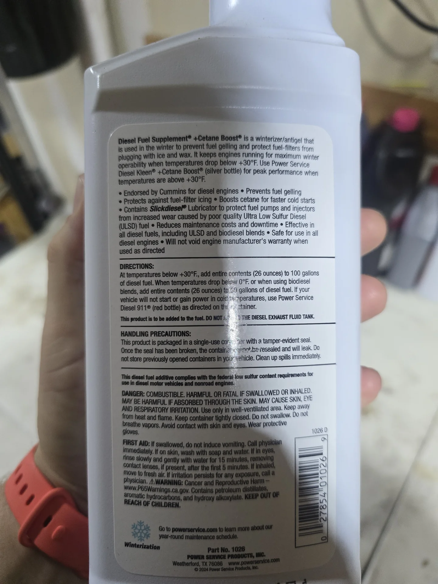

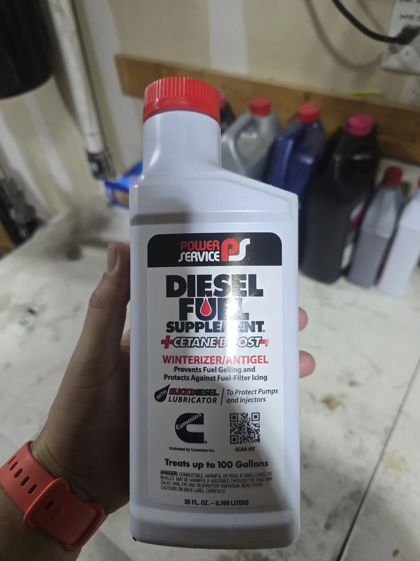

Is the a good additive for a 1HZ, it's what I use in my 6.7 power stroke
Thanks

I use this when it starts to get cold here in Colorado, ive never noticed in difference in mpg or performance. It does make me feel better about preventing the fuel tank from gelling.
you'll get a lot of different answers, id wager most of them are pretty similar. I picked one that I could pick up in any parts store locally.
FYI I add Stanadyne additive. The price point and ease of delivery via amazon is my purchase approach because it is not a common item on the shelves locally.
