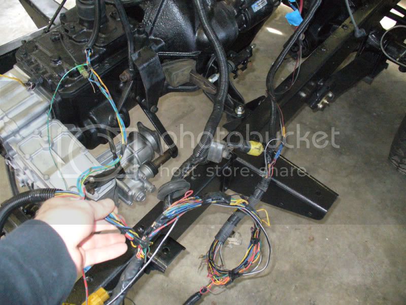

I started with the Cowl harness on the 3FE engine. I had hooked up all the Engine wires and I had to pull apart the Cowl harness to get the Ignition, AFM, Main Relay, open relay.. hmm.. ECU conector and the fuse box wires.. 1 is a small black and blue wire and I have the red and yellow wire also from the fuse box.
At first I started pulling the whole harness apart not knowing where everything was.. I had tagged before which connectors go where but it was still a maze of wires.. once I got a diagram of the wiring it was soooo much easier and actually had fun doing it!.. I have full confidence now that I can do the rest of the wiring!

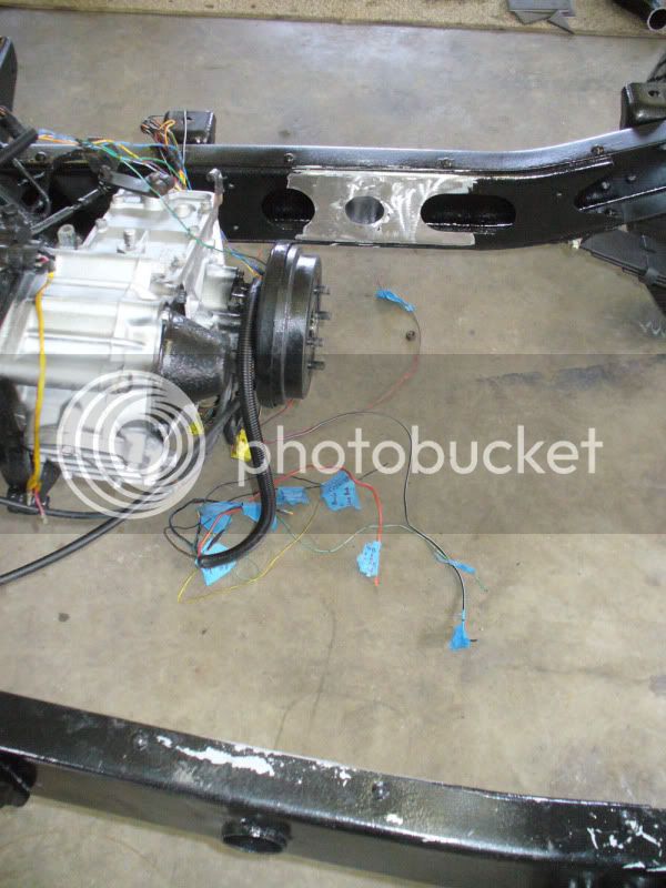

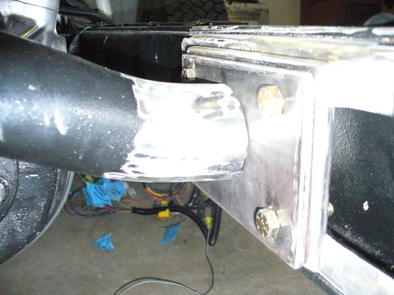

The next thing was the crossmember! I decided I want to fix this the right way!
I decided to cut it out and make it a bolt in crossmember.

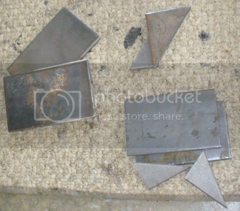

I have cleaned it up flush ready to weld on plates! I bought some steel plates about 4" X6" and then I will weld plates onto the cut out member along with gussets.
I think this way I can position the crossmember exactly where I need it and then bolt it in!! And if I ever need to replace the transmission I can unbolt the member and do what I need..
cut out plates from the steel company ... $16

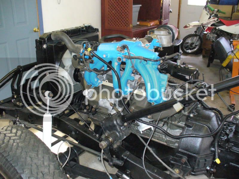

I love the look of my cruiser engine!!!!! I can sit and look at it for 20min..

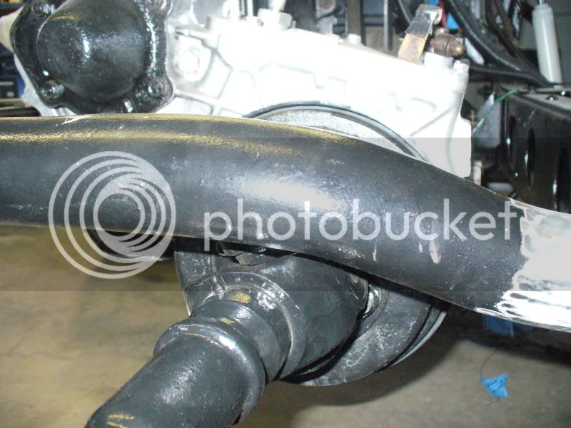

Got the Cross member all mocked up!! just need to get my buddy to bring up his welder.

Clears nicely now!! and If I ever want to pull the transmission all I need to do is unbolt it!

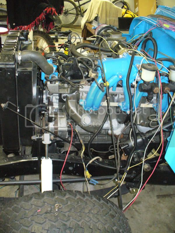

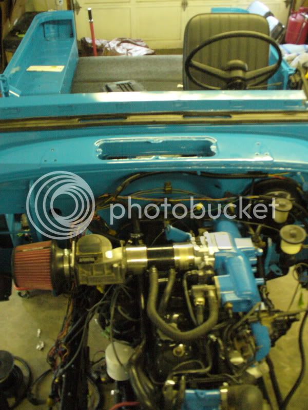

I got the motor installed along with the trans and all that.

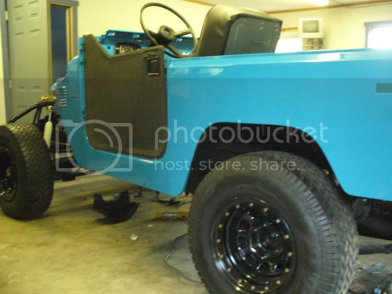

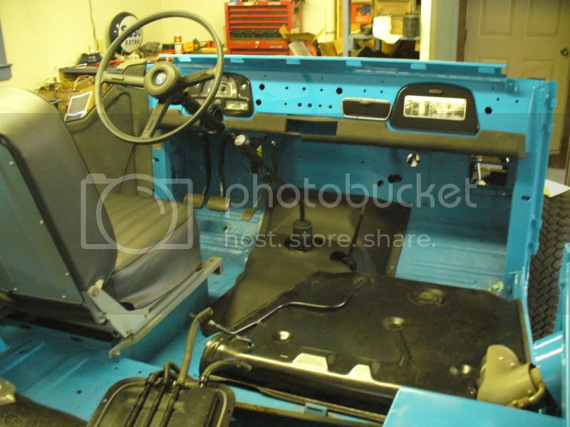

Picked up my tub!! came out awesome! I traded my pimped out XC bike for the body work so pretty happy with the paint!
I have the tub installed and I am now currently putting in the new wiring for the 3FE!

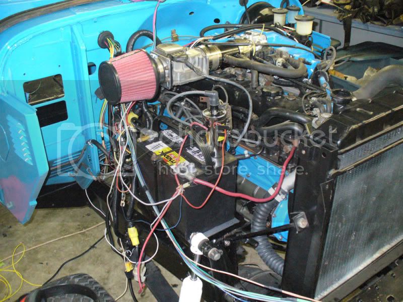

Been wiring up the cruiser now!.. Its been slow going but I will say that if you are doing a 3FE conversion DO NOT do this while putting in new wiring! I have found myself wishing I had just stayed with the old wiring harness.. I would be driving this thing around already! I got the fuel pump hooked up and the motor will turn with the starter but seems that I have a grounding issue somewhere.. I have all the components hooked up to the Negative terminal but still not enough of a spark it seems...
Anyways here is where I am at..
I know the Battery cables are mixed around.. its something I will swap soon enough..

Yeah One thing I would do if I had to do the wiring again was to leave it!!! haha..
I wanted all new things on this truck and in my head this would work out fine.. the cruiser would have worked out better if I had left the original harness in..:whoops:
This is the route I took, just tied in what I needed to the original harness and cleaned up what I didn't ;)
