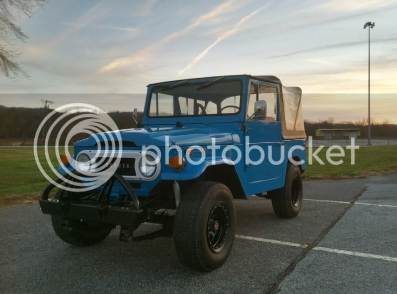

Here is where it is right now.
Its going to be a crazy scary trip driving up North as a First drive. I will make sure to bring plenty of spares and all my tools..
The cruiser is not done by no means but at least its running and driving and I am confident it can drive the 650+ miles. i think I will just take my time up there. take me at least 2 days.
