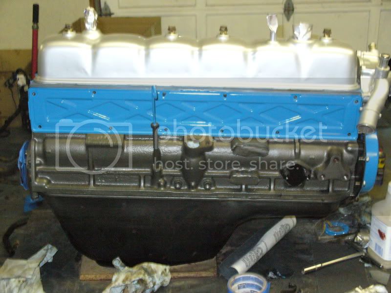

just some update pics on the motor..
Painted the Intake and cleaned up and repainted the emblem.. looking much better!!
I like the blue.. its a nice color.. hopefully not to much.. as long as I can get it done before I got to leave.

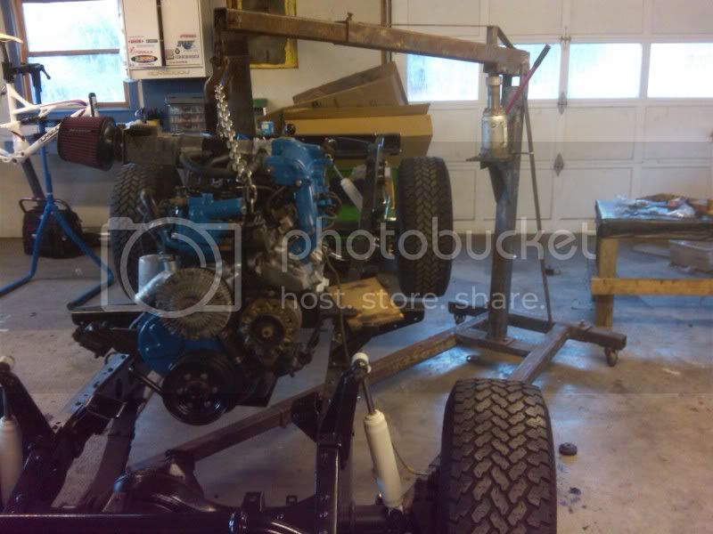

I have been working a bit on the cruiser and the last 3 weeks I have been working on it as much as possible!
I bought a 4 speed transmission and have finished up the motor! just waiting on the tub now which is getting professionally fixed and painted!
I was stoked today when my clutch alignment tool arrived! means I could finally put the transmission back on and mount it all back on the frame! big moments like this is what its all about!
So after lifting the whole motor and tranny up and starting to fit it in I came up with a slight problem... well its pretty bad.
I guess I bought a newer version 4spd from a FJ60 and the transfer is to long??..!
Sooooo... I guess I'm going to go back to my original plan of putting the 3 speed transfer on!.. ergghh... and after thinking about it for so long and deciding on just sticking with the stock setup.
Take a look and let me know what you think would be the best solution? I heard putting the 3 speed transfer will sort it out since it is slightly smaller.. How about the JT Outfitters kit?.. 4 Speed Transmission to 3 Spd Transfer Adapter - JTOutfitters
Would that work?
Pretty stoked on the motor!! looking really good!
All sitting in pretty!! just making sure everything fits on the 3FE.. I have a couple of things to figure out like the motor mounts.. from what I was told the stock 3FE mount on the passenger side had to be replaced with the older one but I don't know?? it looks to me like the stock one would work..
As you can see I had to pull the E brake off to fit it in... :rolleyes:
is there a cheaper way to make this work besides changing the transfer out?
