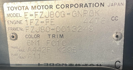

There should be an ID plate in the engine bay rear stating transmission type, paint code etc.
heres one off the net
USA spec trucks don‘t have this ID plate on the fire wall. This info is on the VIN sticker on the driver side door jam. As mentioned VIN search above is your best bet. VIN is on the left driver side dash

Just take a picture of the pan and post it. Usually if it has a small skid plate welded to the pan it’s an A442F and if not it’s a newer A343F
