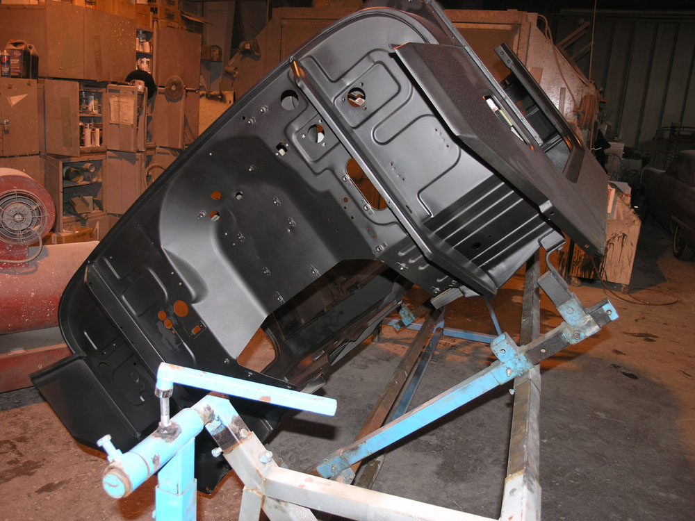

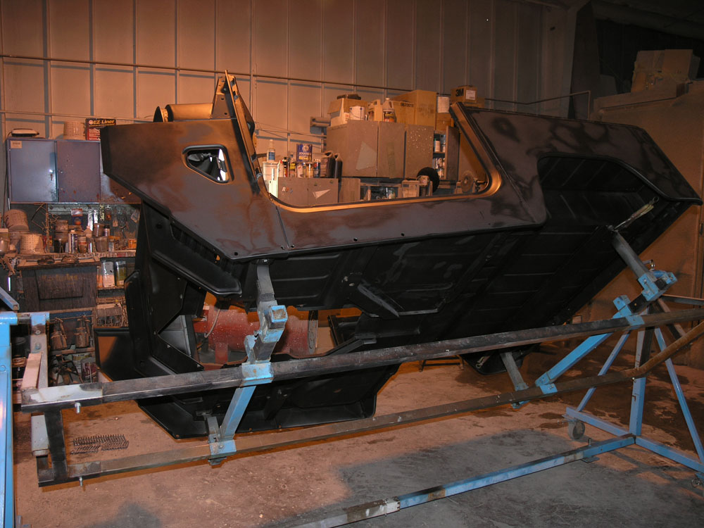

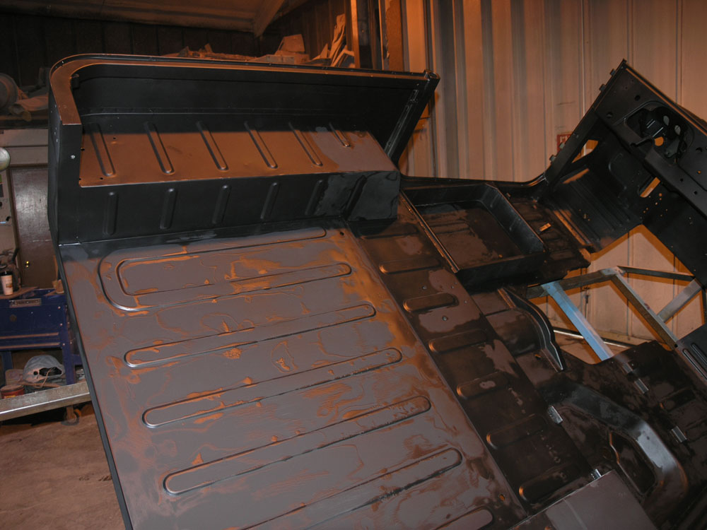

You removed all seam sealer. are you going to geek out and re do it all?
DO NOT use 3M that CCOT sells, as it all cracked and had to be re done on one of my trucks.
SEM is a good one, and another that escapes me.
ok black epoxy sealing primer :D
high build primers are next :D
they put all the seam sealer back in, some industrial stuff :D
Went on before the epoxy sealing primer :D

They sprayed in rust converter into all the nooks after it was sandblasted :D
No spray in foam however.
More concerned that they covered over my damn passenger side footman loop wholes.
Need to drop in tomorrow, fawk i hate when s*** like this happens grrrr
That should not be hard for them to fix right?
damns
damns
Not at all, look on the back side to see if the used filler or welded. Measure twice, then tear into it.
Good eye though
Good eye though
it was there before they skim plastic it.
I ask em tomorrow, they are spraying the high build primers tomorrow.
Maybe they can tap it out before painting.
They are gonna hang and drill the tailgate bolts tomorrow on the new rear sill, along with the license plate light wire harness hole...
Getting closer guys.
