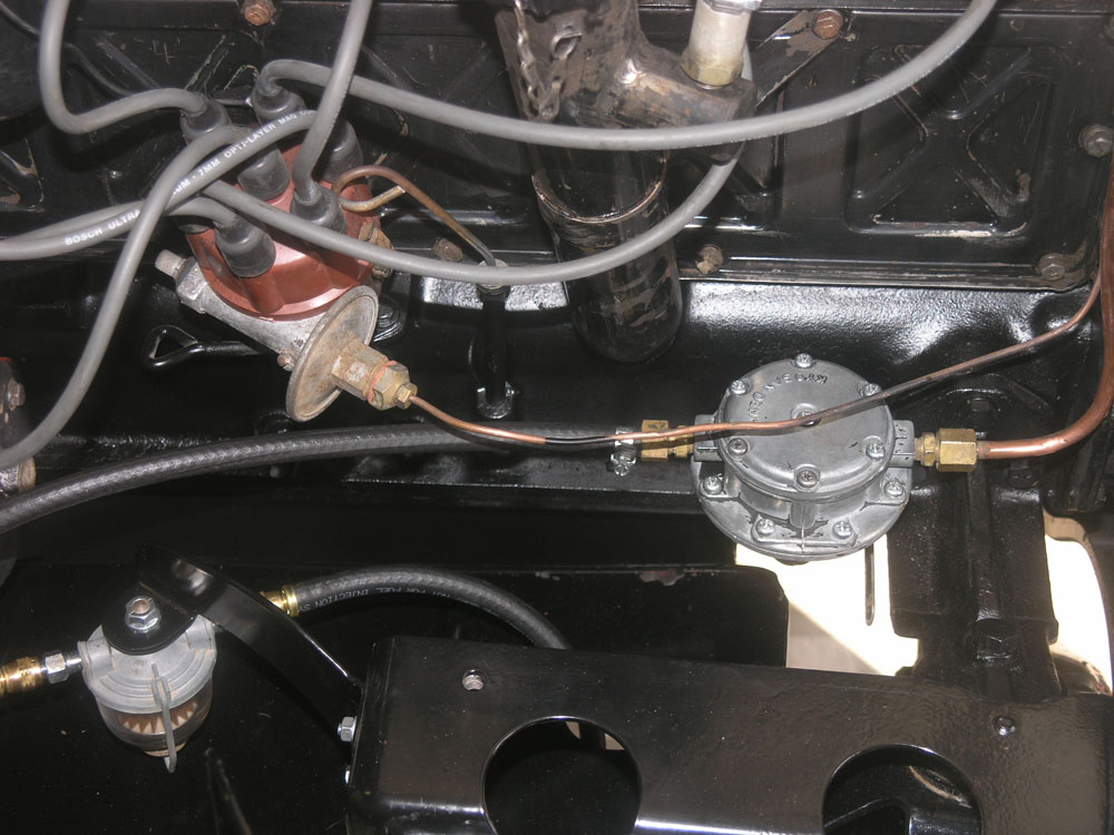

Not so important ;) but original Toyota fuel hoses looked like this
(textile outside)
Original fuel hoses from the tank to the filter and filter to pump were translucent up until sometime up to the seventies. I've substituted yellow Tygon hoses but the O.D. is not as big and it takes some fiddling to make the stock collars work.
It could be your fuel pump ain't original. But that's ok.
I know that the early Cruiser came with translucent hoses, but these look like kit car parts :rolleyes: (terrible !!!! ...would never put them in a rebuild Cruiser)
Textile hoses look vintage ;)
My 1973 came with textile hoses.

Destin,
FYI, on my 63, the original fuel pump (best I could tell) was shaped quite differently and had a wire handle one could use to manually pump the fuel. I guess that was in case of no battery to crank the engine and the crank start was used?? Just a thought.
On the hand crank thing, my crank pulley has ramped tabs to engage a hand crank? It looks not unlike my '46 Ford tractor. Hand cranking a cruiser would be miserable. I guess then you would need a manual fuel pump. You might have to hand crank all day if you had run out of gas.:doh:
Oh well, don't sweat some things too much. Just no Dana axles for originality's sake.:p
The one i am rebuilding has a lever to hand prime the pump :D
Super handy if it has been sitting :)
I think it is the correct fuel pump for the year however.

I may have found some clear line at a boat shop here in town :D
If they can reuse my old connectors i might be good to go

that fuel pump....
Somehow I missed that your fuel pump was with the manual pump lever. Cool. Good luck with the fuel hose set up. If you do get someone to duplicate it let me know. Mine are the translucent ancient ones. They don't leak but I don't trust them either.

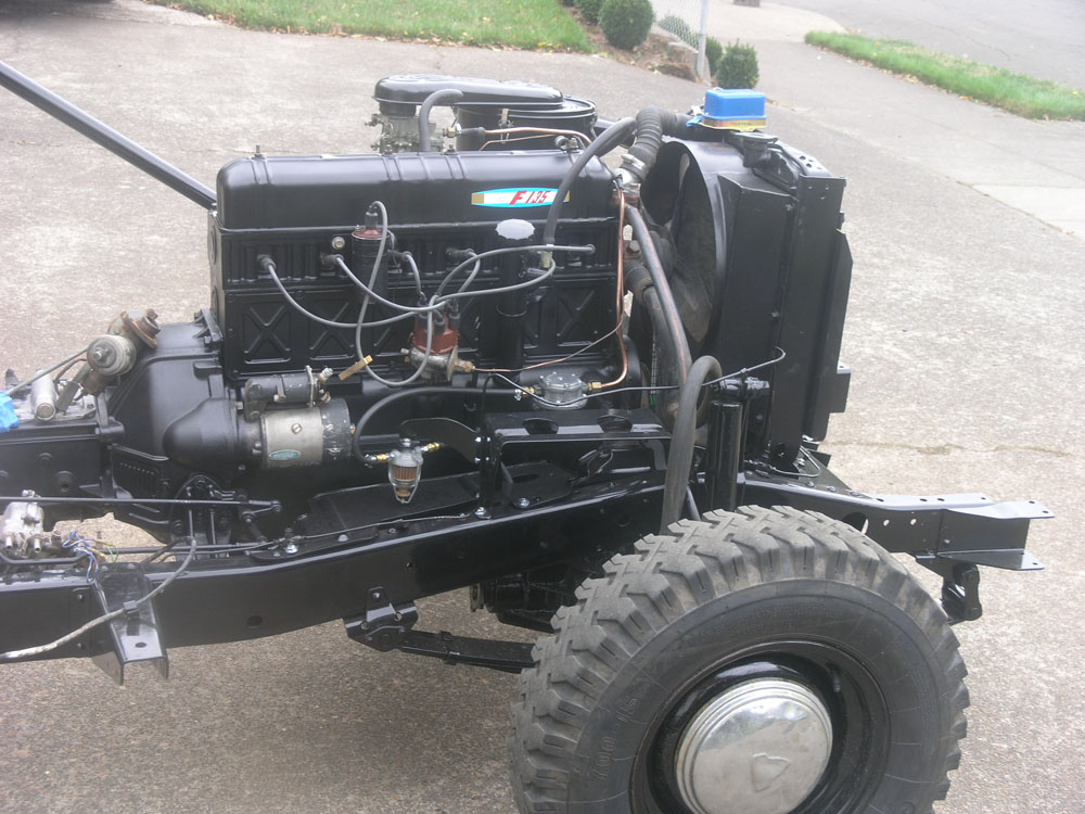

Engine looks good. Did you just clean it up or did you replace your distributor? Did you replace the wires?
Thanks man :)
The cap and wires are new from a tune up when i bought the truck :D
Waiting on the oil canister and the filters now :D
