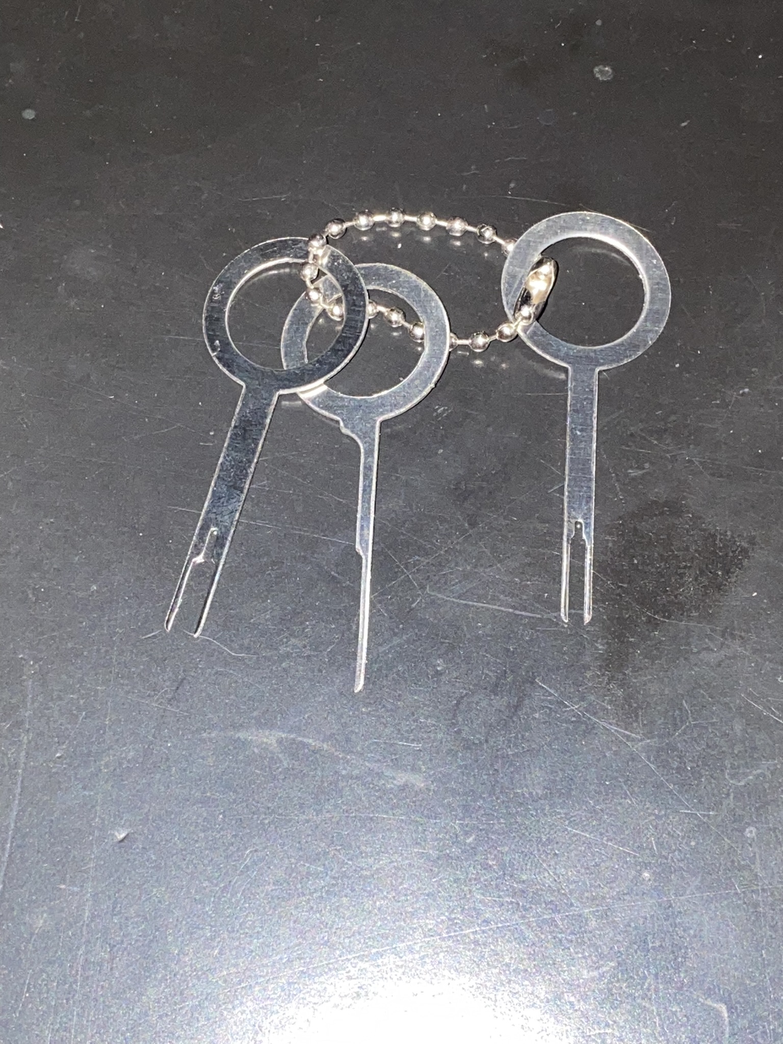

All, I have been searching through the forum but I haven't landed on what seems to be general consensus. I am looking for the depinning tools or set of tools that is applicable to the 100. The amazon kits have dozens and dozens of seemingly unnecessary sizes/shapes etc. Can someone provide some links to their purchase that they felt worked well? Thanks in advance.
From the Wiring Harness Repair Manual, in the Resources section:
If you really want the tool as illustrated above, file a chisel point on a cheap "precision" screwdriver. I've never had to; these work fine.
I've and extra multi kit. PM if you'd like it.
I'm mostly replacing old wire housing blocks, with new OEM. So I just bust old housing block away from wire leads.
Or…you can do it for free. Take an old windshield wiper blade apart. File one end of the metal part just a bit and it’s a perfect fit. Works every time.
I wanted to thank everyone for their responses. For the time being I will try the small screwdriver method, modified or not, as I have collected a few sets of those over the years and don't have much to lose.
