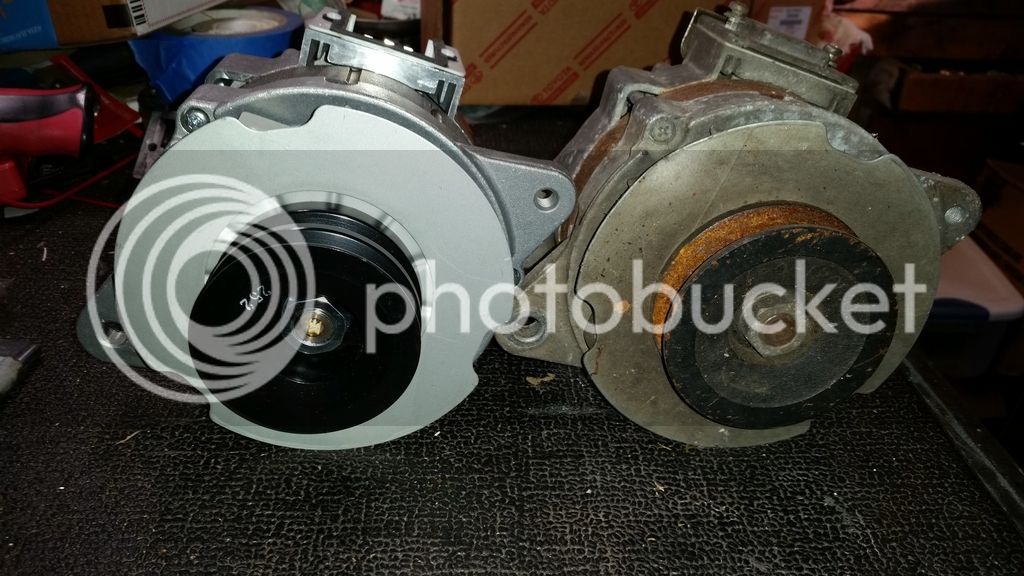

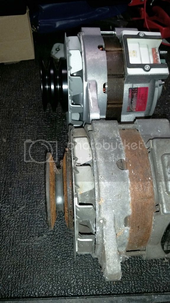

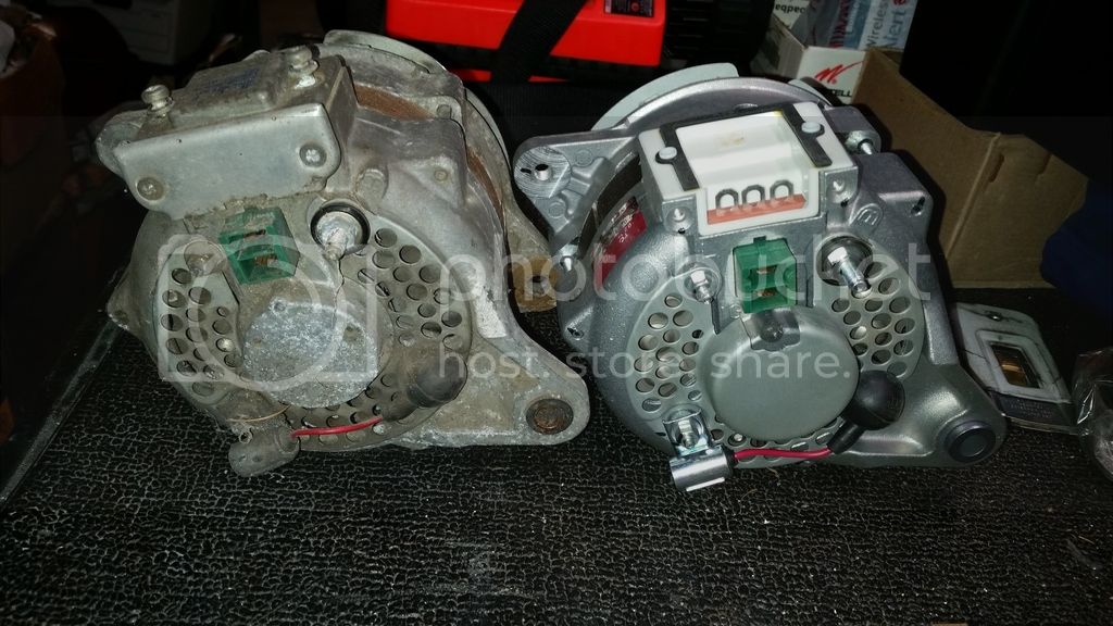

OK, so last week I got 2 of the celica alts
plug, wiring, ears, mount ect are all the same as a stock 8/80+(maybe 79+) 40/60 alt. It will be a direct fit for a 60. fj60 voltage reg swaps over exactly. I did not test fit the alt because the 60 has a Mean Green and the 40 has an almost new OEM alt.......didn't have a need or real desire
however on a 40, because of the double pulley it won't fit(well it might but it would be real tight0 without hitting the radiator shroud, so in that case, you just need to swap the pulley from the old alt. the pulley on the replacement alt is also a bit smaller so you may want to swap the pulley anyway, but not sure if it really will make much difference in the belt.
few pics(old alt is original to the 82 fj40, not a reman, has te sexy old ND decal)

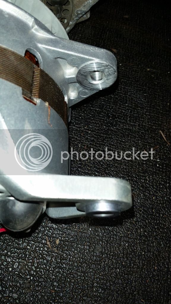

there is a little nub on the back of the mount that is not on the original, I don't think it makes any difference, distance between mount is the same.
I do wonder where the extra 5 amps comes from, it it the smaller pulley? or maybe in the voltage reg? (celica vrs cruiser) I am not smart enough to know......;)
