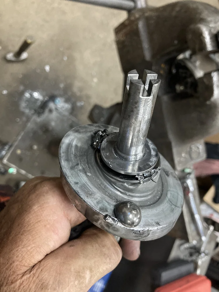

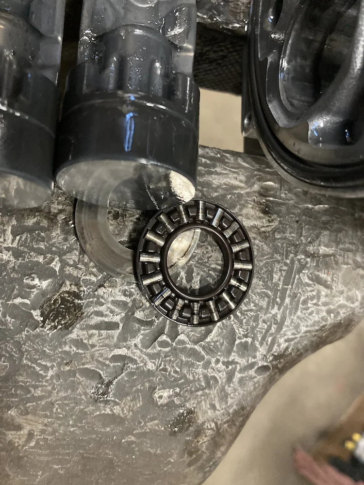

Because there would be no warranty coverage, we decided to disassemble the seized compressor and find out what had failed. Sure enough, one of the two cylindrical thrust bearings was fried. To me, that was very disappointing service from what I had thought was a quality parts manufacturer. I certainly hope the new compressor lasts a lot longer...
Pics:
What the cylindrical thrust bearing should look like (the good one).
The destroyed bearing.

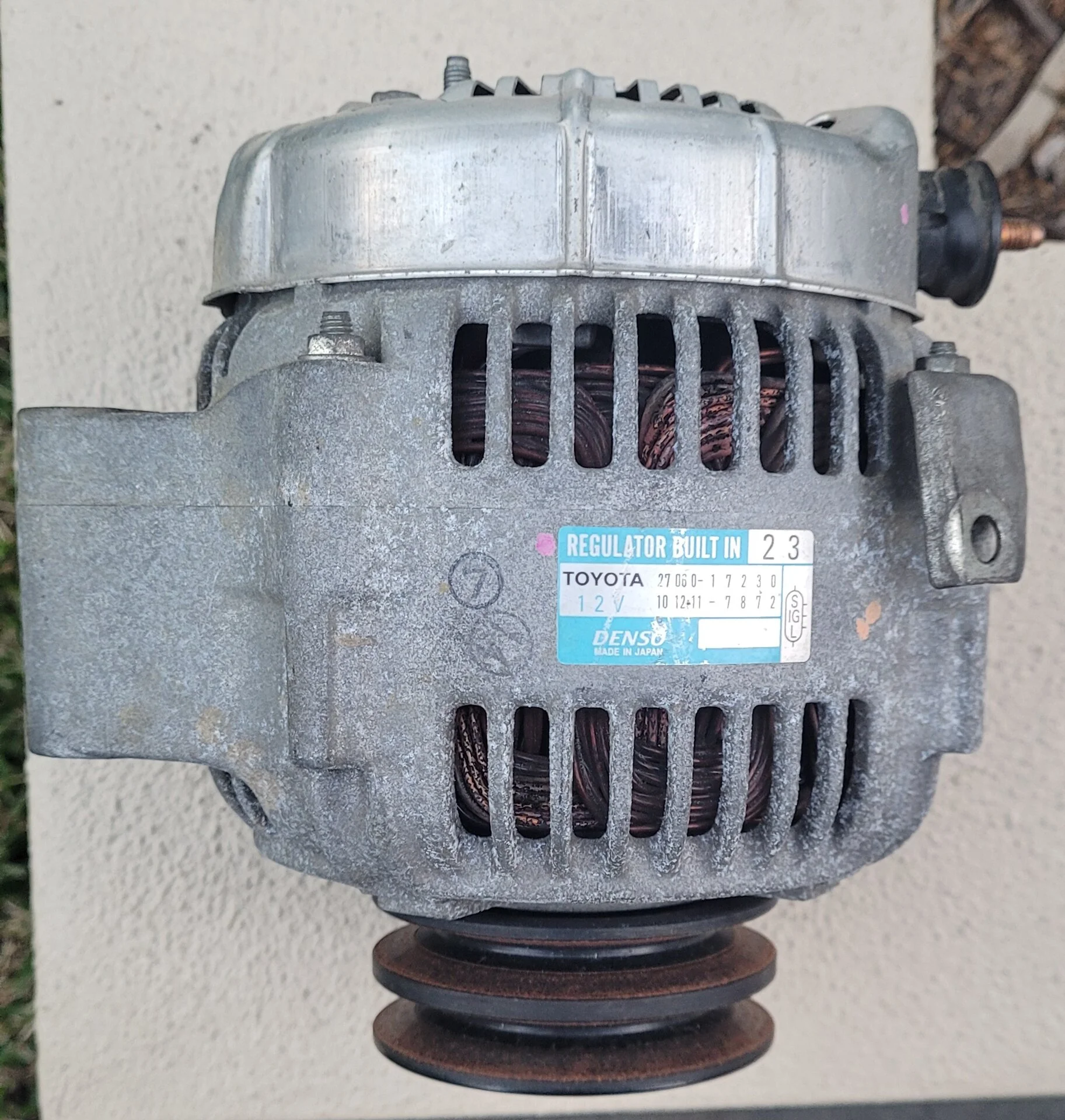

The original DENSO factory-fitted OEM Alternator failed after 193,926 kilometres (120,000 miles) and 13 years -- inconveniently while touring!! Re-charged the batteries (two on LC100 with 1HD-FTE turbodiesel), drove 184 kilometres (~144miles, about 2½ hours) from Coonabarabran to Mudgee. One of the side-benefits of the diesel is no spark required, fuel pump is direct-driven by the engine, just needed enough battery voltage for long enough to run the vehicle electronics, brake pressure accumulator motor, radio, phones, other ancillaries etc, etc, but lights OFF, aircon OFF, no stop and re-start of engine -- probably could have travelled much, much further without stopping.

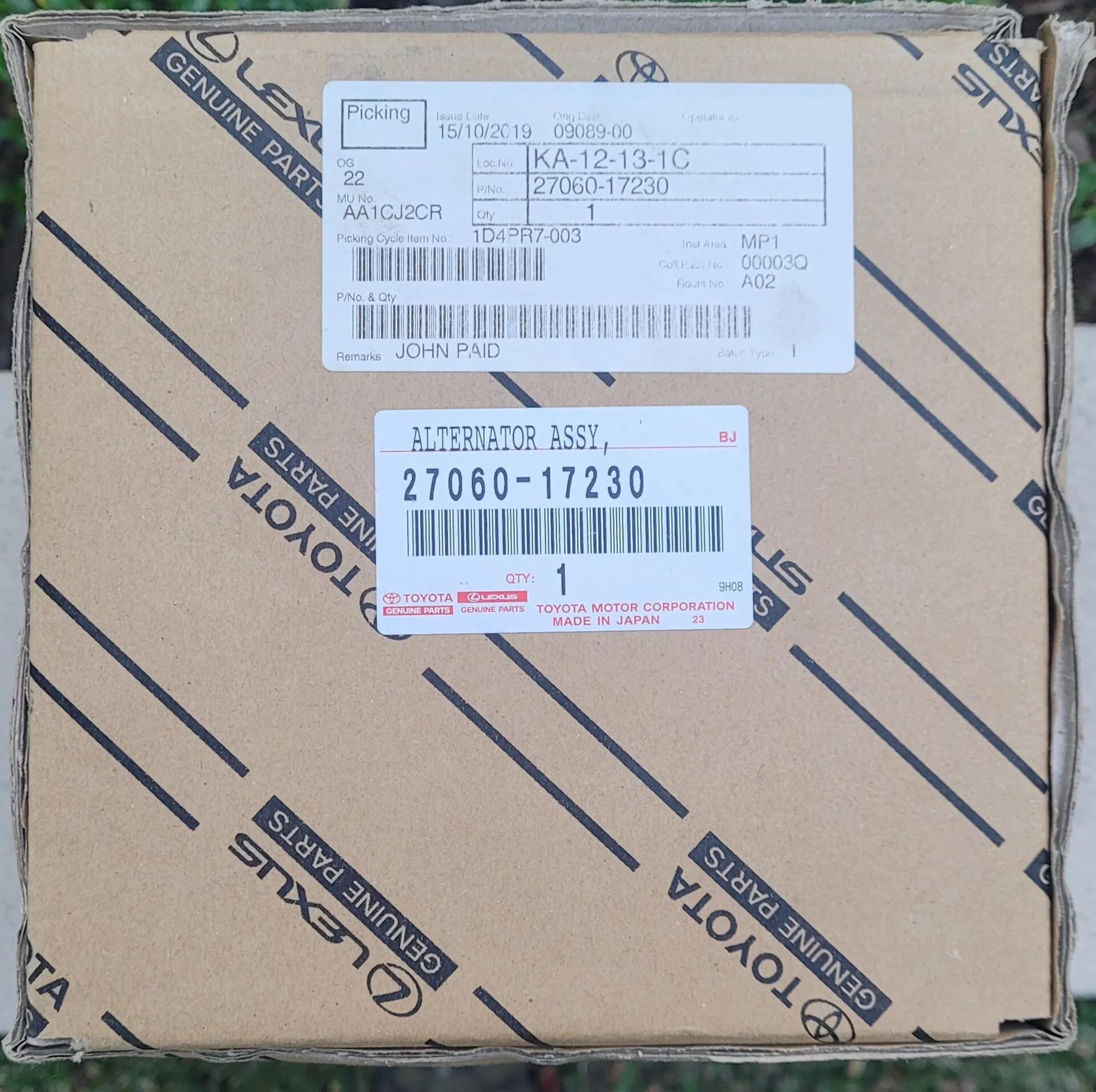

On arrival, a new OEM Alternator had been delivered by Toyota Australia Main Distribution Centre to the Local Dealer in Mudgee, Toyota Part Number 27060-17230 for 1HD-FTE turbodiesel engine. The Toyota package contained a new DENSO unit, replica of the original unit -- and this was fitted to the vehicle. This was not the best negotiating position with Mrs IndroCruise on board and while leading a convoy, no time for better ideas from eBay, Impex or Partsouq -- so I was wiser but A$442.75 poorer for a quick fix, supplied and fitted!!

Original OEM factory-fitted DENSO Alternator for LC100 with 1HD-FTE:
Toyota-supplied package containing replacement DENSO Alternator for LC100 with 1HD-FTE:
