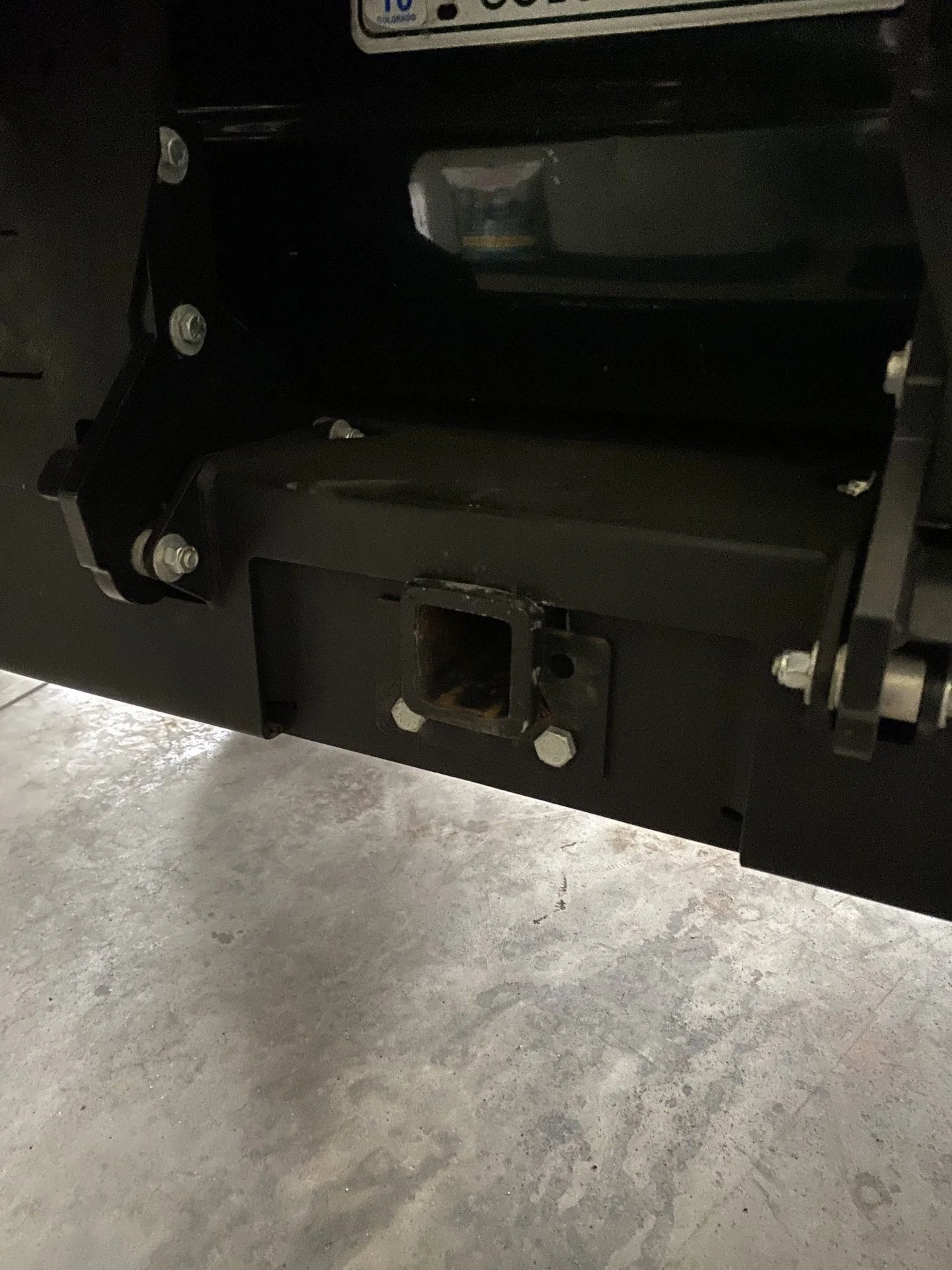

In case anyone was wondering, you can most definitely install a Slee hitch into a Delta bumper. The process to do so is pretty simple following the Slee instructions since Dave designed the Delta bumper with the intent on allowing folks to do just this. I just used a sharpie to mark out a box around the 4 factory bolt holes in the rear cross member and then used a zip wheel and saw-zall to cut a rectangle out of the bumper shell and rear cross member. Apply some primer and black paint to the cut edges and then bolt it all together. The result is nice and clean bumper, now with a super bomber hitch.

Thanks for posting Photos. We both have the same color LX450. My Delta VS front and rear bumpers just arrived. It looks like the Slee hitch bracket and LRA Fuel tank is a no go but great mod nonetheless.
So you are SOL on having a receiver now? That would be a solid no go for me.

If I need a receiver, I believe I can use my current receiver underneath the Delta VS rear bumper. The factory hitch doesn't traigulate like the Slee bracket does, but attaches to underneath the frame rails. I haven't installed the bumper to check fitment though.
Yeah the triangulated Slee hitch wont play well with the LRA AUX tank. I plan to replace the main tank with an LRA 37 gallon unit. Never have been a fan of all that fuel weight being behind the rear axle for handling purposes, espesially with all the rear bumper weight most of us have added.

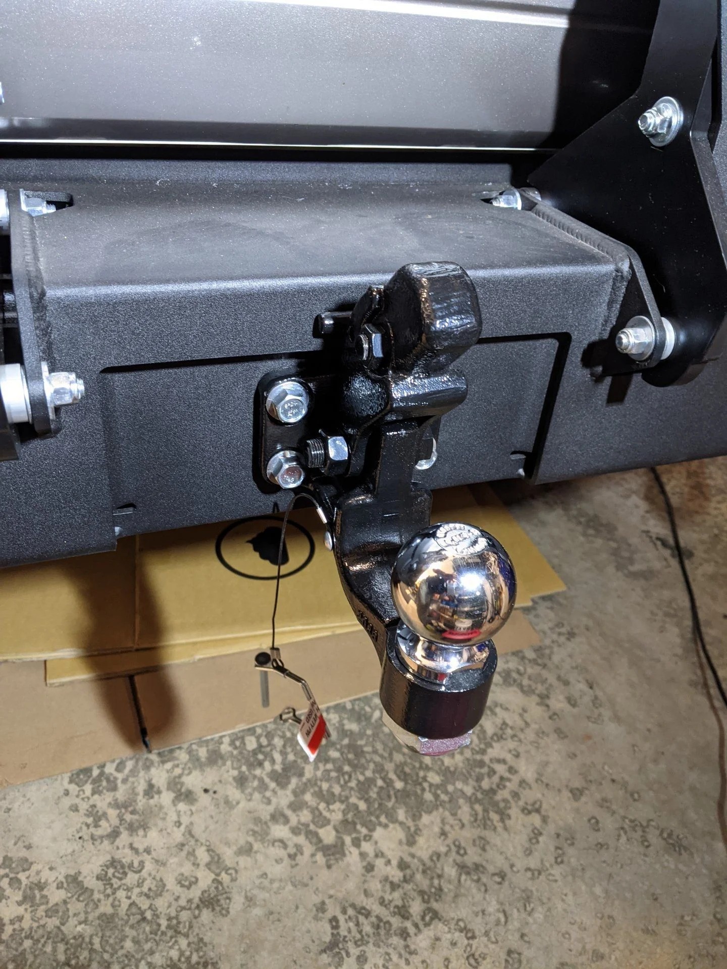

Regarding your pintle hitch, you should be fine for light towing (think small utility trailer), but I wouldn't recommend using it for recovery. The shock loads that recovery will put on those threads could turn that whole pintle into a missile firing at the vehicle behind you that is either recovering you or you are recovering. The Delta bumper has two very stout recovery points built in already, I would use those with a rated shackle for all recoveries.
This setup works great, I had my homemade jobbie already in place when I got the Delta but basically the same design, probably cost me $10 to pull off. Been working great for years, I just need to finish it to fit the bumper and used their plate to cover the gaps for now... Was really nervous cutting into the bumper but had to move forward or cut it all out. @Dirty Koala, what are you going to do to mount the wiring hookup placement? this is where I stalled out a bit as I don't want it hanging down and ultimately was hoping Delta would make a nice little hatch to maybe cut into the face.

I haven't given much thought to the trailer wiring plug mount yet. I currently just have the 4 pin wire tucked up out of the way. If I start pulling a trailer with any frequency, then I will likely figure out an easier to reach placement.
