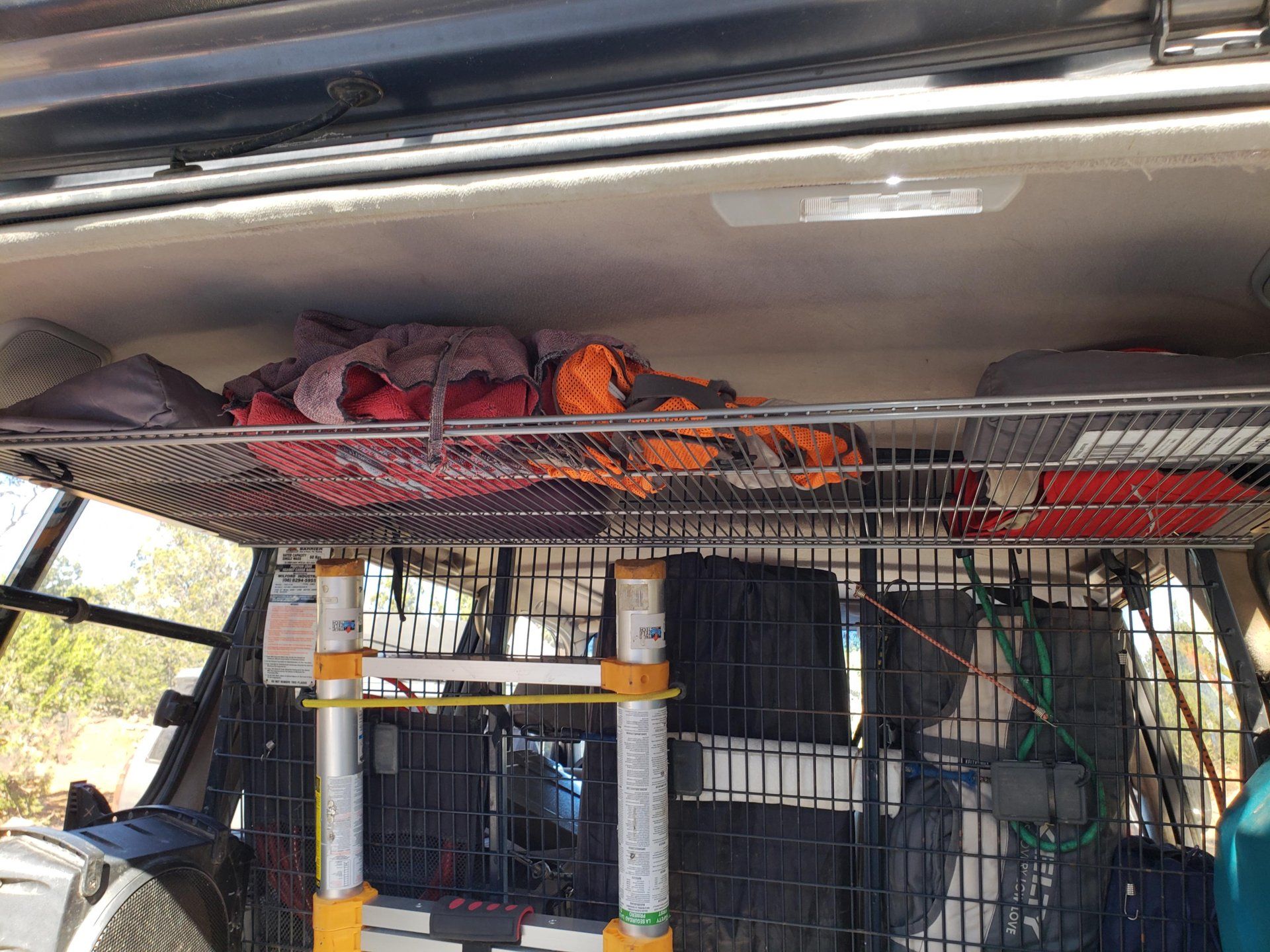

Crappy cell phone pic. Love the sturdy Delta brackets! Fellow mud member had ordered a two pack wire shelving from Uline I believe. I've got a 25lb Goal Zero Boulder 100 stored up there with a few soft goods on each side and blanket for cushioning below the solar panel.

Haven't been offroad yet, but on rough road, the wire shelf does flex, thus the cushion under the solar panel. We'll see longer term about the weight of the solar panel. Brackets are sturdy enough. Time will tell on the screws into the factory grab handle mount.

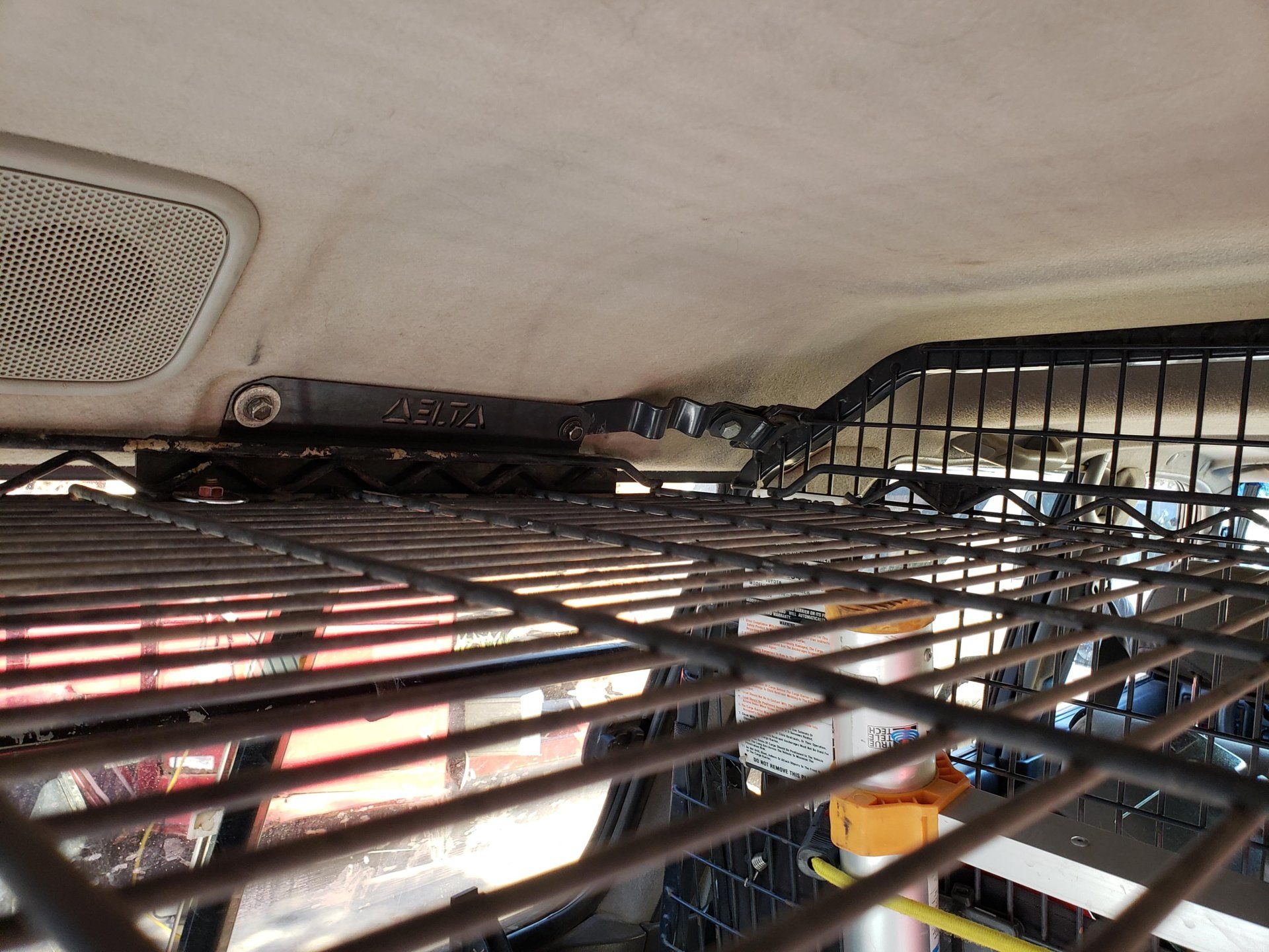

I have a Speski cargo barrier mounted to the same nutserts and I believe @NLXTACY measured to confirm the delta shelf comes too far forward to work with the Speski, but the DIY shelf with Delta brackets may be good. I am just concerned with the strength of the 21 year old nutserts...I think one of mine is already cross threaded.

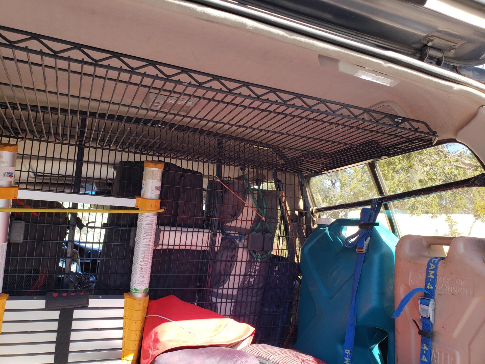

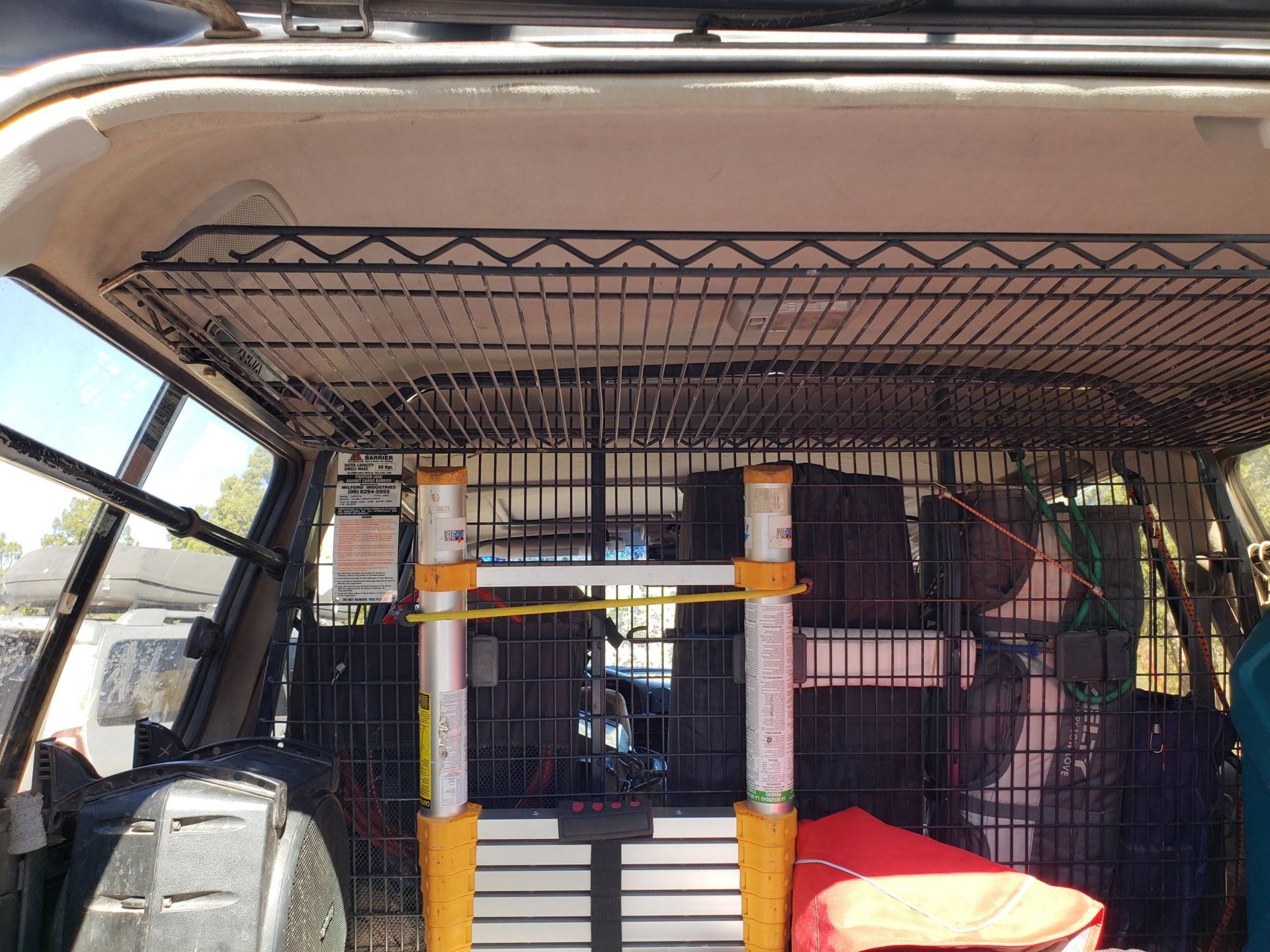

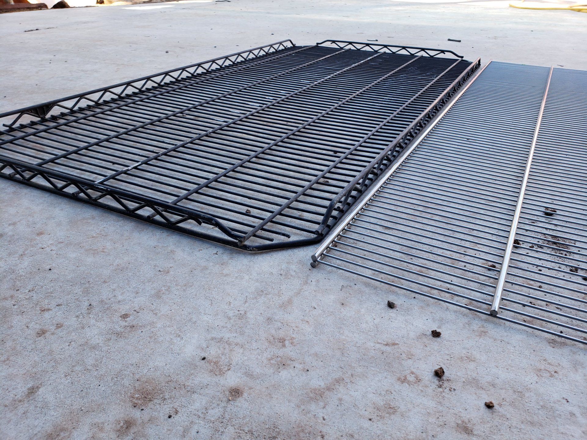

So, I went back to the Container store and returned the 18" x 48" Metra wire rack because I wanted something deeper. It did a great job but I needed more real estate so I picked up a 20" x 48" Elfa (spell?) rack but it's not built similarly as their Metra. This rack is a bit flimsy due to the missing side walls but I installed it anyway. After going on a four day wheeling trip torture test, this rack got returned! All items kept falling down on top of the three dogs. The sidewalls are very important I realized when your rig bounces all day long.
I found an used Restaurant supply store and he had various sizes of these Metra wire racks. They were all sitting outside exposed to the elements but for $15, I didn't care. I grabbed a nice 24 x 48 Metra shelf without the four holes, one in each corner. So, this rack went in and we're going on another four day wheeling trip come Thur.
This rack is completely bottomed out on the Milford barrier but for most folks, you can adjust the rack forward/backward as you see fit. I don't have much of a choice due to the cargo barrier. This new rack did have a sidewall running lengthwise through the center that I removed. It'd have made shoving things toward the front of the 80 a little more arduous.
You can see pics with the Elfa rack in place vs the new rack in place.

Looks great, thanks for posting pics!
