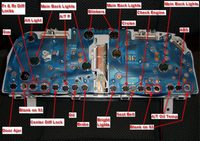

This is a picture of the rear view of the instrument cluster of a 93 showing which lights are for what on the cluster.

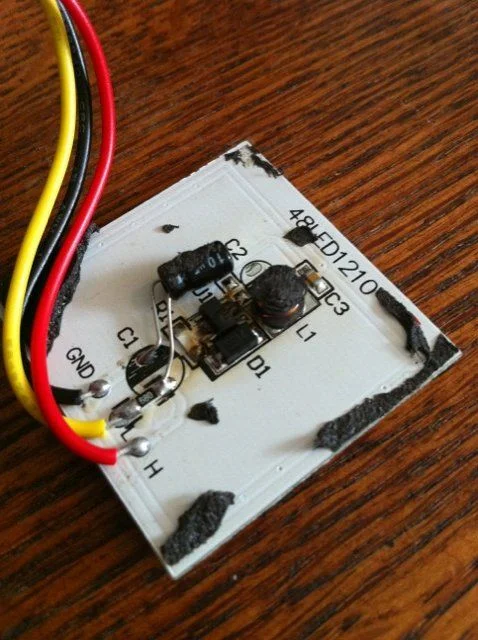

Just popped 4 of the 48 SMT array LEDs at $24.00 each :eek:
Autolumination keeps cost reducing and the new lights are not protected against polarity. I have seen three different versions now and the newest has some sort of load coil on the back. Red is positive and the side closest to the switch is the positive side of the dome light. If you put them in backwards, they will burn up.
