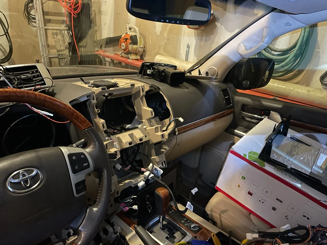

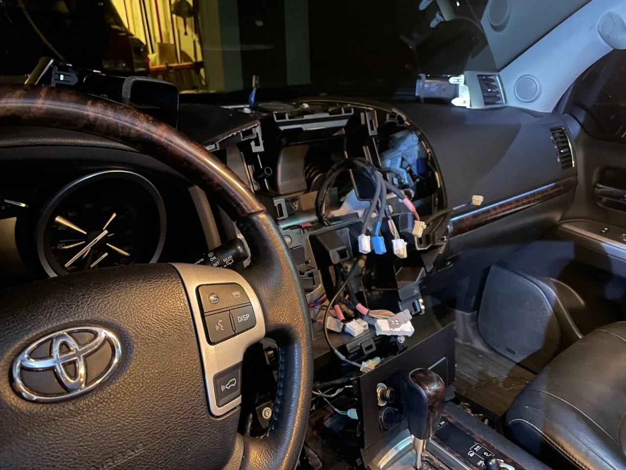

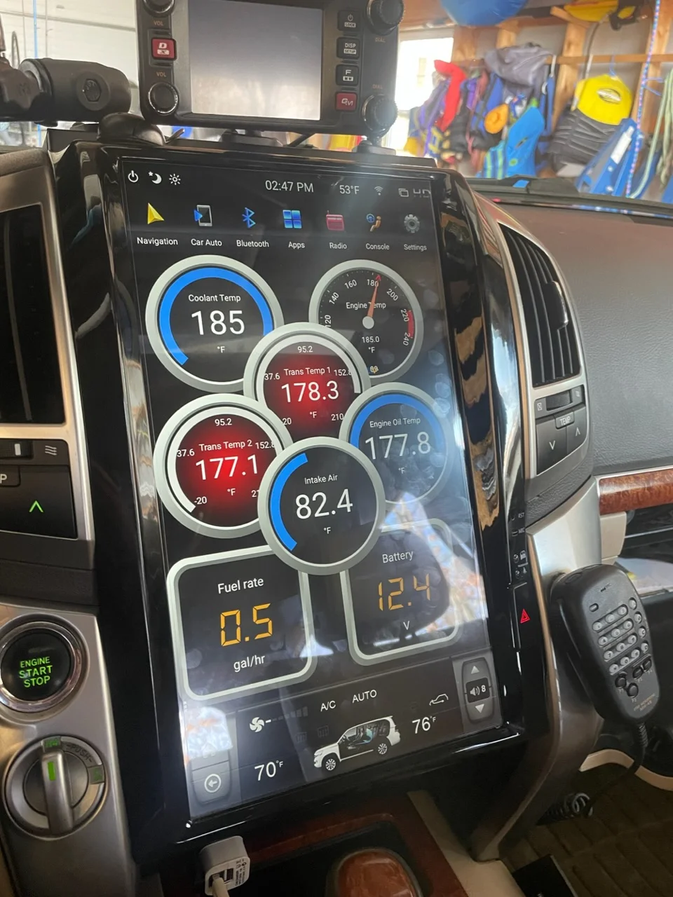

Started the first swap-a-roo, and pulled out the Tesla head unit and OEM radio from the new 200.
It was kinda fun but also sad as I recalled all of the countless hours I spent on all of the mods and getting it all dialed in and now start thinking of the quantum of work ahead. I’ll have to get better at just taking each thing one at a time. Will install Tesla unit in new 200 tomorrow.

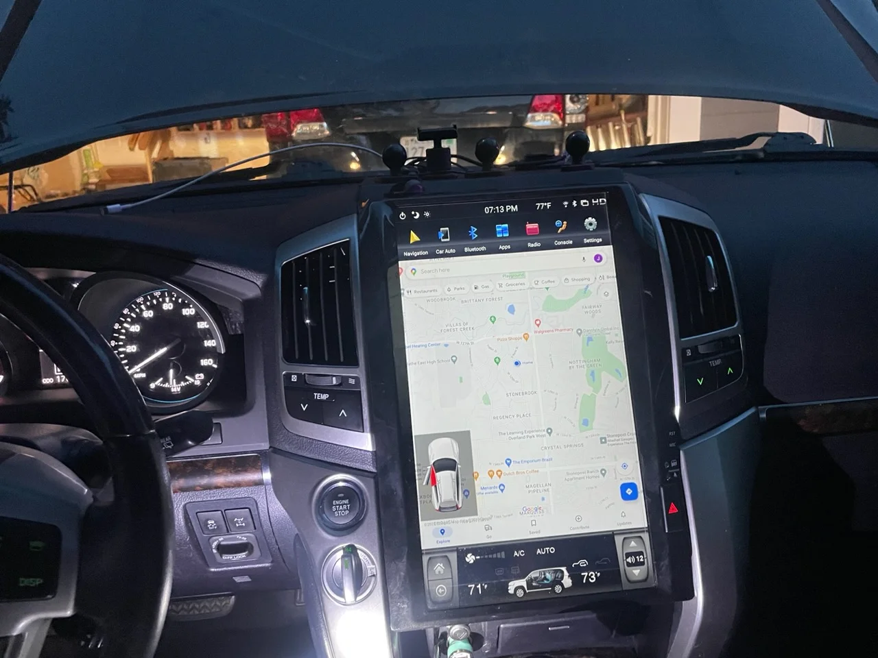

Got the Telsa unit installed and running on the 2015 and the original HU back in the 2013. Had a few self inflicted issues with harness connectors not fully seated and one missed connecter when I put the OEM HU back in the 2013 but all good now. Also got the ARB compressor and Warm winch and wiring harness pulled off. Started to pull of TJM winch cradle but there are two long threaded rods that I need an extra deep socket to get the nuts off. Order from Amazon and will get Tuesday.

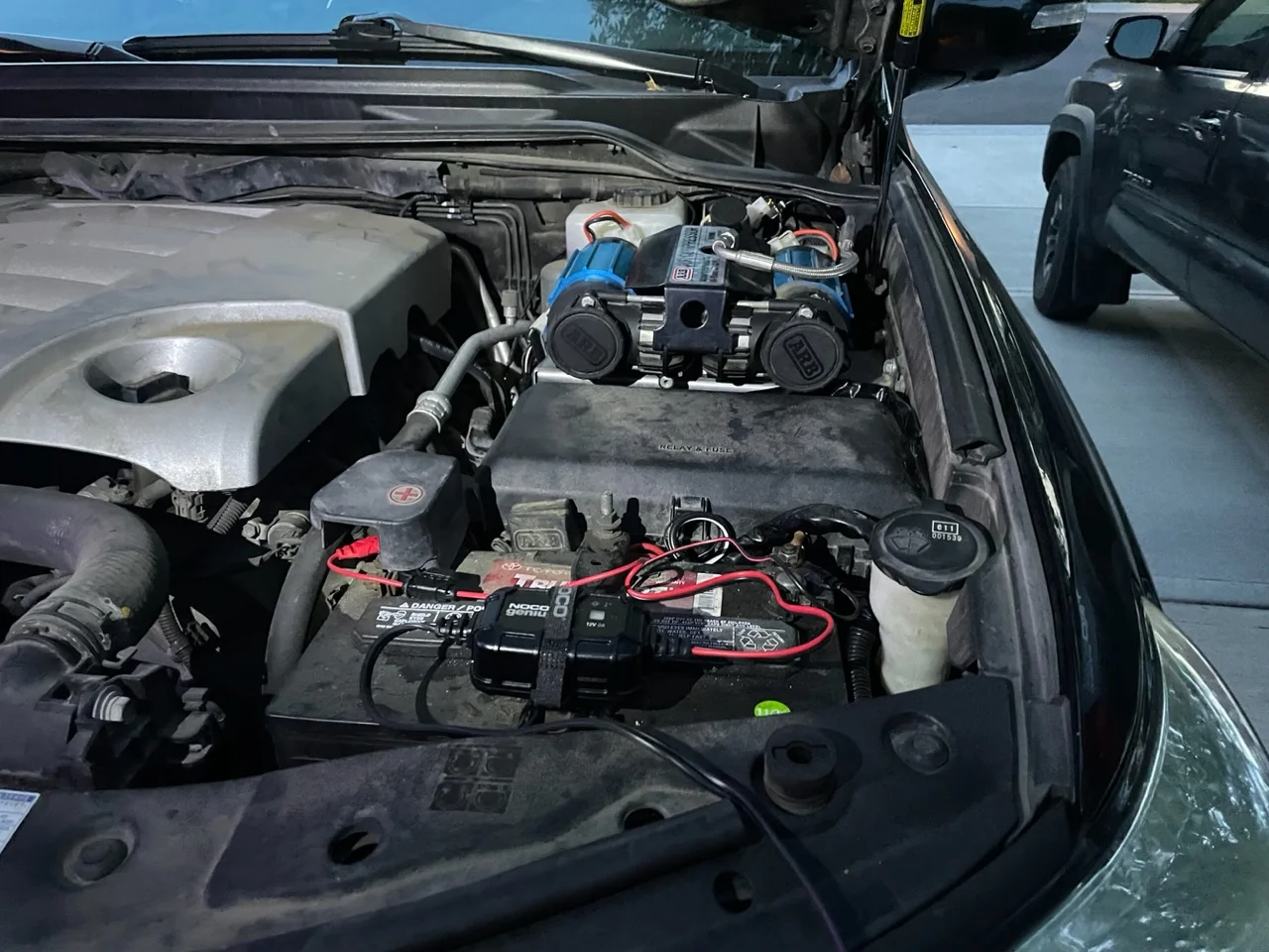

Chipped away today. Transferred LRA, compressor, and locker switch harnesses and power wire for ham radio. Also prepped the 2015 for ARB compressor install tomorrow (transferred Slee air pump relay bracket.

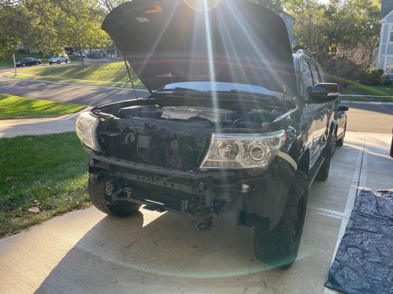

Touch up painted TJM bumper and removed OEM bumper on 2015. Plan for tomorrow is installing inner supports and winch cradle and winch. Outer bumper depends on paint drying.
I misunderstood TJM instructions and fussed with each parking sensor trying to disconnect them so I could remove the plastic but all you need to do is disconnect the harness connector under the fan.

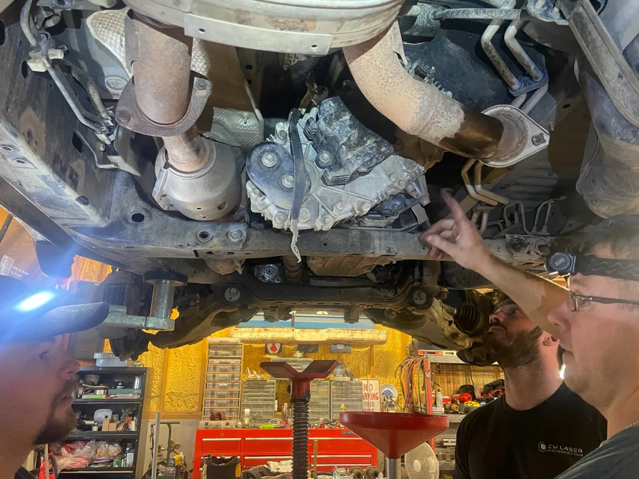

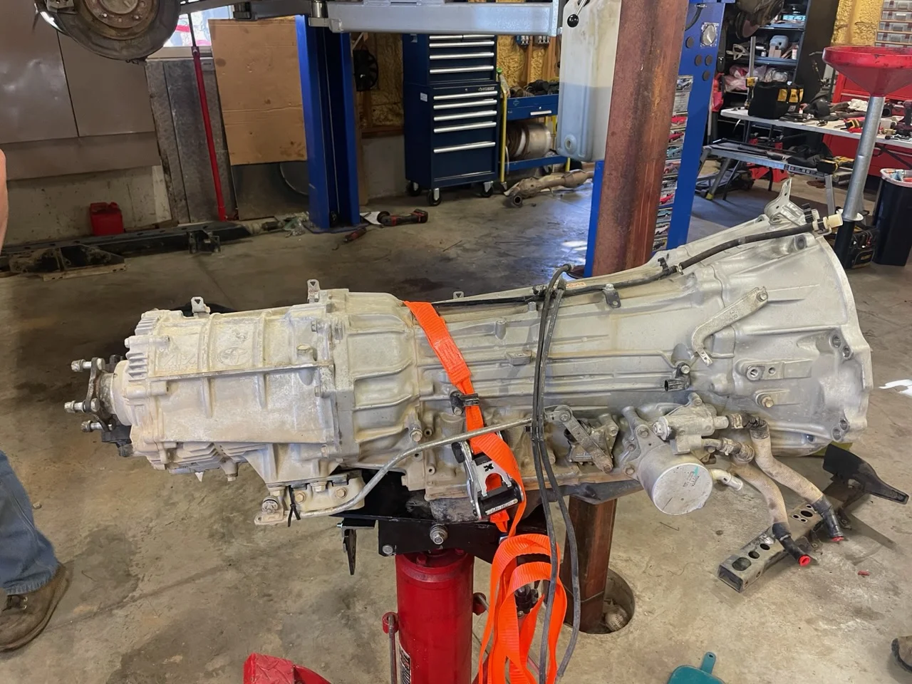

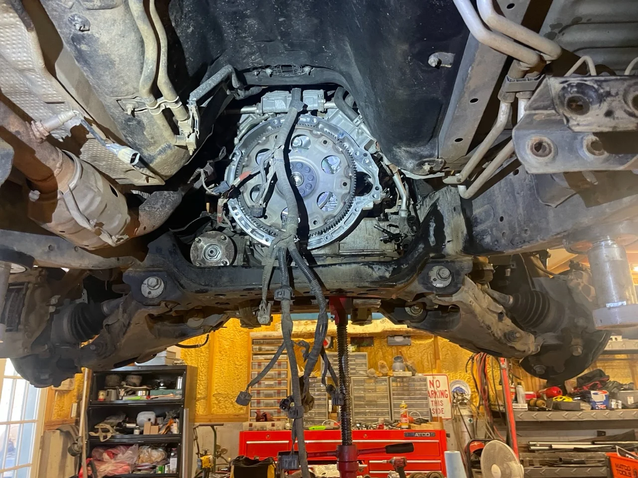

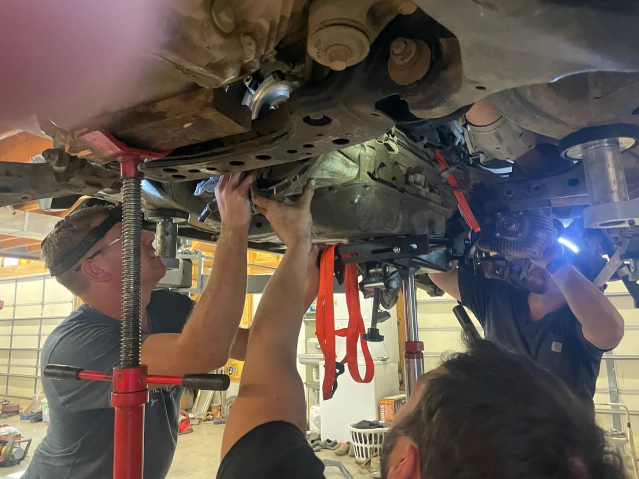

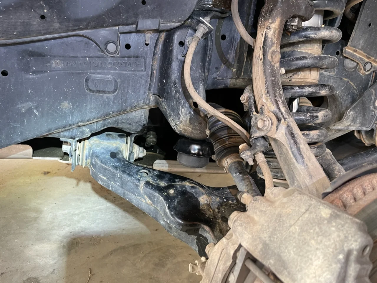

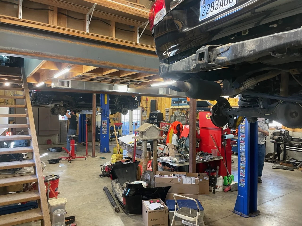

Finally got the two rigs into the shop and started the major parts swapping. With 5 guys (including me) we made good progress today.
Day 1:
  1. Dropped both trannys/transfers, swapped and got one tranny/transfer reinstalled. This includes removing and reinstalling starters as that is necessary to get to bell housing bolts.
  2. Rear main seal on new 200
  3. Dropped rear axles for swap (doing this rather than just third members to retain my gears/lockers.
  4. Swapped front UCAs
  5. Removed Slee siders from wreck
  6. Removed new 200 running boards and swapped back onto wreck.
  7. Removed gas tank and transfer skid from wreck
  8. Started LRA uninstall and prepped new rig for LRA install (removed spare tire carrier and cut OEM brackets off).
  9. Removed Dissent rear bumper wings
  10. Chopped resonator
Caption for that last photo… “wait which one came out of which truck?”

Your personal shop??
