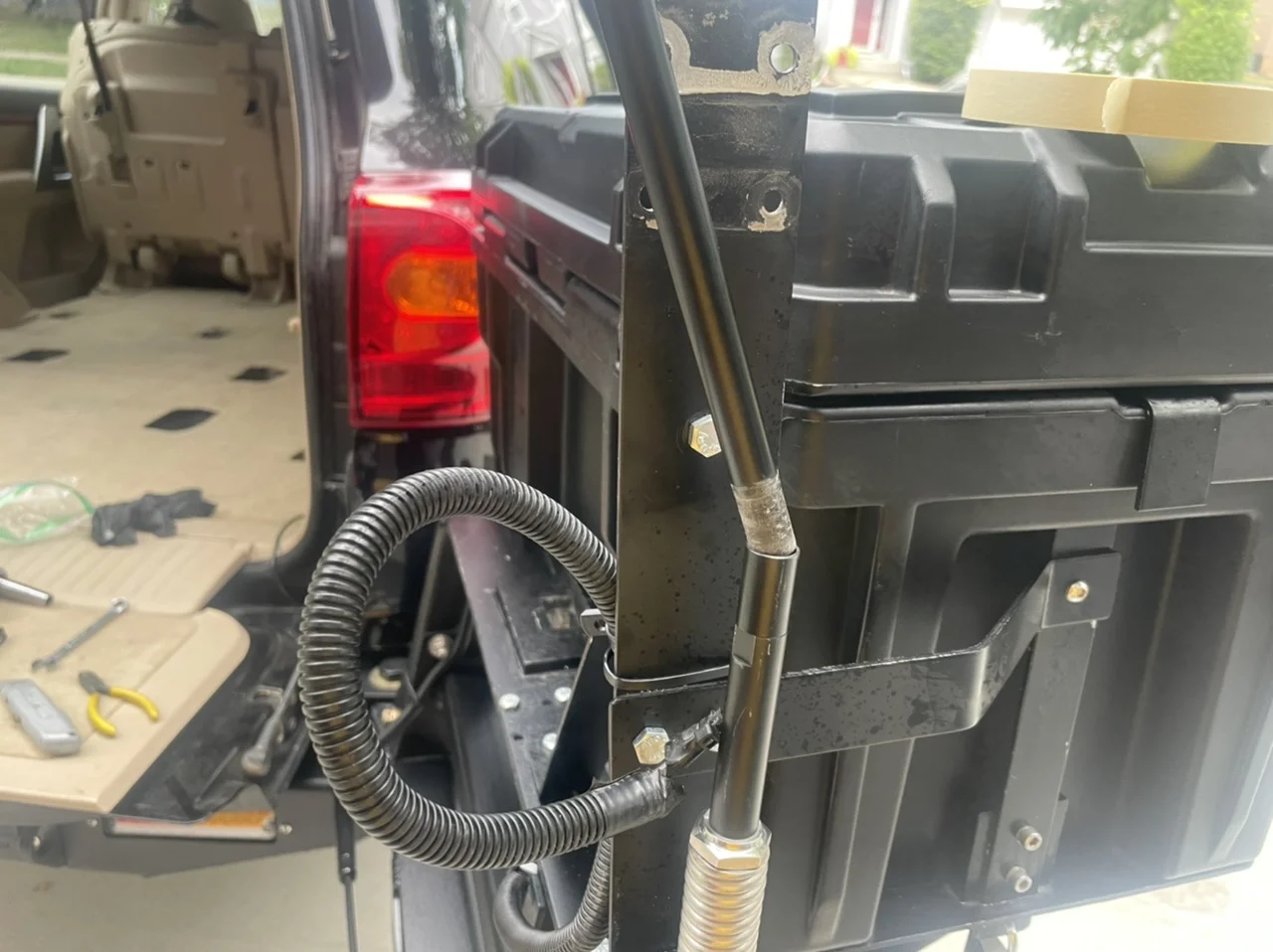

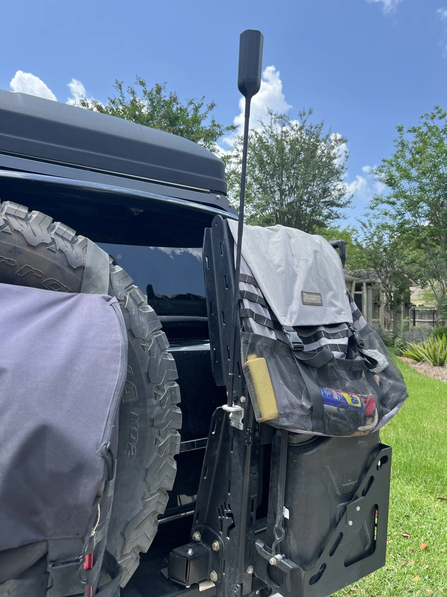

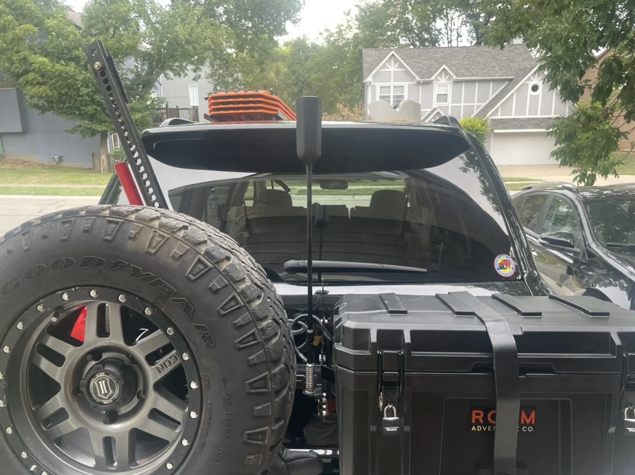

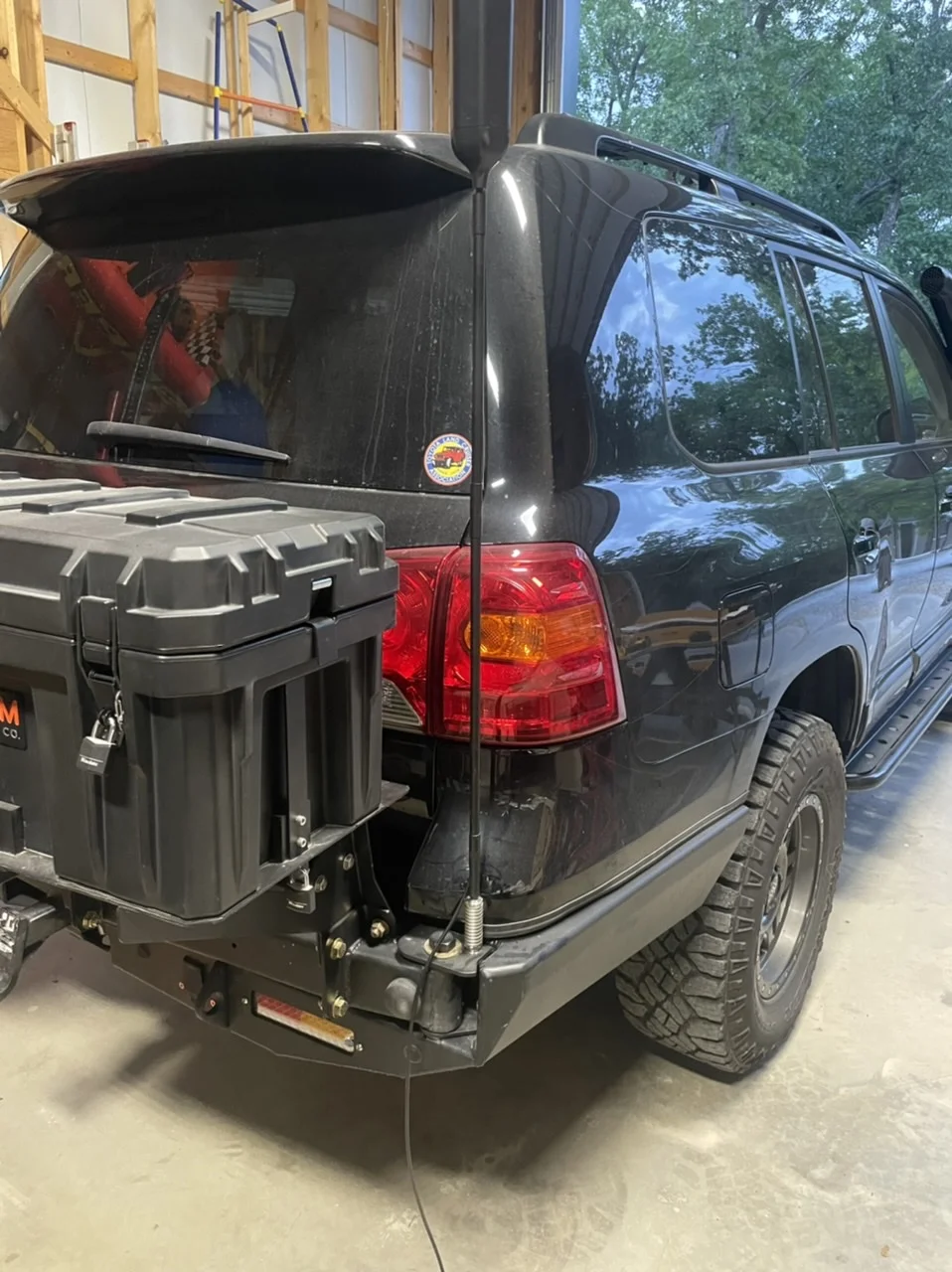

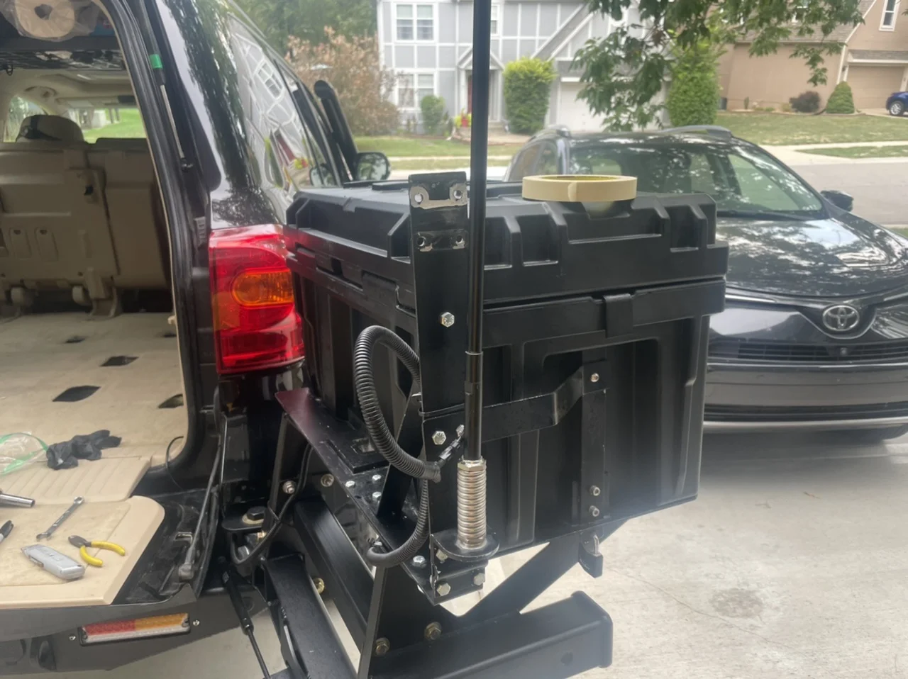

Is this a bad idea? Seems to work with no interference with swingout. I know it would work better getting it mounted higher but I also don’t want it getting hit constantly with trees and I want to be able to get in my garage.
I can’t see a reason why it wouldn’t work. Main thing with these things is the make sure the outside antenna doesn’t pick up signal from the inside one.
I mounted mine on my swingarm.
i saw some coverage from Overland Expo that showed the rep from WeBoost saying they were releasing some kind of "fold over" system "by the end of the year" (really - why taken/taking so long) for getting it higher on the roof...
at trip to HamRadio outlet would likely find you enough parts to do something before then...
i think the main issue would be RF shadows from the vehicle - ie if the tower were located somewhere 8 o'clock - 12- o'clock from the perspective of the vehicle front - you wouldn't get the benefit of the booster, and you might actually get worse performance if the mobile is latched to the booster.
I had mine mounted like this for a short time on my GX build. The problem I ran into was at freeway speeds the antenna would sway quite a bit b/c of the spring at the base and sometimes the antenna would slap the truck on a rebound. Not saying it won't work, just be aware...
Yup. Can confirm this is an issue. Went to Minnesota and back (~1200 miles) and it wagged all over the place. It didn't hurt anything but wasn't good. I moved it to my accessory tray and built a small structure out of scrap aluminum I had on hand to raise it up and let me shorten the "whip".
It’s pretty steady at 80 mph in this location

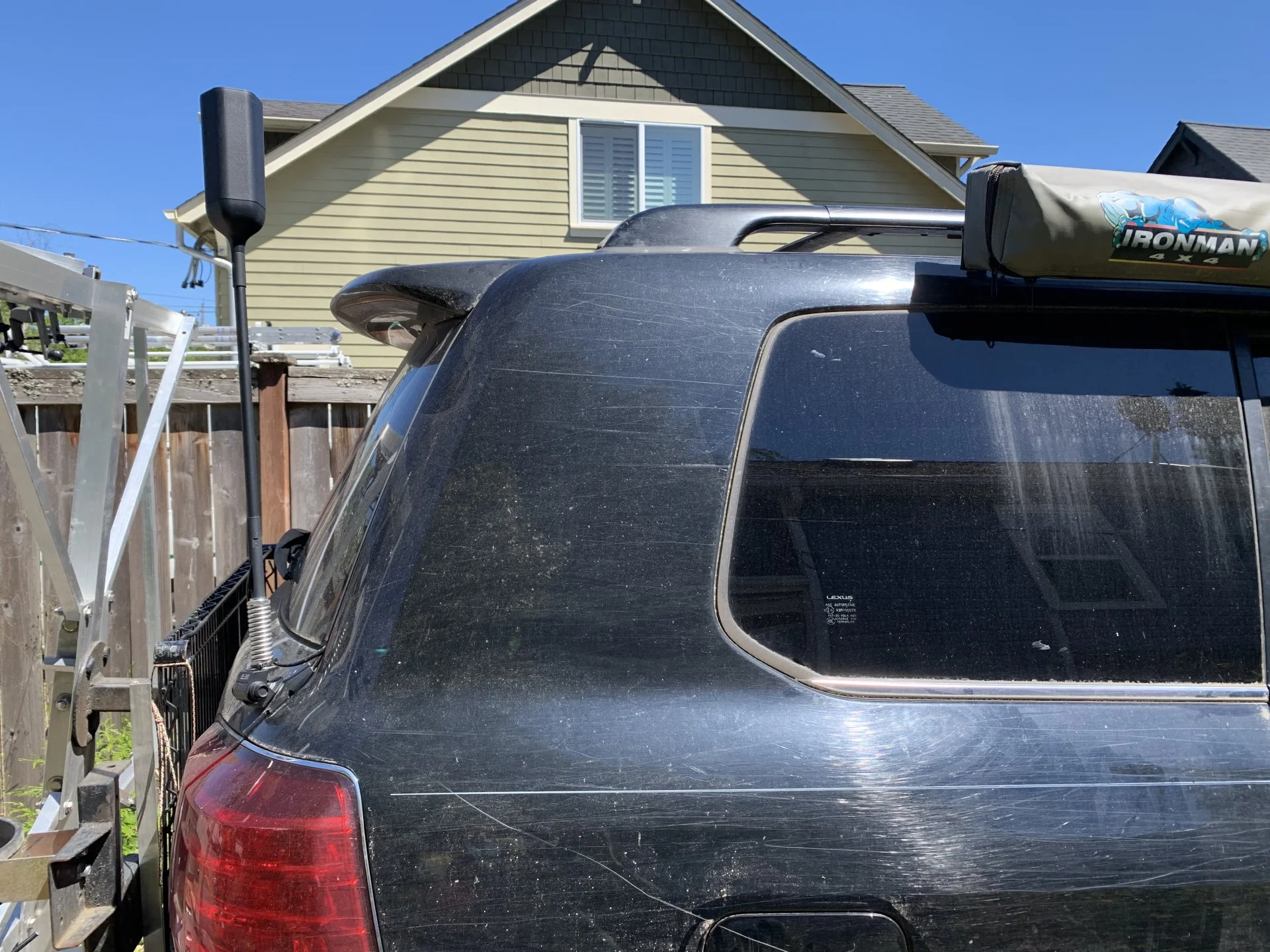

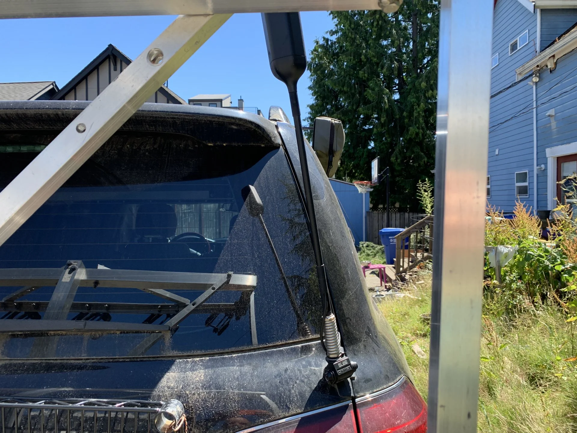

Here’s better pics where mine ended up with the comet rs-840
The 840 joint is indexed, so it can’t be vertical in both planes.
I went with tipped out at first (about 5 deg off vertical), and got some yo-yo/ wind buffet (though it never hit the rig).
Now it is about 10deg off toward inward, and it doesn’t move at all.
Also mostly out of the way if the brush around here which can be ridiculous.
The base of the can is at roofline.

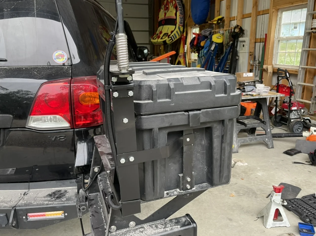

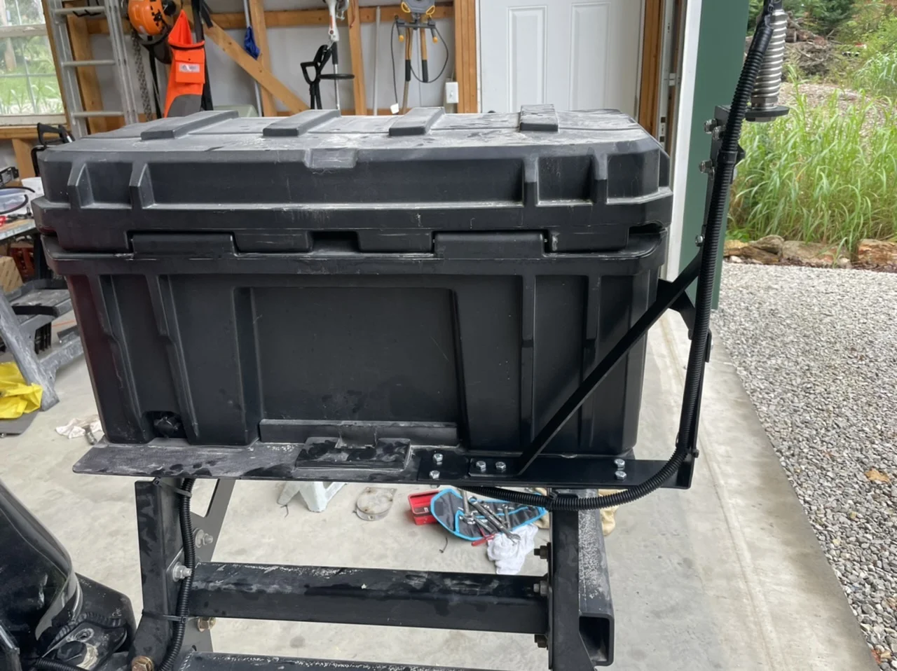

Went out last weekend with local club to an off-road park in Mart Twain National forest. As I figured, antenna take a beating. I had to take my weboost antenna off and zip tie it lower. I added a “down scope” mode to my mount:
Also, the mast joint by the spring came loose and I JB welded it back together. Really wagged around at 85 mph coming home from the weekend.
View attachment 3117531View attachment 3117532
Take the spring off to reduce/eliminate the "wagging".

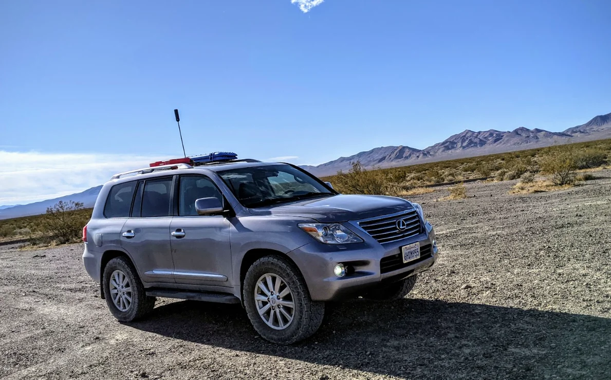

Rethinking my weboost antenna mount and as I'm adding a Descent roof rack, I'm leaning to something like this:
is there a cheaper or better way to mount to a roof rack? If I do that, it needs to be able to fold down.

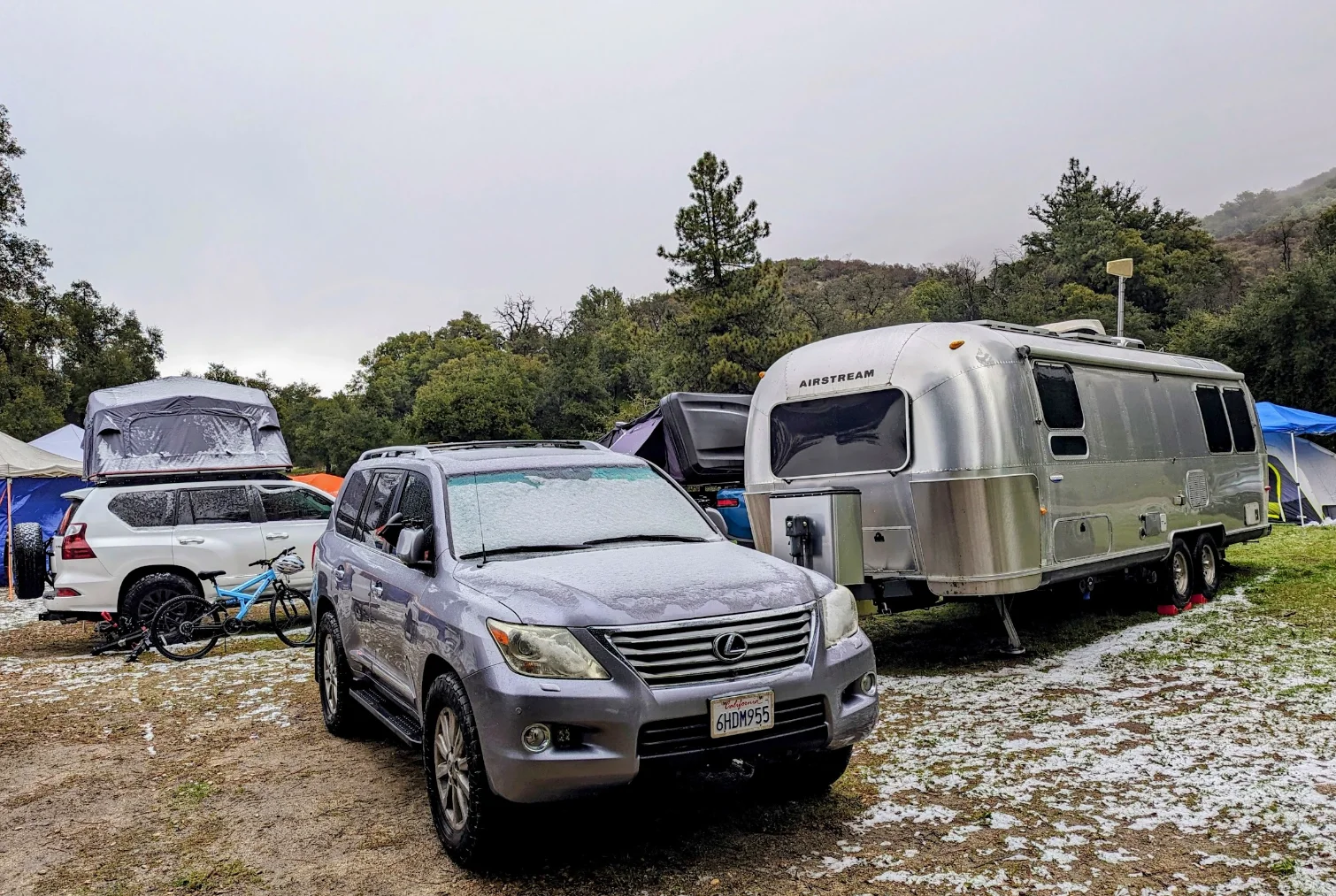

It's the white triangular looking thing on top of my camper and could be pretty easily adapted for stationary camp use.
