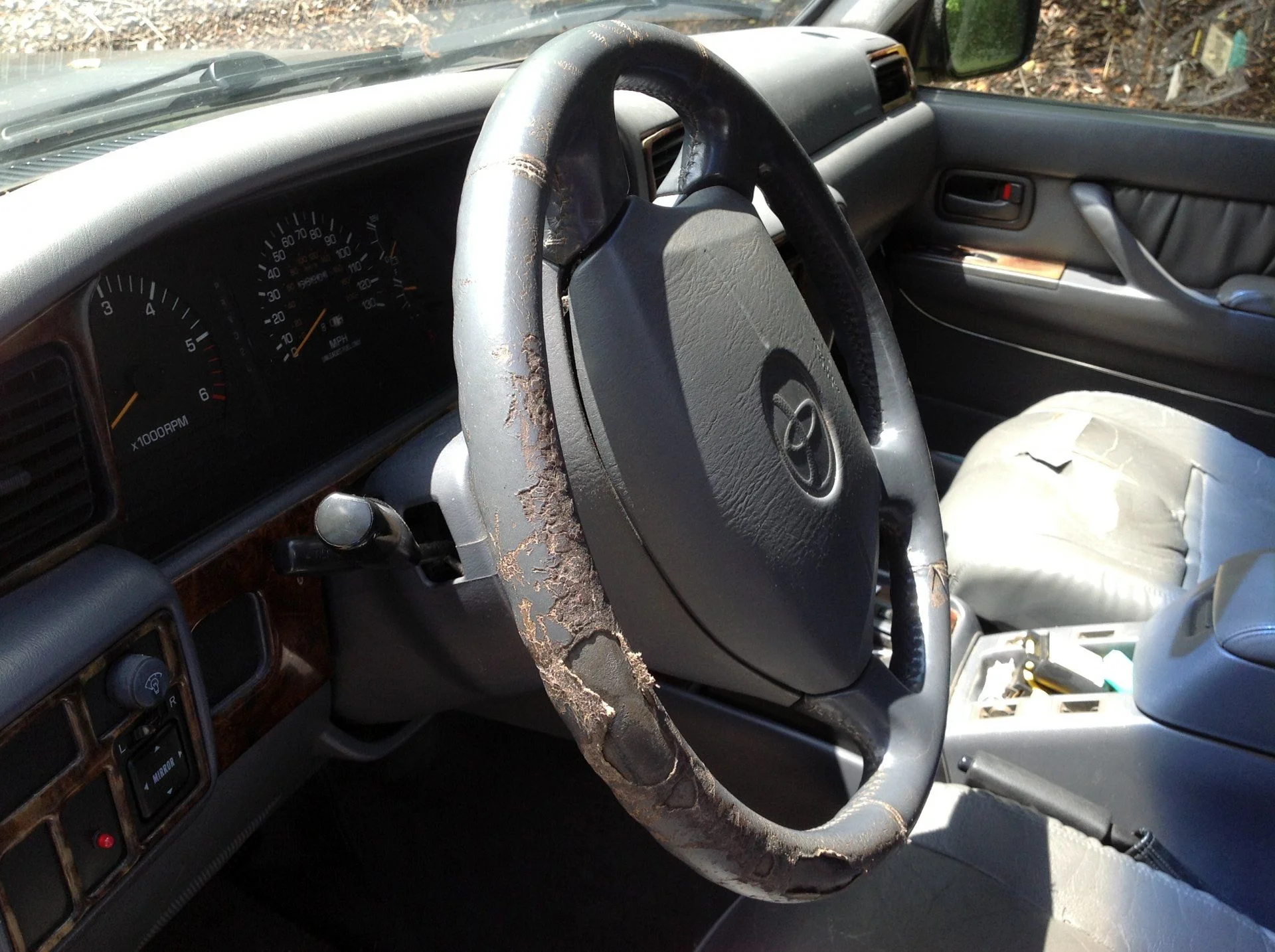

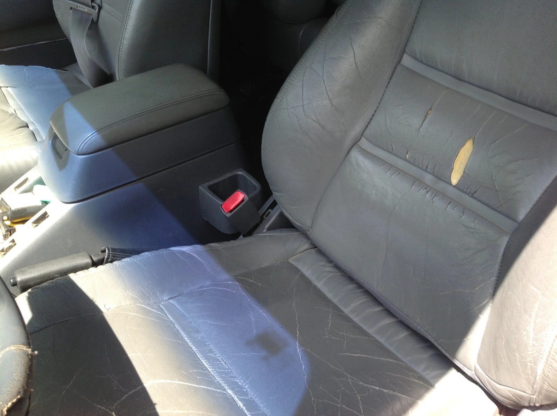

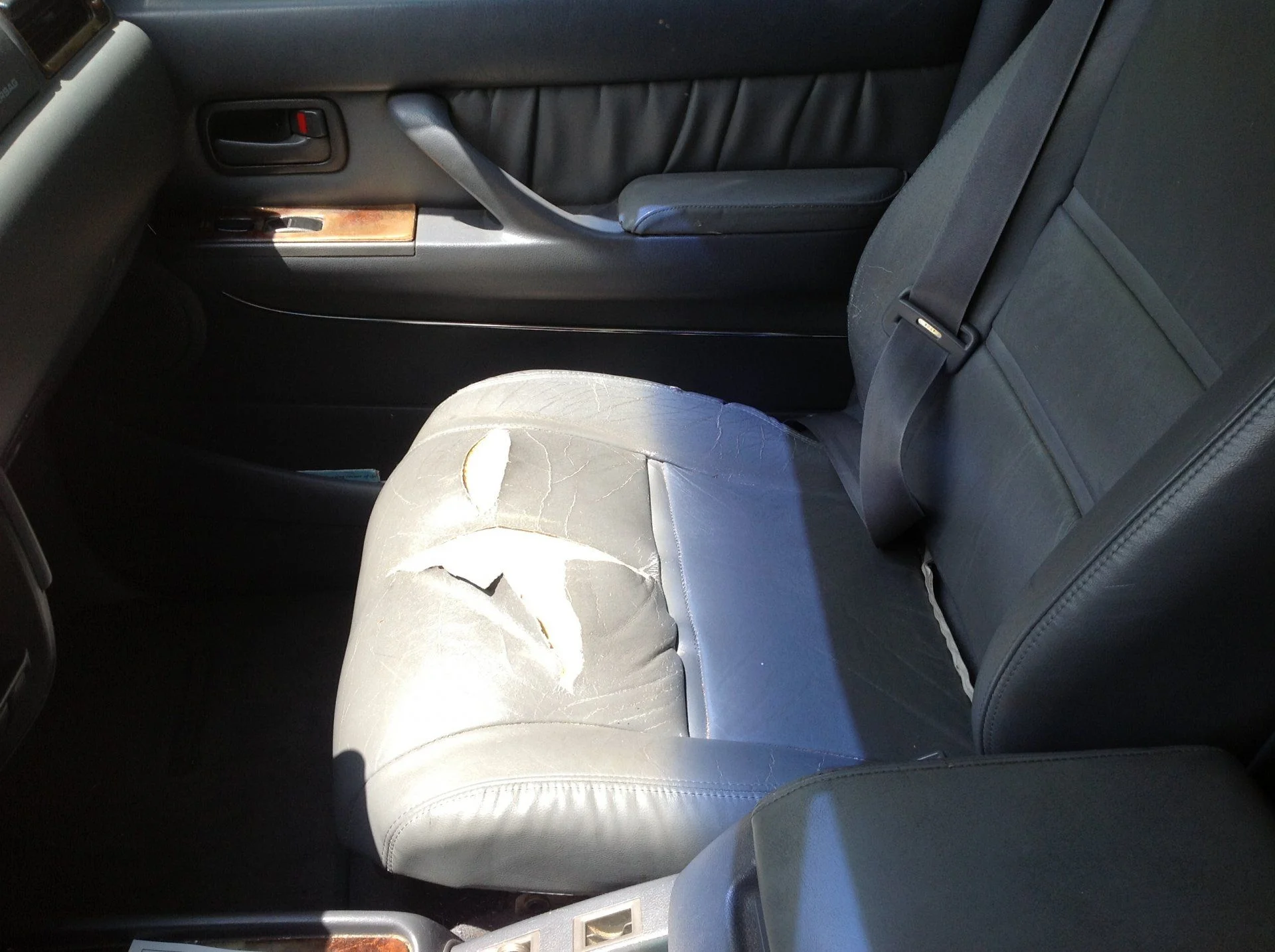

The Landcruiser was previously owned by my father since 2001. I purchased it from him in 2013. Unfortunately my father was fairly rough on the interior of the car, but he did keep fairly regular maintenance otherwise. When I purchased the vehicle in June of 2013 it had 263k mi on it. It currently has 277k mi on it. Over the past 2 yrs I have done a fair amount of work on it. I had no prior mechanic experience other than oil changes on my 1998 Toyota Tacoma. Thankfully I found mud and have learned a ton from the people on this site and the threads. I had the '98 Tacoma since senior year in high school and sold it after graduating from residency to one of my nurses sons. I miss that truck but with the family and only a 2 door truck it just wasn't feasible. Prior to that i drove a 1986 CJ7.

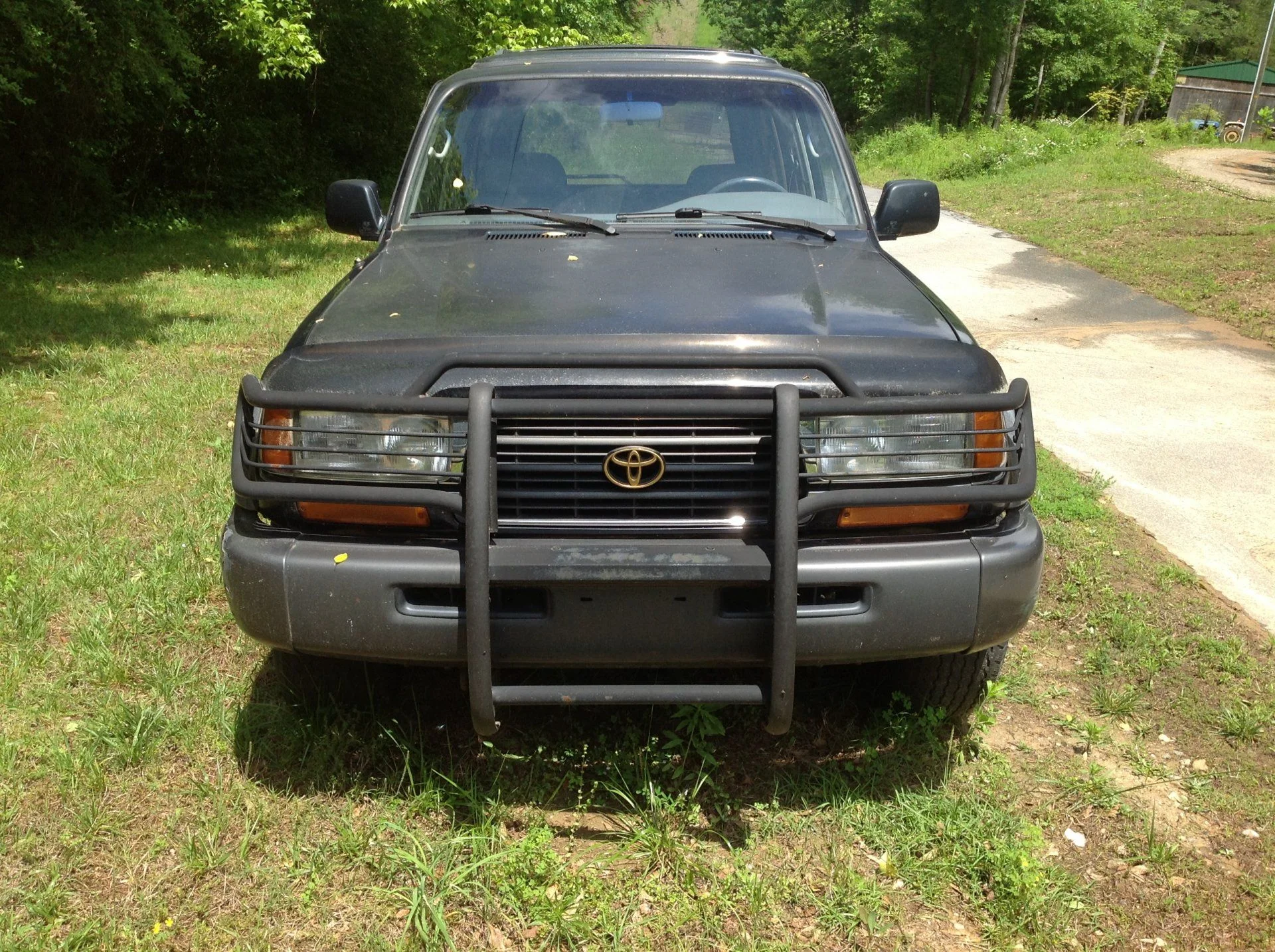

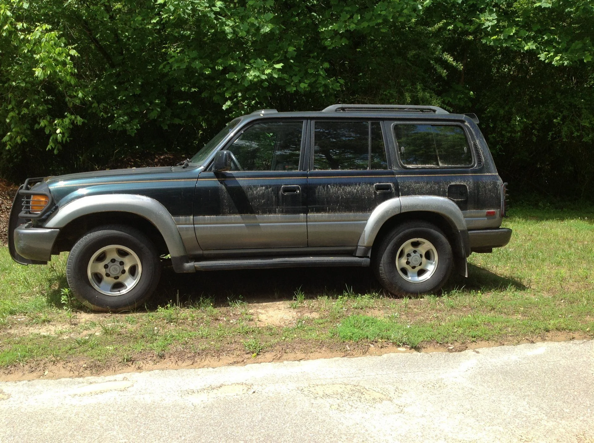

Here is the landcruiser when i picked it up:
