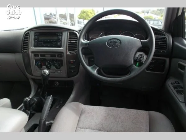

I want to upgrade my toyota land cruiser 2001 hdj100r dashboard to 2003+ i have seen many people across the countries doing this such as in india pakistan
Please give me advice is this okay ?

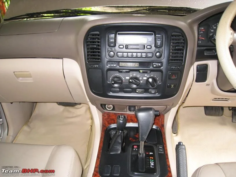

please also have a look of my images inserted in this file

Ya we get Very easily But my one is Toyota Land cruiser vx 2002 manual transmission Pictures in this post are from google as My vehicle is currently in Garage for paint i am unavail to click pictures. and yes independent front suspension also (IFS) I Just want to replace my old and classic looking dashboard to this One which seems more civilized But here agent would order this dashboard from DUBAI Please feel free to advice me

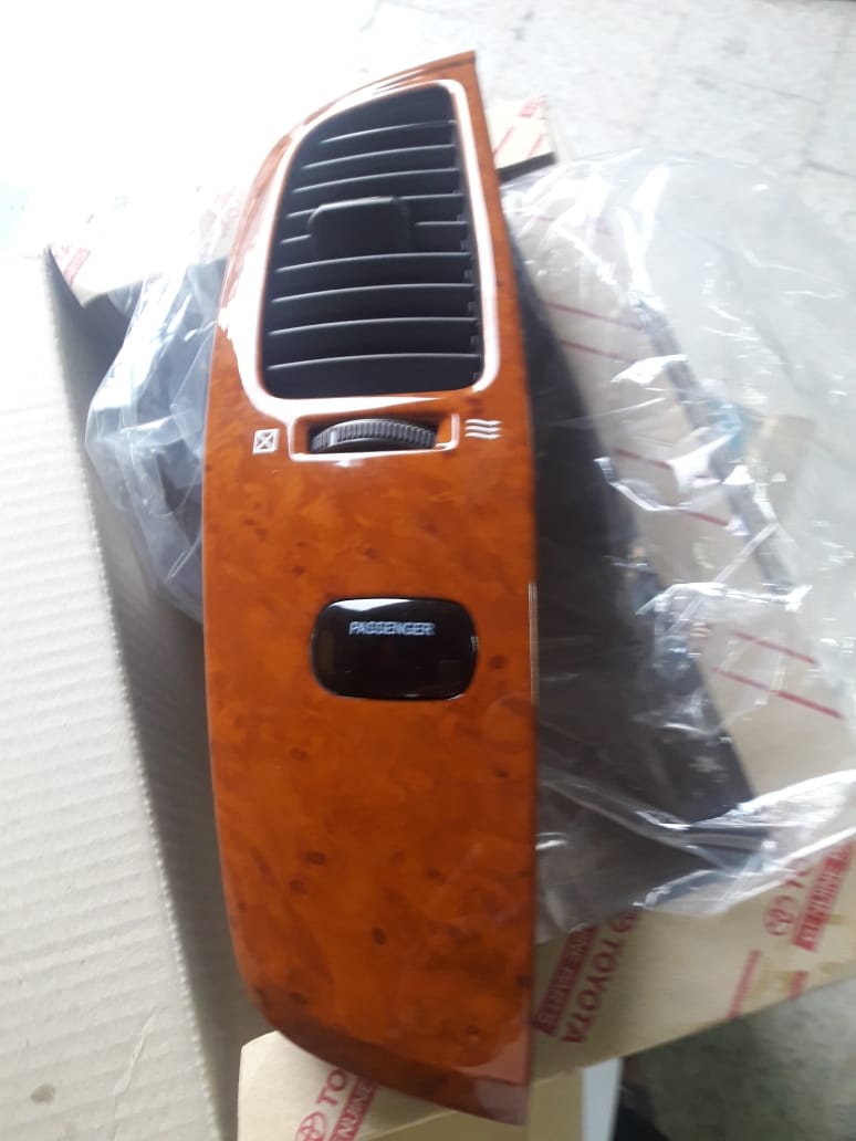

REGISTER Blower No.3: 210usd for both registers no 2 and 3 i prefer wood trim at same cost no change in cost but it depends on your taste buy accordingly to your taste :)
55670-60120

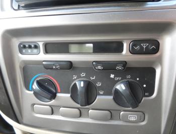

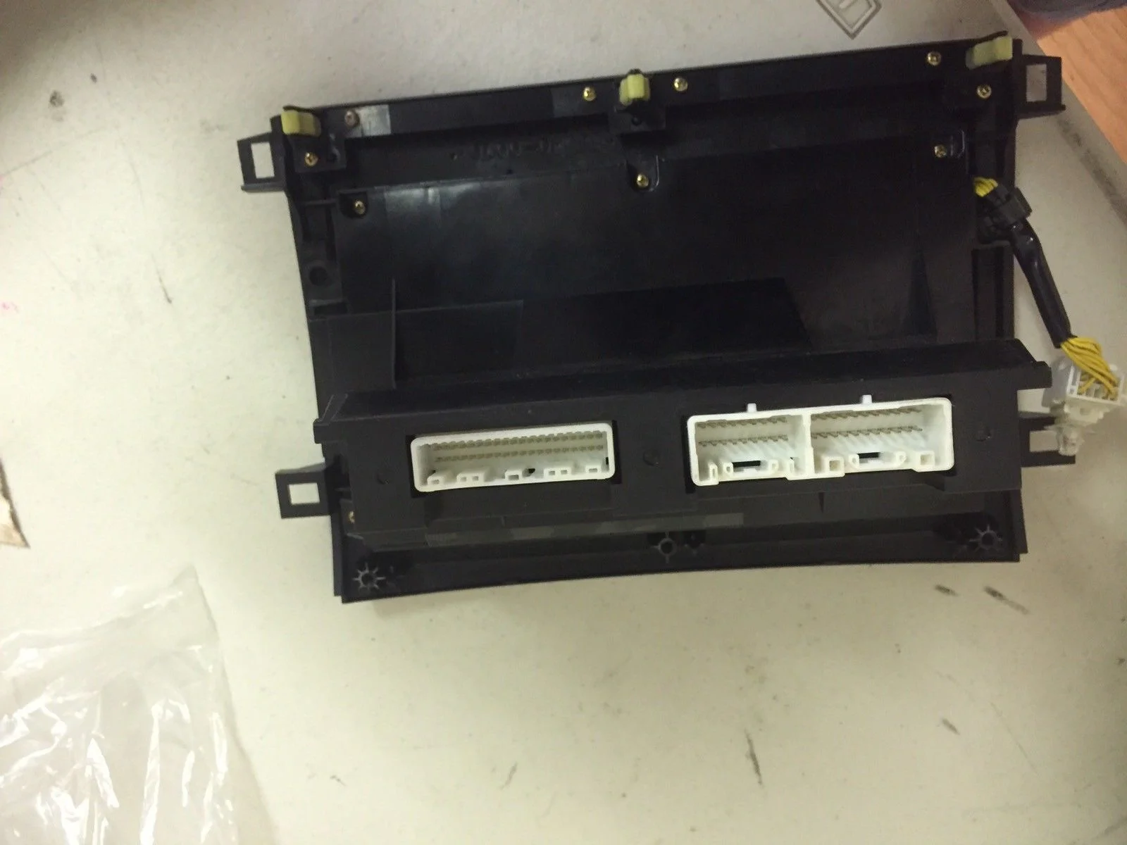

HVAC HEATER AND AC CONTROL PLEASE BUY RECONDITIONED AS PURCHASING NEW AND ASSEMBLING ALTOGETHER WOULD COST YOU ABOUT 1000 USD OR MORE I BOUGHT 03+ HEATER AND CONTROLS DIAL TYPE AT ONLY ABOUT 135 USD AT EBAY.AU AT FRESH CONDITION

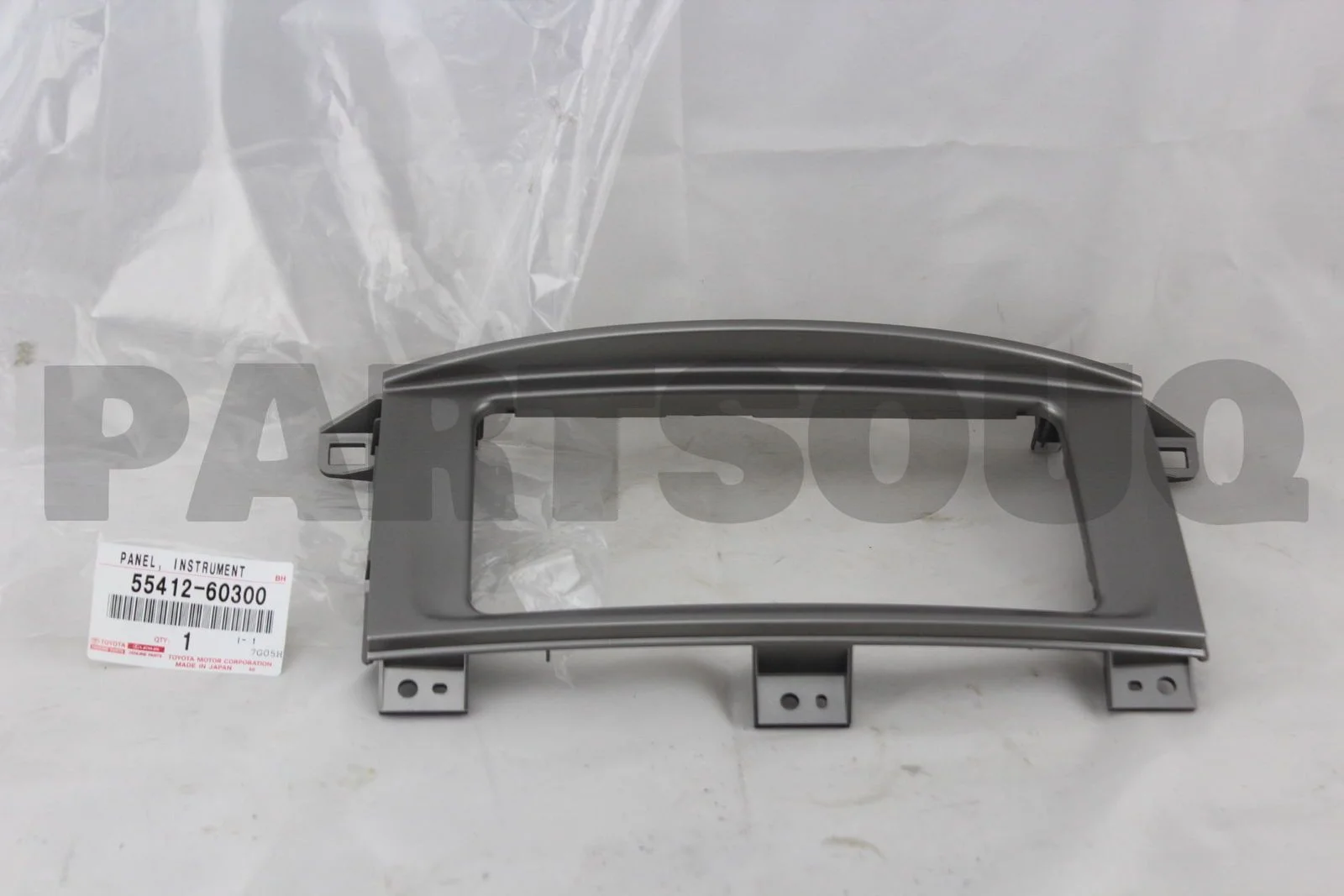

55412-60300 center upper Dvd head type panel OEM:70USD

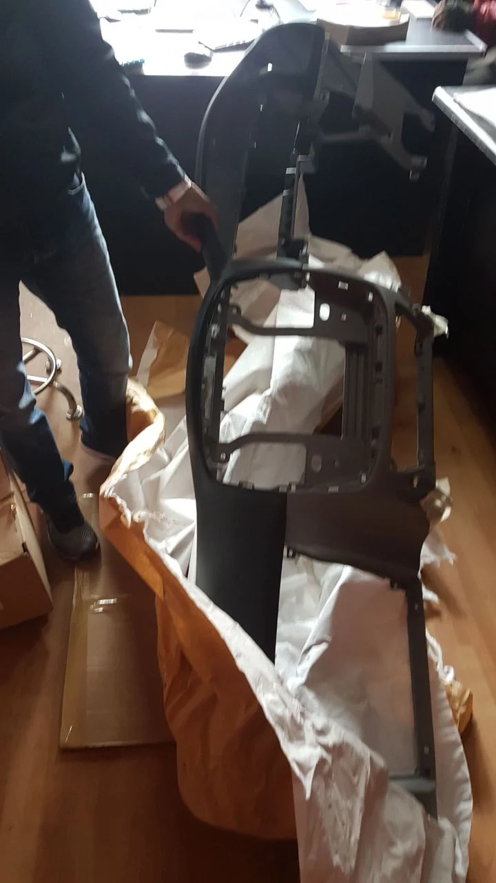

Most importantly great thing is reinfrocement is same as 98-02 even register assy blower no 1 and 4 are same (DRIVER SIDE VENT AND PASSENGER SIDE VENT)
glove box and driver side lower panel also fits same with cigratte lighter panel YOU JUST REPLACE THOSE FROM OLD DASHBOARD TO NEW ONE.
After everything main obstacle here is wiring of HVAC
SO I AM WORKING ON IT AND MY MORE PARTS ARE ARRIVING I WOULD KEEP UPDATING THIS POST AS I PROGRESS

Heare are some photos
Do you have the part number for the 3 knob climate control you pictured?
