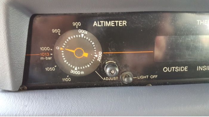

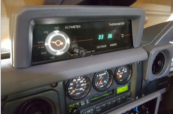

Hello Charles / @Gun Runner 5 ,
From my FZJ73, when I cleaned the pod and replaced the bulbs.
I did not remove the front plate, though. Another item for the to-do list...
Juan
Juanj
Does the pod lights dim with the instrument panel. If it does it will make it easy to hook up my aftermarket gauge lighting to this loom plug.?
Juanj
Hello @ozcrusier ,
My panel does not have a dimmer.
The pod lights do turn on with the rest of the panel, though. It is possible that a dimmer would affect them.
There is also a small on/off switch right of the altimeter adjust knob. It is used to keep the pod lights off regardless of the main panel.
Juan

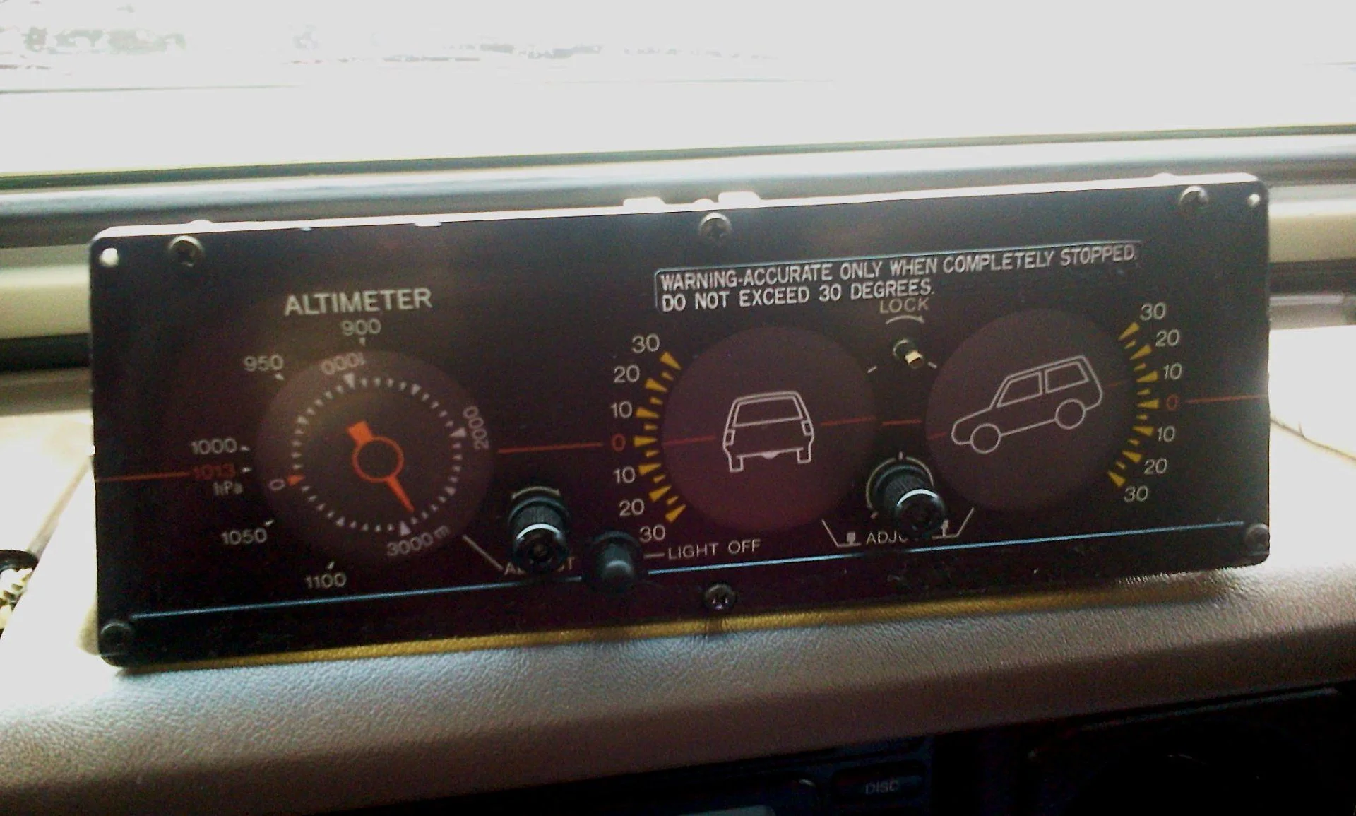

I figured if I was going to replace a blown bulb I might as well upgrade to LED.
The light works on mine but kinda dim so I just leave it off.
My boss just got himself a new 2017 Tacoma TRD Pro and was showing off the digital inclinometer in it between the tach and speedometer as if it was something new. I told him my 1986 cruiser has the same thing and it seemed to burst his bubble. :-/
