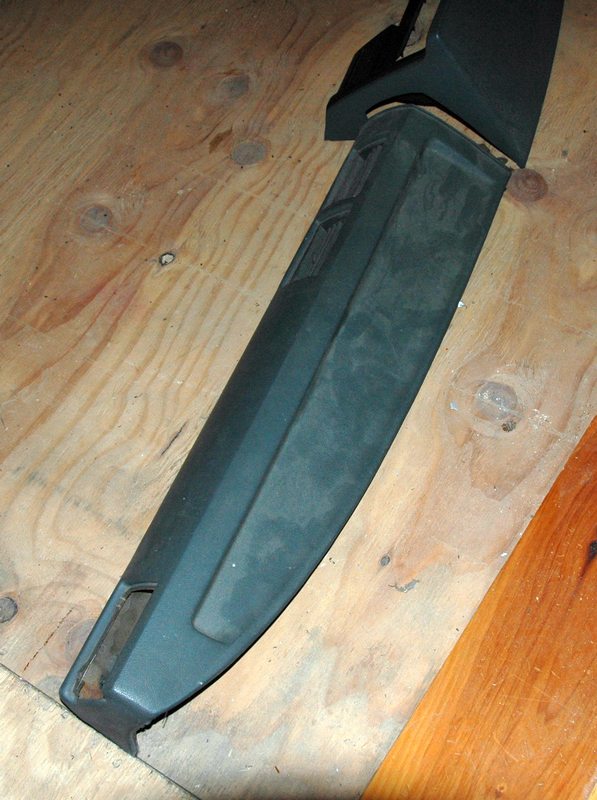

This is the "long tray" dash pad:

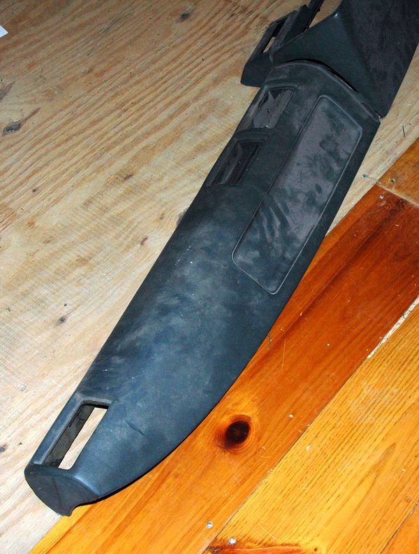

This is the "short tray" pad:

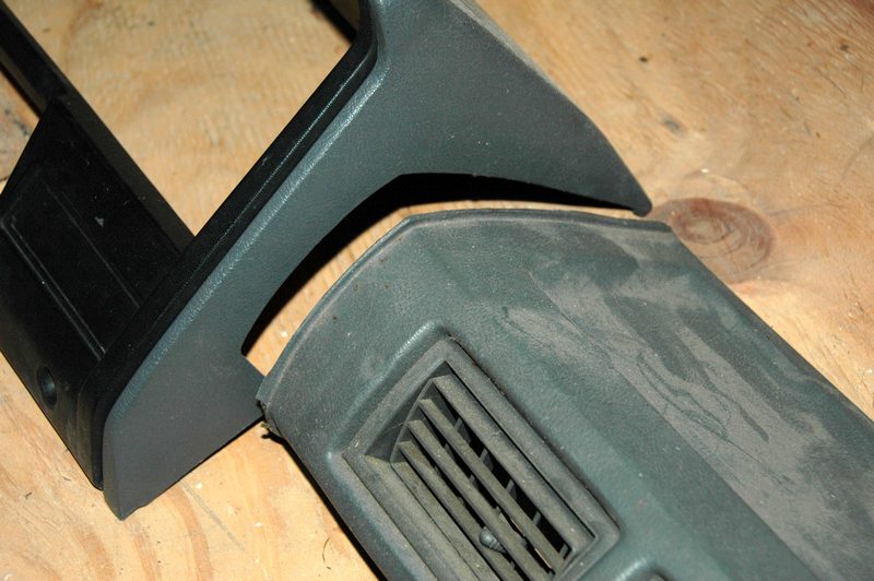

Note the difference in the "tray" that is formed in the top of the pad. They used the long tray pads from 1984 until somewhere in 1986, then they switched to the short tray pad. They are not interchangeable, unless you also switch out the bezel around the dash cluster. Note the long tray pad has a more angular profile where the pad and bezels meets:

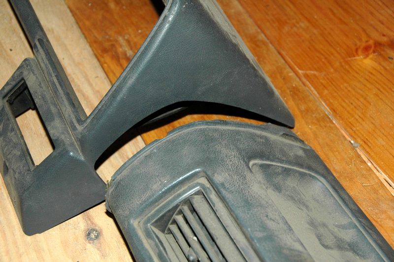

The short tray pad is more rounded:
