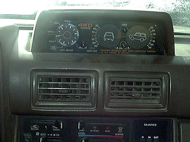

I know that this is available as an option up in the overhead console if you also go with an aux tank, but I wish that the original 80's came with the inclinometer/altimeter/compass that the upper trim 4runners of the 80's and then the later FJ Cruisers came with (and the Tercel 4wd...haha). I have toyed with retrofitting one on mine, because I think they are cool looking.

Yeah I always thought those were cool-looking. Lotta real estate though. Maybe a digital version where you can switch displays and that's one of them...

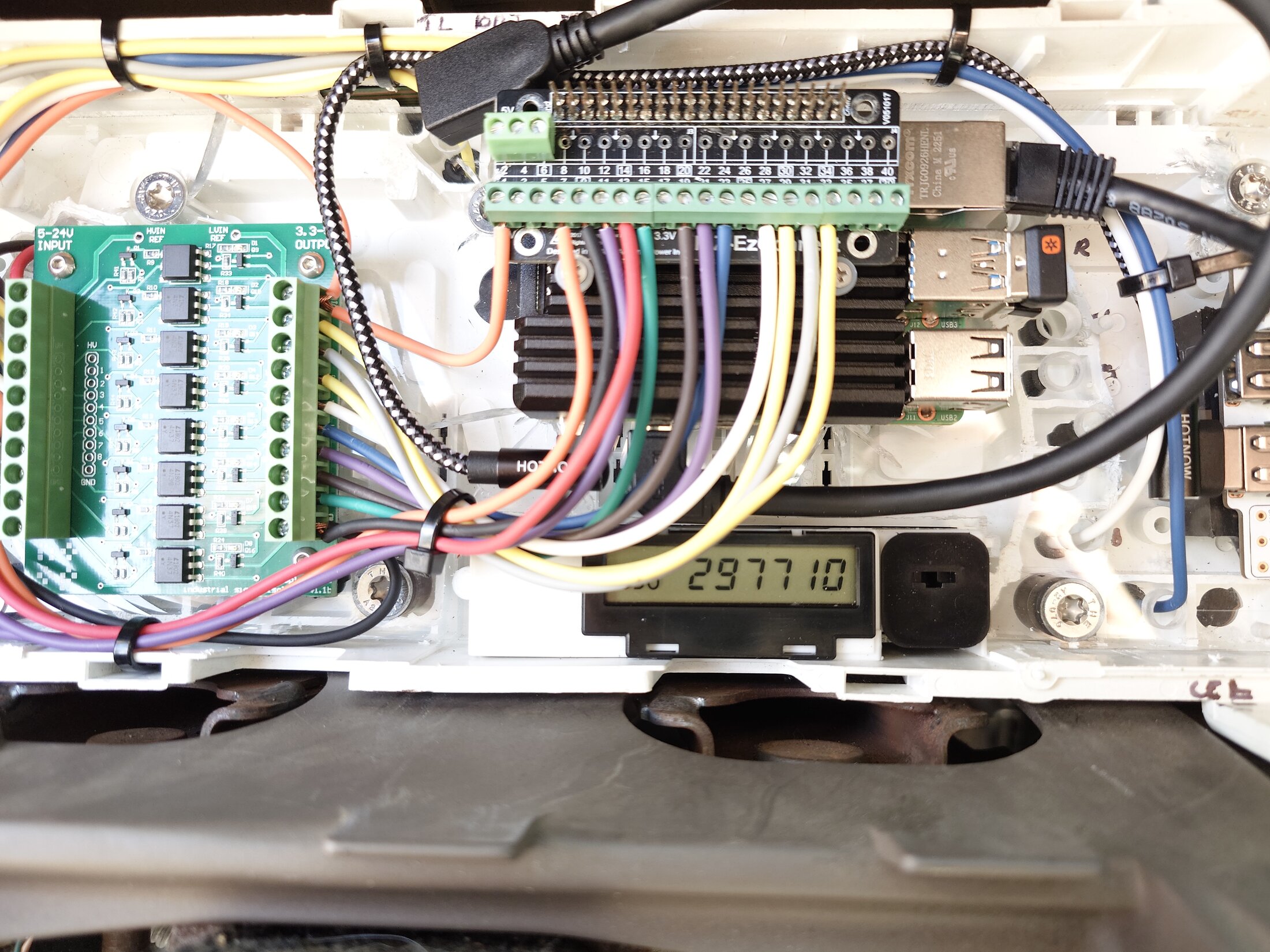

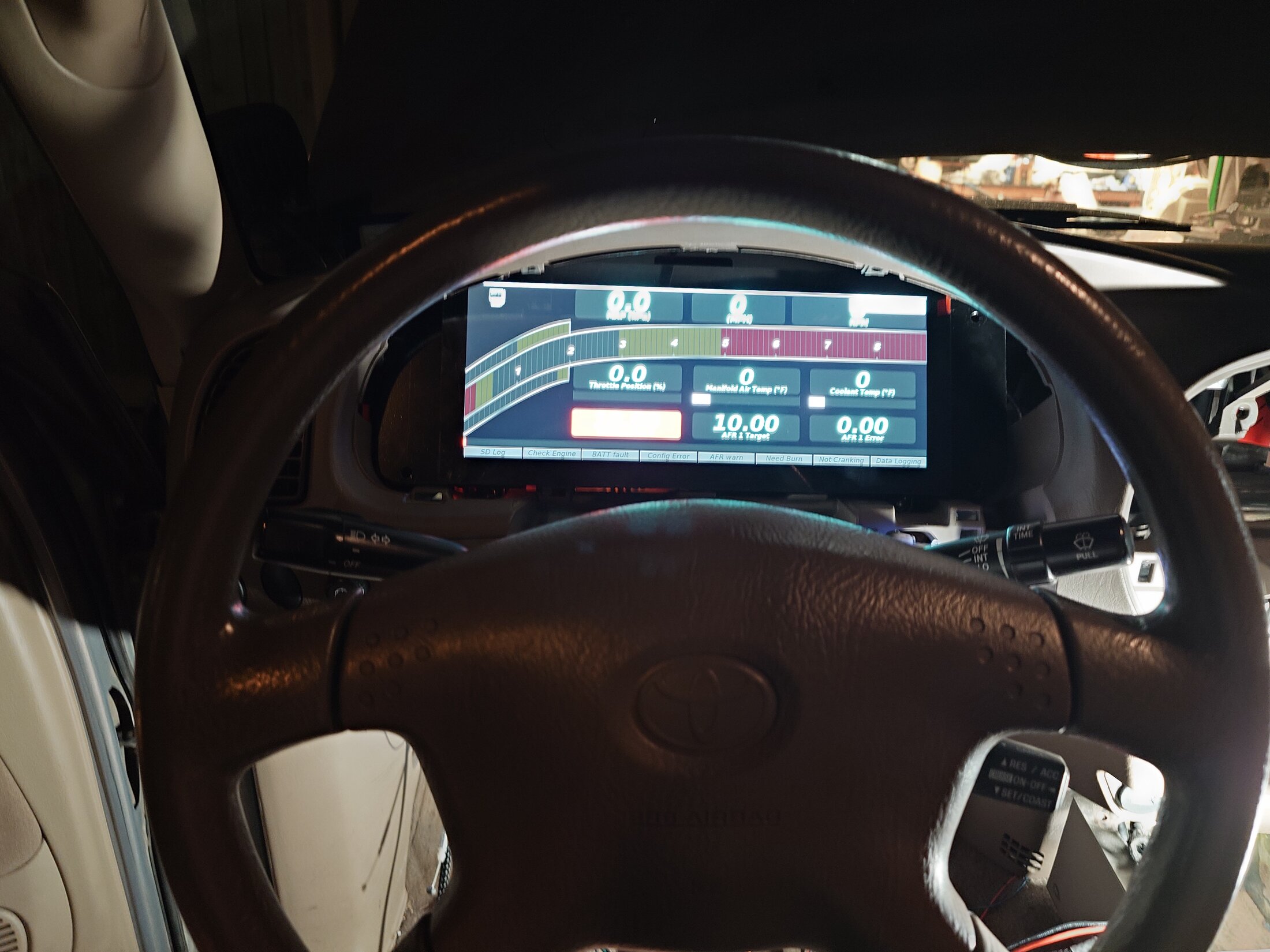

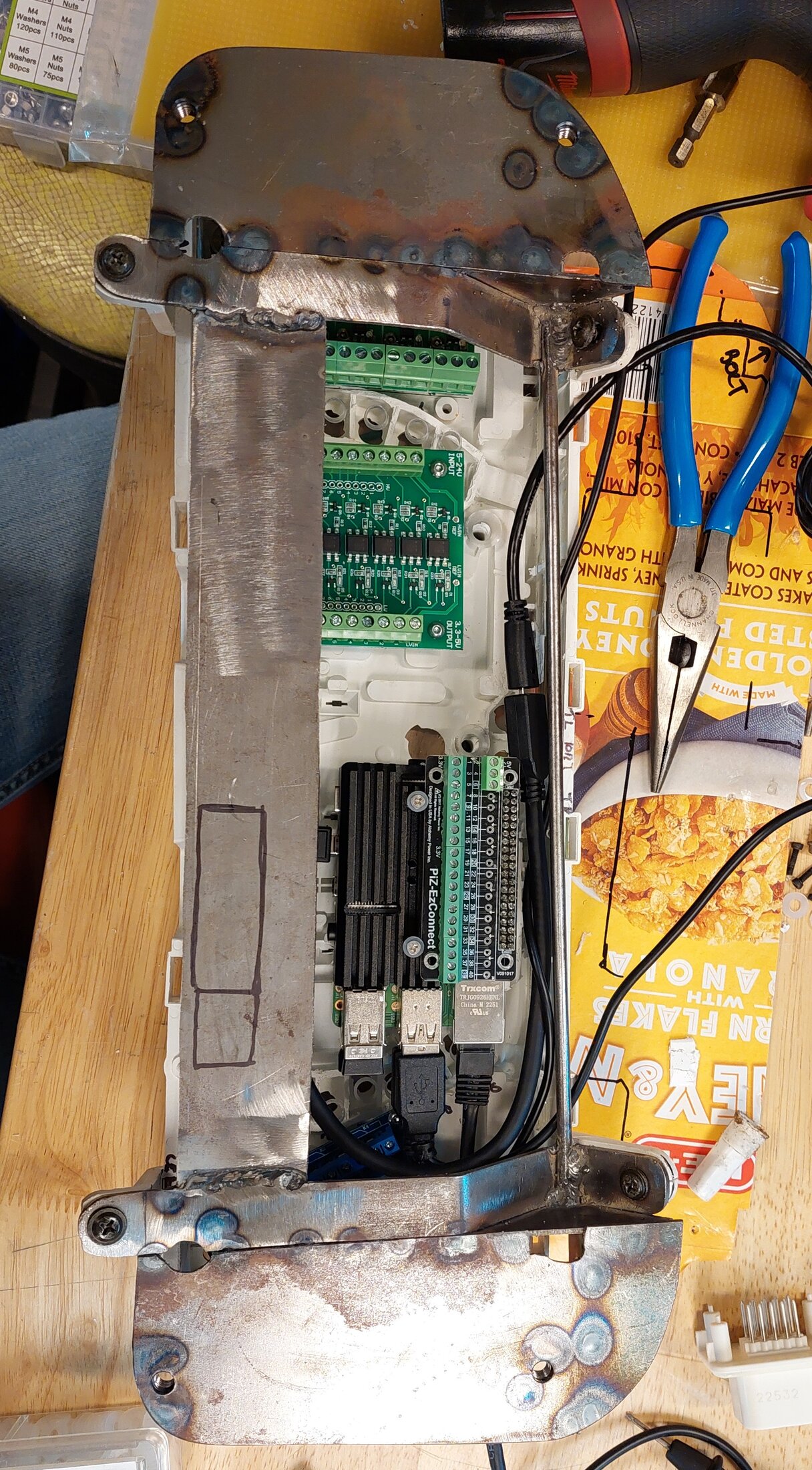

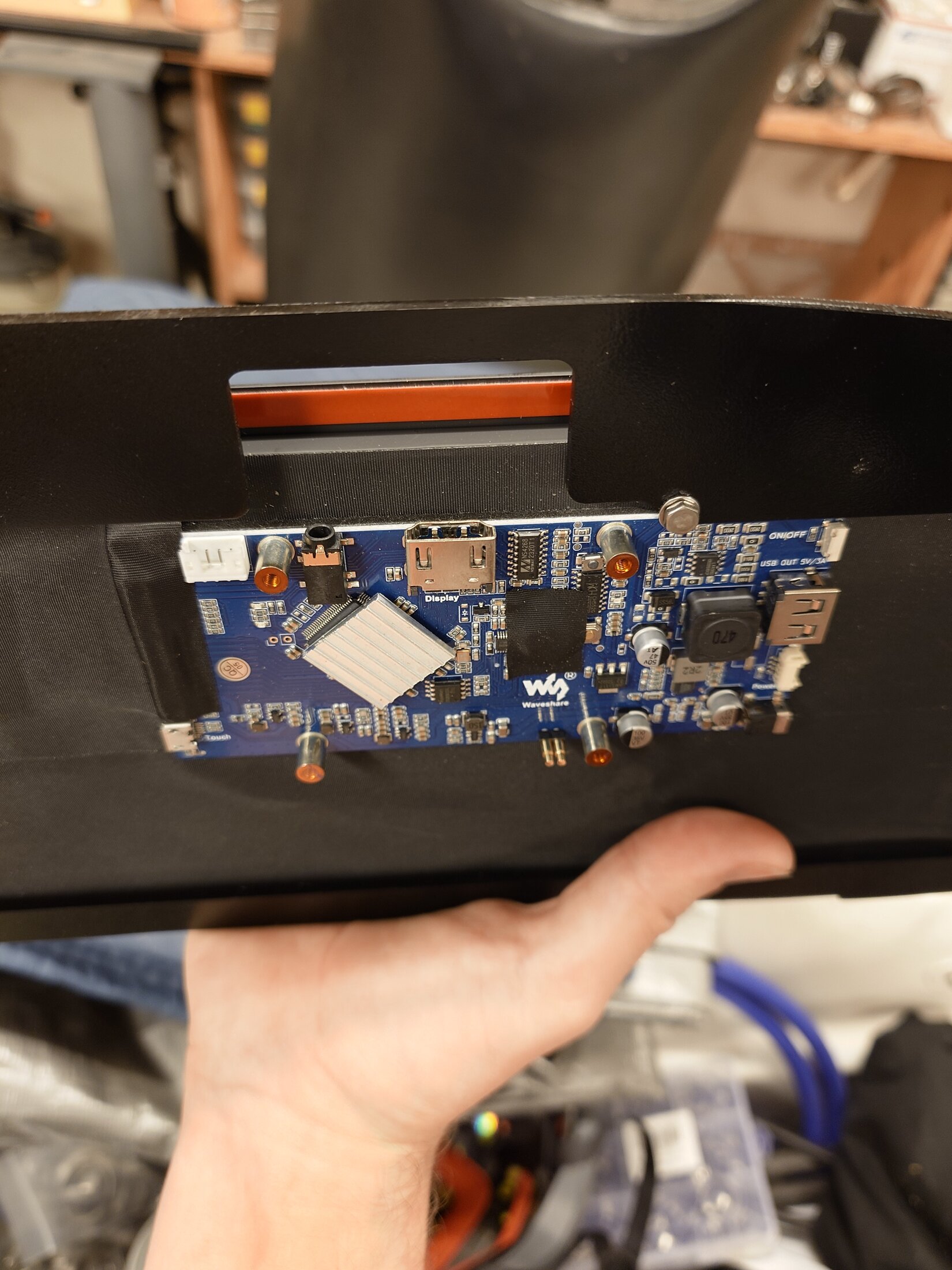

I'm doing a TSdash install on my truck now with a 12.3" display, rpi4, and megasquirt 3 for the sensors. The dash layout isn't what I will use but the display fit pretty well in the stock opening. You can do it cheaper than the haltech setup but it is a lot of work.

Nice work. I can definitely see the utility, but I really prefer analog gauges for my primary concerns.

Normally I would agree but for this case, I didn't want extra physical gauges mounted in/on the dash/console for my widebands and extra temp gauges stuck on the dash so I went digital to replace the stock setup and have it all integrated.

Totally get it... It's really more of an aesthetic thing than any practical objection. I definitely appreciate having access to secondary gauges even if it's only via my phone.

Fuel controller and i/o expander. I am using it to trigger and control some aux functions. TS dash lets you use the rpi gpio to add other inputs to the ecu for things like indicators and switches/buttons. I have an aem anynet can module for some more inputs for things like transmission temps/pressures, oil temps/pressures, and gear position. I am also doing flex fuel and coolant pressure as additional fields.
