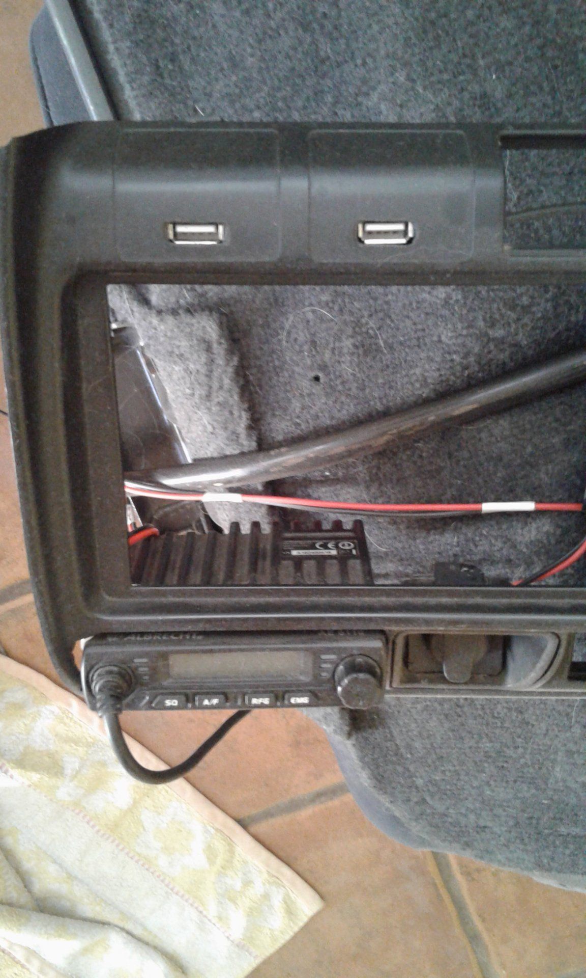

I have done exactly that. I use one to charge my phone, the other powers up my tablet when using topographic maps on trails. Dashboard in hallway at present........as you do. CB in ashtray slot is an Albrecht, looks and works fine there.

Nice work @Dave 2000. Is there a reason you didn't put two USB ports in one knockout? Thank you both for the info. I was hoping for an off the shelf solution option, but I can make this work

@Dave 2000 was the process as simple as cutting a hole to match the plug themn 2 part epoxy to where they meet on the backside?
Yes, the plug body mounts have threaded holes designed to take screws from the front, this would hold them in place, but of course the screws would look naf, so epoxy from rear, job done.

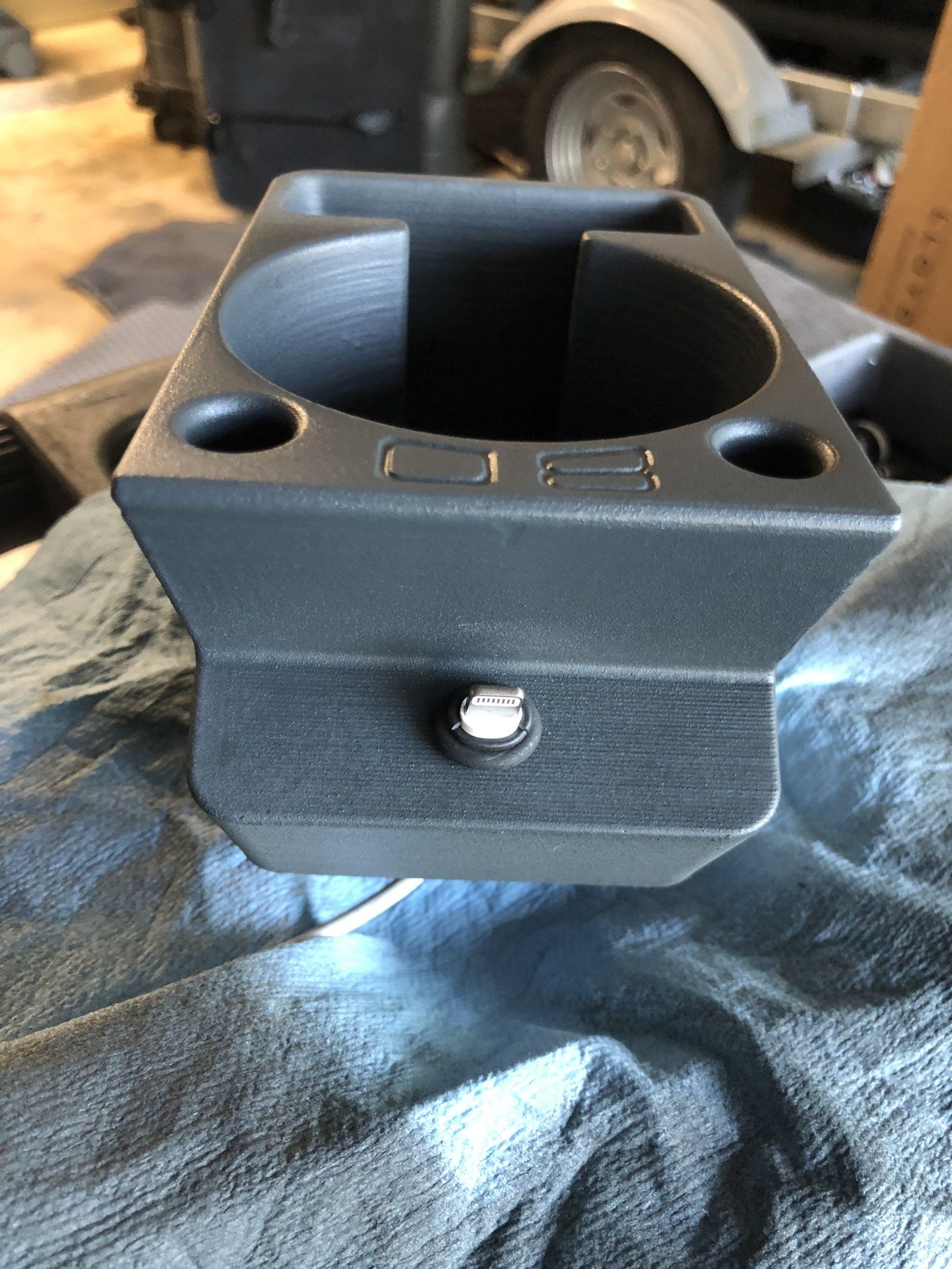

I have done the same as Norcal97, wired it to the memory wire of the radio (constant +12V). Works very well, does not fit the opening without a little work.
As for the USB input, I just modified a knockout to accept a bulkhead mount USB cable. Used this cable:
