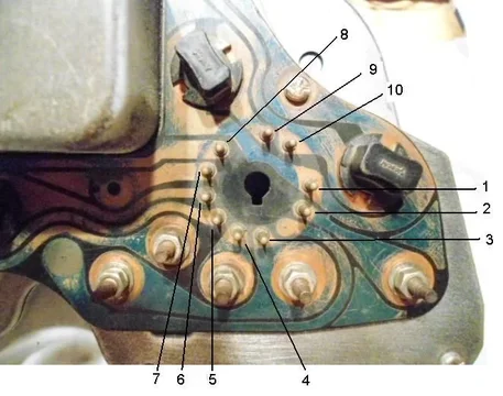

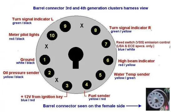

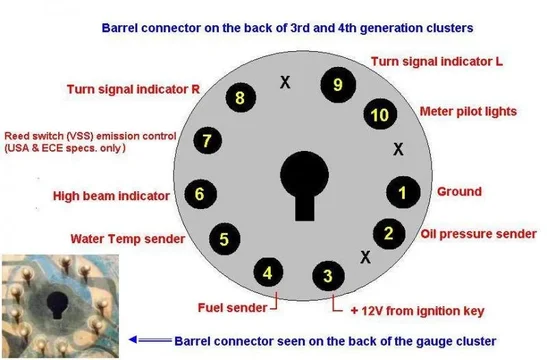

Here are some pics to help you out.
Pay attention to pin 10 (cluster lights) and pin 1 (ground).
Check the PCB for breaks in the tracks and bad contacts at the bulb holders.

BTW you have a '79 and later cluster so your high beam indicator get's his ground from the Ammeter connector.
Rudi
Rudi, thank you so much for the very useful information contained in these three pics, I'm sure this info will come in handy in the future for me and others here on MUD.:cheers:

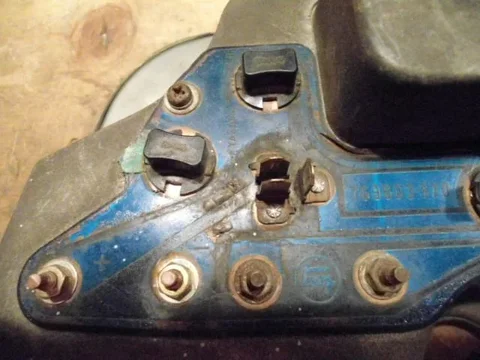

If you mean this 3 prong connector.....
The two horizontal prongs are for the Ammeter (12V when the key is in the "on" position) and the vertical one is ground for the High Beam Indicator.

on the pin connector. Which number connector sends power to the dash lights?
Well, you should be able to completely remove the gauge panel and follow the circuit board from each light to the corresponding 12V supply and ground using bj40green's handy diagram. I'd just use a multimeter and test continuity on everything, be careful checking voltage with the harness plugged in, it's real easy to ground something accidentally and fry it worse... also check your fuse block and grounds. Good luck. Try to dig around and find the wiring diagram for your year, it's on MUD somewhere.

Pin 10 should be 12V (or less if you have a dimable cluster lights) when the light switch is "on".
If the gauges and the turn indicators work, it's NOT A GROUND problem.

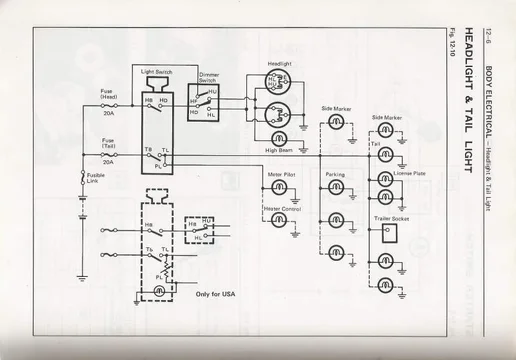

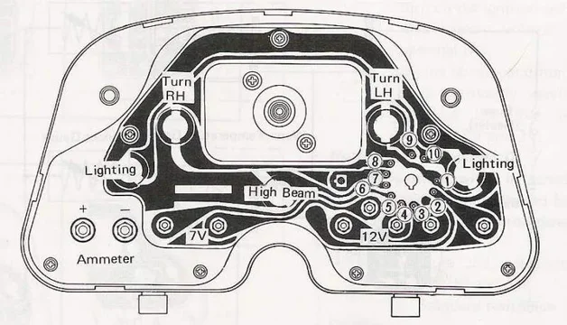

This pic is for a '72 - '78. It's a bit different than the cluster you have but the problem you're working on is the same.
In short;
1. There should be 12V on pin #10 when the headlight switch is "on".
2. Follow the track on the PCB and check for cracks.
3. When you have 12V on pin #10 but the first bulb to the right (in the pic) doesn't work, you may have a loose pin in the PCB that needs some soldering.
4. Check contacts on bulb holders.
5. Check bulbs by replacing them with the "turn" bulbs.

another approach
Here is another approach.
Check for 12V on pin10 on the cluster barrel connector.
If YES follow procedure is previous posting.
If No..... go one step back and check your light switch.
Check for 12V on terminal PL on the light switch.
Either the one on top or the one on the bottom with the rheostat.
If YES on TL and NO on PL -► bad light switch.
If NO on TL and NO on PL -► check for voltage on TB.
If YES on TB but NO on TL and PL -► bad switch.
If NO on TB -► go one more step back to fuse and fuse holder.
Rudi
