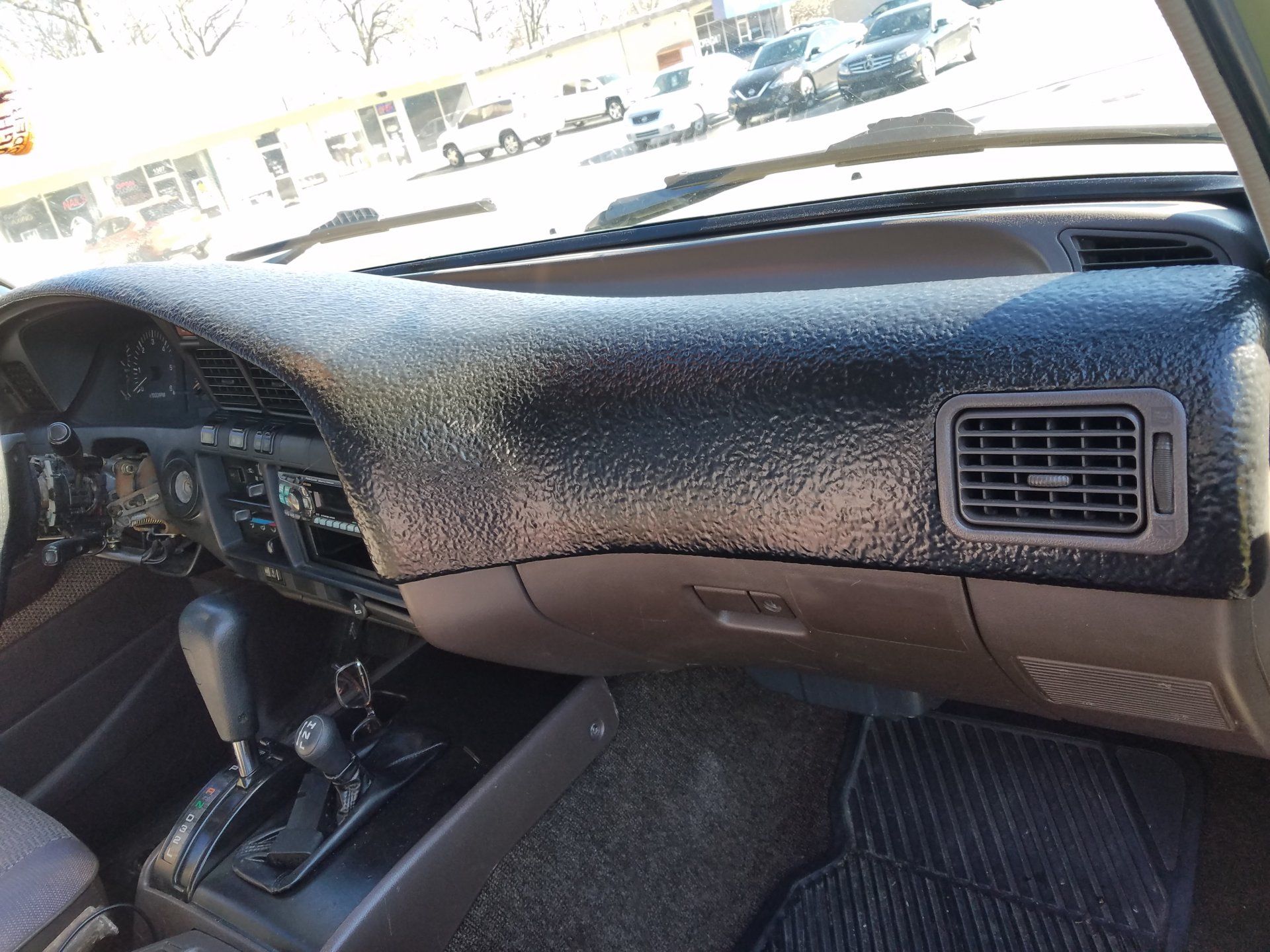

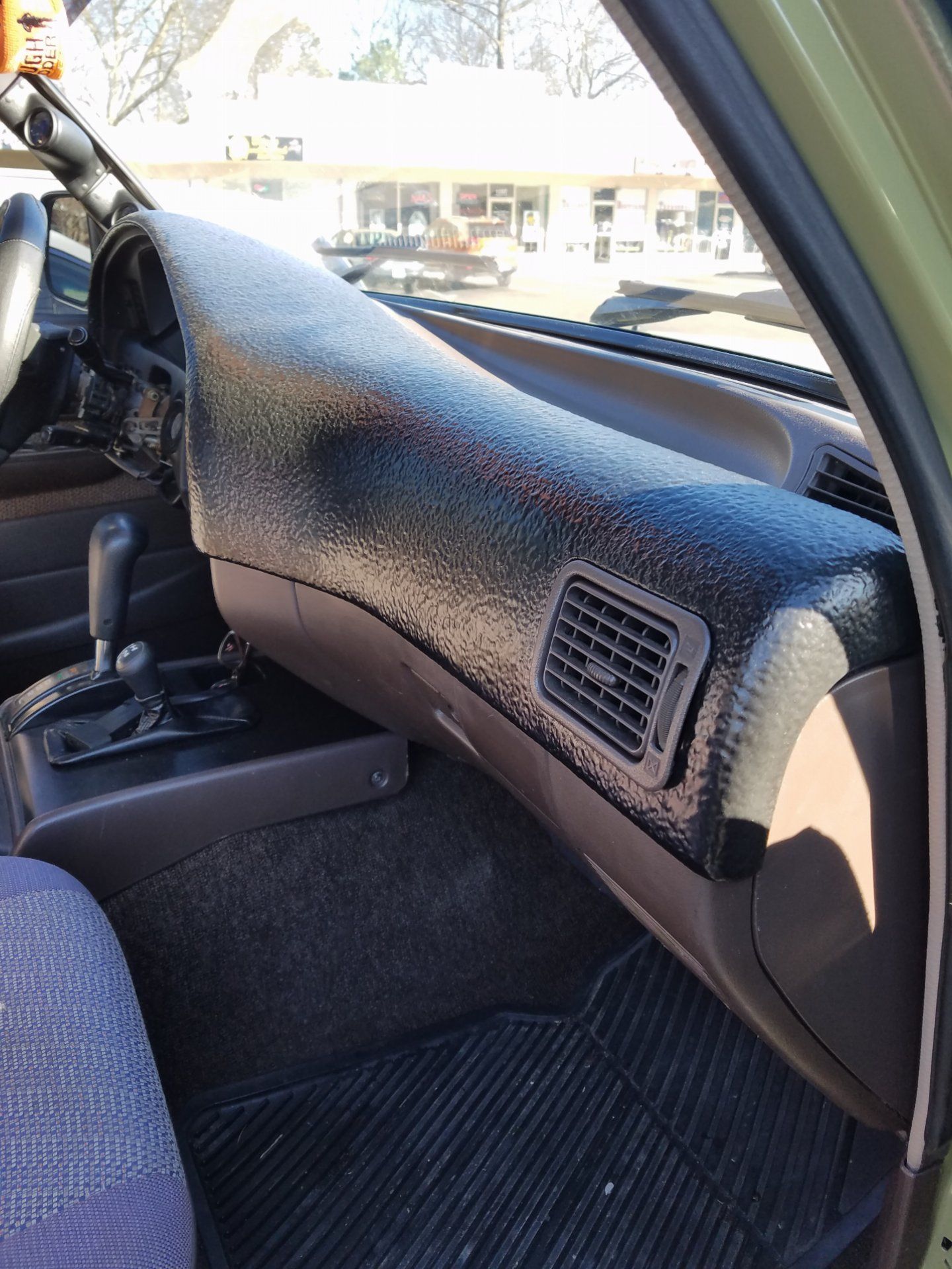

You can pull dash and remove the vinyl from the top pad then wrap it in felt from a craft store then coat it in several coats of fiberglass resin and some matt. then a little filler and sanding and spray it with some monstaliner! i did mine and its awesome!
Picts please!
Picts please!
How does it look installed? Do you get lots of glare? My dash pad is still good, but when it cracks I like this option.

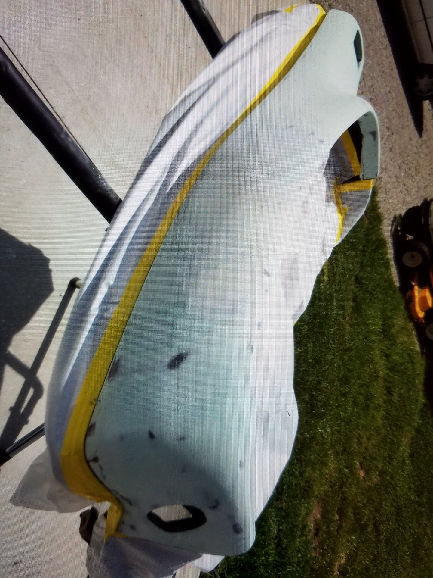

What you see in the pic is a skim coat of body filler before prime. I peeles off the cracking vinyl and was left with a thin layer of foam. Then i wrapped that with felt from hobby lobby. Next mix up fiberglass resin and saturate the felt with resin using a paint brush then add a few layers of fiberglass matt as you go being sure to saturate everything with the resin. After this all cures scuff it good with 80 grit sandpaper and then you can begin shaping it up with a thin coat of the body filler then i prumed and sprayed monstaliner. Two years later it still looks perfect. I will get some pics of it and post up
That looks much better than a bunch of cracks. Good solution for a difficult to solve problem...:beer:
