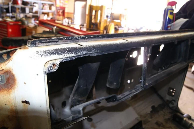

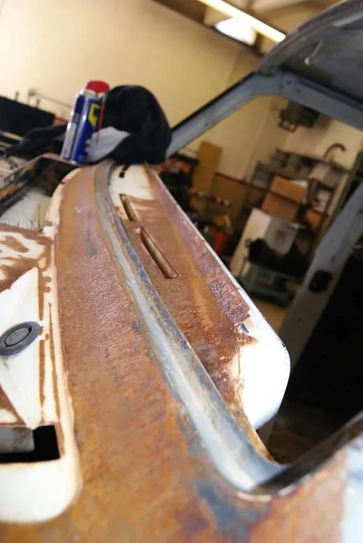

Can you go all metal? My 40 was like that and it looked good.
not sure on early dashes, but here's a 78 dash sans the padding
Just an idea. To do it simple, why not Use a later dash from SOR or used one in good shape and add a repro for the center section created with wood and vinyl or 3d printing then glue it ??
Oh, yeah! This was what I was hoping was under there.

I'm starting to think, "forget the whole dash as it just gets in the way of a roll cage."
Strip it down to like as in nuclearlemon's photo and in the dash pad's place have a bar go across below the windshield and put a rollcage pad on it. Below that have a completely flat dash panel like an FJ40, maybe even with some FJ40 dash components visible in the end.
Looks like the defrost vents would still remain without any work.
attachment.php
Nuclearlemon, any chance you can confirms that a flat plate dash panel would easily stretch form side to side?
