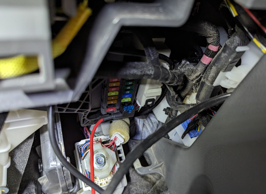

It was also pretty easy (since I’m not so mechanically adept) to add a fuse tap to the passenger side fuse box in the front foot-well and then run the wire up through the passenger side A pillar.
I tapped into the interior fuse panel. I wanted to have a dedicated fuse for it. I have 4 dash cams: front, rear, and 2 rear sides. I've been wanting to do a video and show this to the community.

There's two interior fuse boxes under the dash at the footwell behind the cover with unused circuits that an add-an-tap can pull from.
I'm pretty sure the fuse box under the driver footwell are all switched on with the ignition in the on position. The passenger footwell is constant on. Choose the source that is appropriate for your use case. Then run the wire up along the door trim and headliner. You'll need to remove A-piller cover (10mm bolts under the grab handle), to run the wire under the curtain airbag.

Thank you so much for the image. It helps a lot. I will have to look at my 2014 to see if it's in the same location as yours. If it's constant power and the dash cam is set to record whenever there is something happening, wouldn't this drain the battery of the vehicle?
