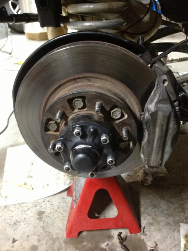

Dropped the birfs off today to get the ABS tone rings pressed off the old and pressed on the new ones.

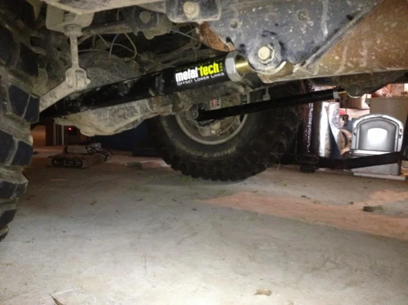

In the meantime I threw in MetalTech's lower rear links. Man these things are beefy! I have yet to be disappointed with any of their products.
Got her buttoned up except for the caliper on the PS. I'm changing out the axle to caliper Brake lines and the PO torqued the flared fitting on the hard line too much and it will have to be replaced.

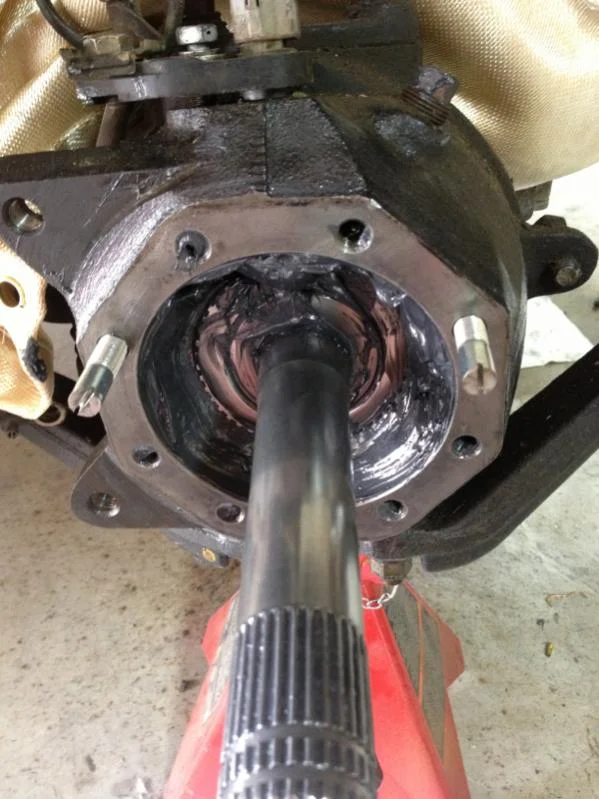

This is my first front axle rebuild and I found the following to be very helpful. Buy two 10mm x 1.25 pitch bolts at least 40mm long. Cut off the bolt head to make a stud, cut a slot for a screwdriver, and install them in the knuckle at 10 and 2. This helps align the gaskets, spindle, dust cover, and dust seal. I pulled this info from the FAQ. See pic #2...
Looks good bud especially like those rear links nice and beefy, reading your posts I'm now kicking myself as I forgot your measurements :( my apologies do you still need them? I just came in from the shop and will be happy to go grab them.
I sure do Larry. whenever you get a chance.

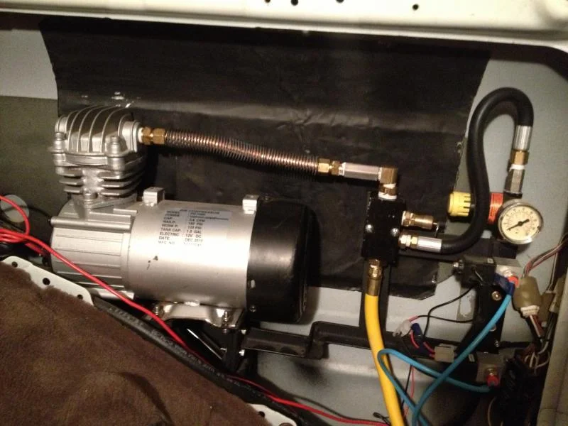

I want to close out the conversation that took place in comments #116-122 for anyone who may reference this thread for their OBA setup. I made a mistake when plumbing my OBA. As some of you may know, when buying most compressor and tank setups, they come with their own manifold which ties in the pump, tank and typically a 1/4" outlet. Well I removed that manifold in place for a much more complicated system. What I didn't realize is that I had removed the check valve and unloader. This isolates the pressure from the pump head. So when the pressure switch would trigger the relay at ~110psi the pump had to overcome all of that head pressure, which is the reason I kept popping 60amp fuses.
I installed a check valve from Viair and incorporated the finned line that came form the factory. Since then I have only popped one fuse when I stopped the compressor during a charging cycle and tried to turn it back on before the pressure trapped between the check valve and the piston had a chance to leak off. If I had an unloader this wouldn't be an issue. Below is a picture.

Which pump is that? I was looking at Viairs just like that today to hook to my old oba tank.
It's a Puma (part number NCPD-1006 12V). Comes with a 2.5 gal tank and puts out a little over 3cfm if I remember right. If you are interested I can dig up the link tomorrow.
I want to close out the conversation that took place in comments #116-122 for anyone who may reference this thread for their OBA setup. I made a mistake when plumbing my OBA. As some of you may know, when buying most compressor and tank setups, they come with their own manifold which ties in the pump, tank and typically a 1/4" outlet. Well I removed that manifold in place for a much more complicated system. What I didn't realize is that I had removed the check valve and unloader. This isolates the pressure from the pump head. So when the pressure switch would trigger the relay at ~110psi the pump had to overcome all of that head pressure, which is the reason I kept popping 60amp fuses. I installed a check valve from Viair and incorporated the finned line that came form the factory. Since then I have only popped one fuse when I stopped the compressor during a charging cycle and tried to turn it back on before the pressure trapped between the check valve and the piston had a chance to leak off. If I had an unloader this wouldn't be an issue. Below is a picture.

I put a Viair 10010C on my grocery list. I plan on connecting it directly to my old tank with my old manifold and tank with a 105 psi switch instead of the 150 I was using before. I figure that is easier than making room for an a/c compressor on the engine. I also won't have to worry about an oil feed.
Thanks Larry, I forgot that I have a modified extinguisher tank that may fit in the location I need better than the tank I have. I stopped using it because I was worried about water accumulation and didn't have a way to drain it.
