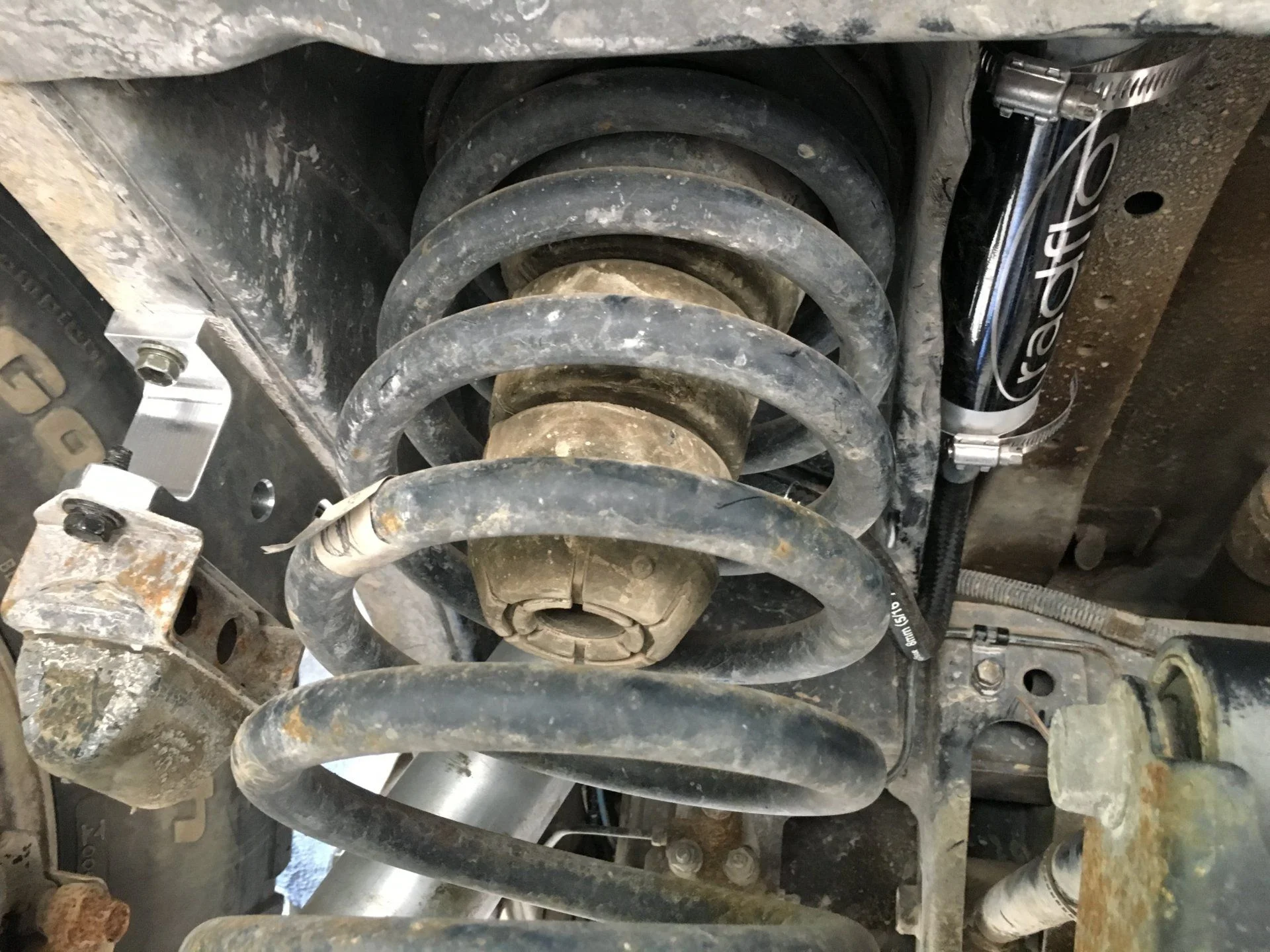

After sitting in my garage since 2013 and the Doestch Techs way beyond shot, I installed the Radflo rear shocks. I welded some Resi can mounts onto the upper spring bucket to keep them out of harms way.
The extended length is identical to the old shocks, but the compressed length is ~.5" longer, so I replaced the 2" bump stop drops with 2.5". This will also keep the 37s out of the inner fender well.

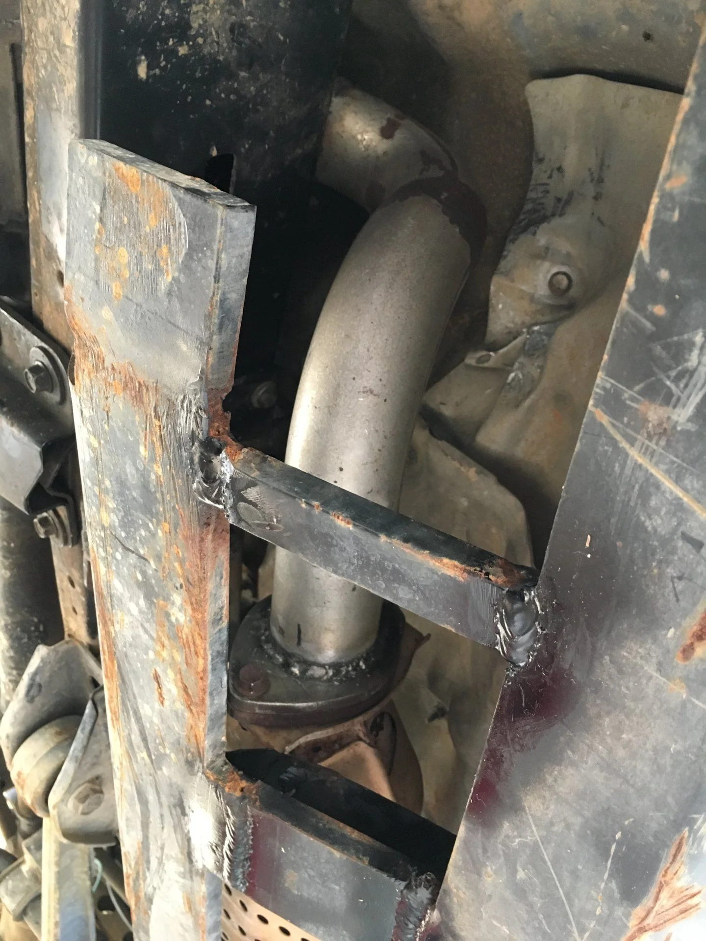

I enjoy fabricating, especially when I have access to the right equipment. With that said I absolutely loathe exhaust routing in the driveway, but it had to be done. Last time I rerouted the exhaust I left on both cats and shot through a tiny opening between the frame and the body. This caused the floor to heat up and the exhaust to occasionally rattle against the frame. Pas bon! So out came one Cat and the new routing ensued.

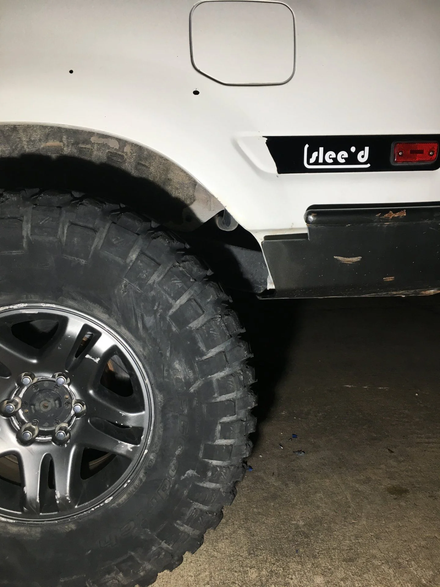

I also nipped some off of the the bumper wings and back of the rear fender wells to keep them out of the tires when she gets really twisted up.
