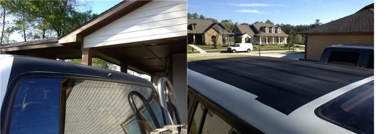

  4. Never paint outside when pollen is in full swing! My black roof has a suede texture to it
Here is a picture of the roof after welding and body filler, and then after paint. I wasn’t worried about it being perfect, I will be spraying the entire truck with bed-liner. Hopefully this will be done before SCC.

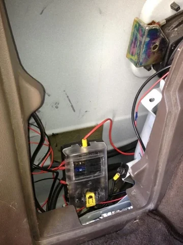

I installed the aux fuse boxes in the front and the rear. I utilized part of the bottle jack mount and one of the existing threaded holes to mount the rear. I have yet to mount the front, but all 6 slots are pretty much used.
