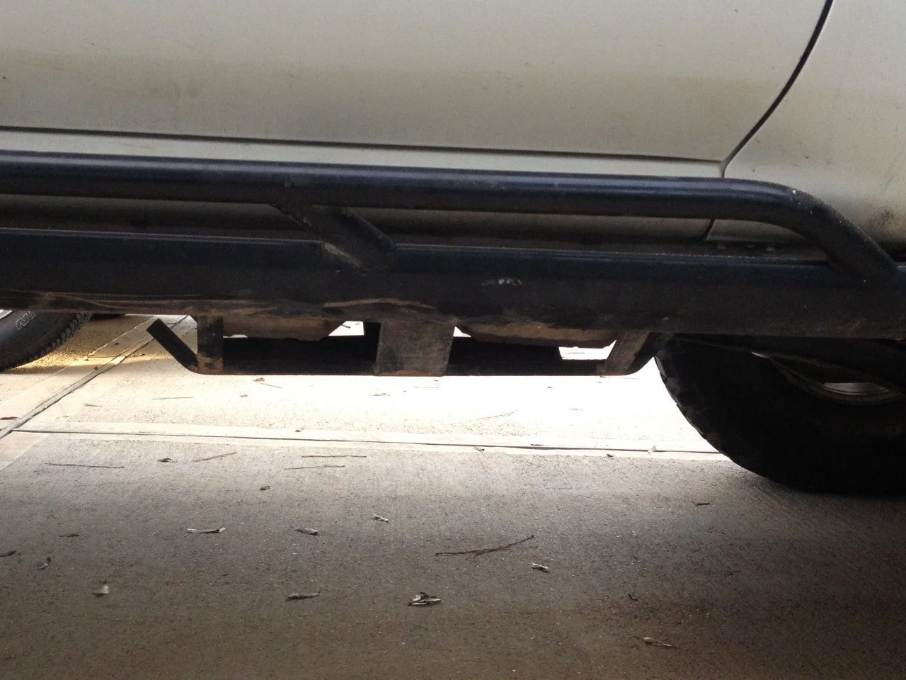

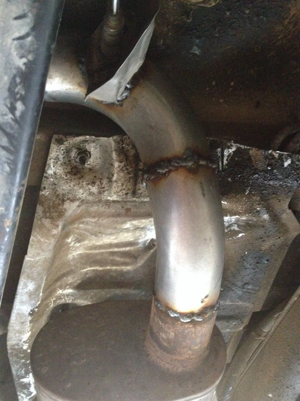

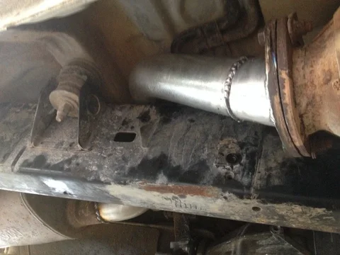

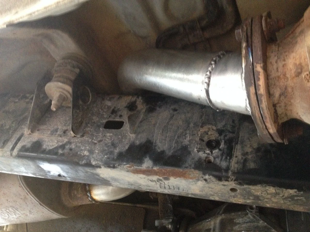

Thanks for bumping this, it reminded me to update my "last minute mods" before SCC 2014. I ran the exhaust over the frame and clearanced the cat protection on the slider. I bought mandrel bent 45, 180 degree piece on eBay for ~$30. I used all of the bends and could've used another 45I'm going to redo this exhaust routing soon, cutting back to one cat and going over the frame where there is more room. Not having that cat protection hang up all day was an extremely nice change.

Here's the before and I'll get an after shot when we get back home next week
Looks good.
Did you notice a difference in heat?
I am sure that it is not much hotter since you already had the heat liner in cab floorboard.
I did notice more heat. I put an additional layer of insulation on the floorboard. Once I go to a single cat, it will go over the same place that it does on the earlier models. At that point I'll use the factory heat guard that they used.
