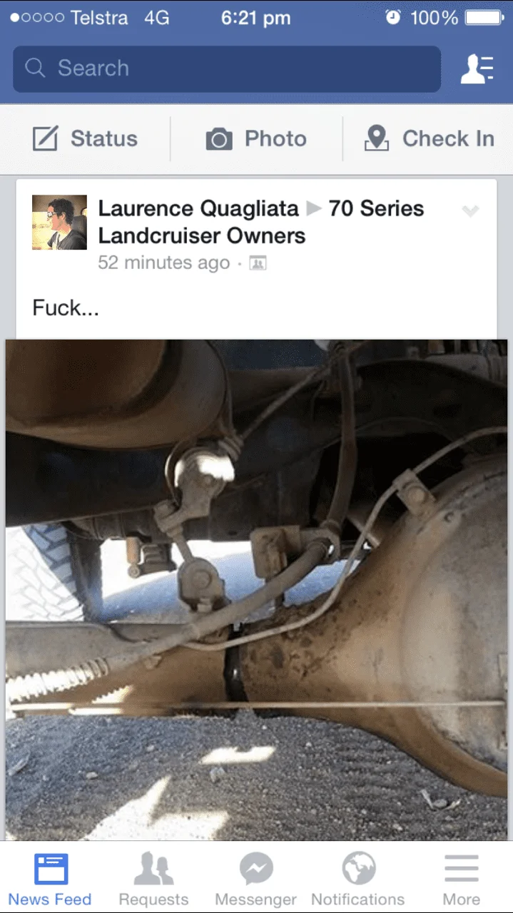

Do the 70 series full floaters ever fail in Oz I know you've got 1,000,000s of Km's of corrugated dirt roads all through the outback that's tough enough to kill anything
I've only ever seen one, it's a very very rare occurrence. This is a 75 series.
