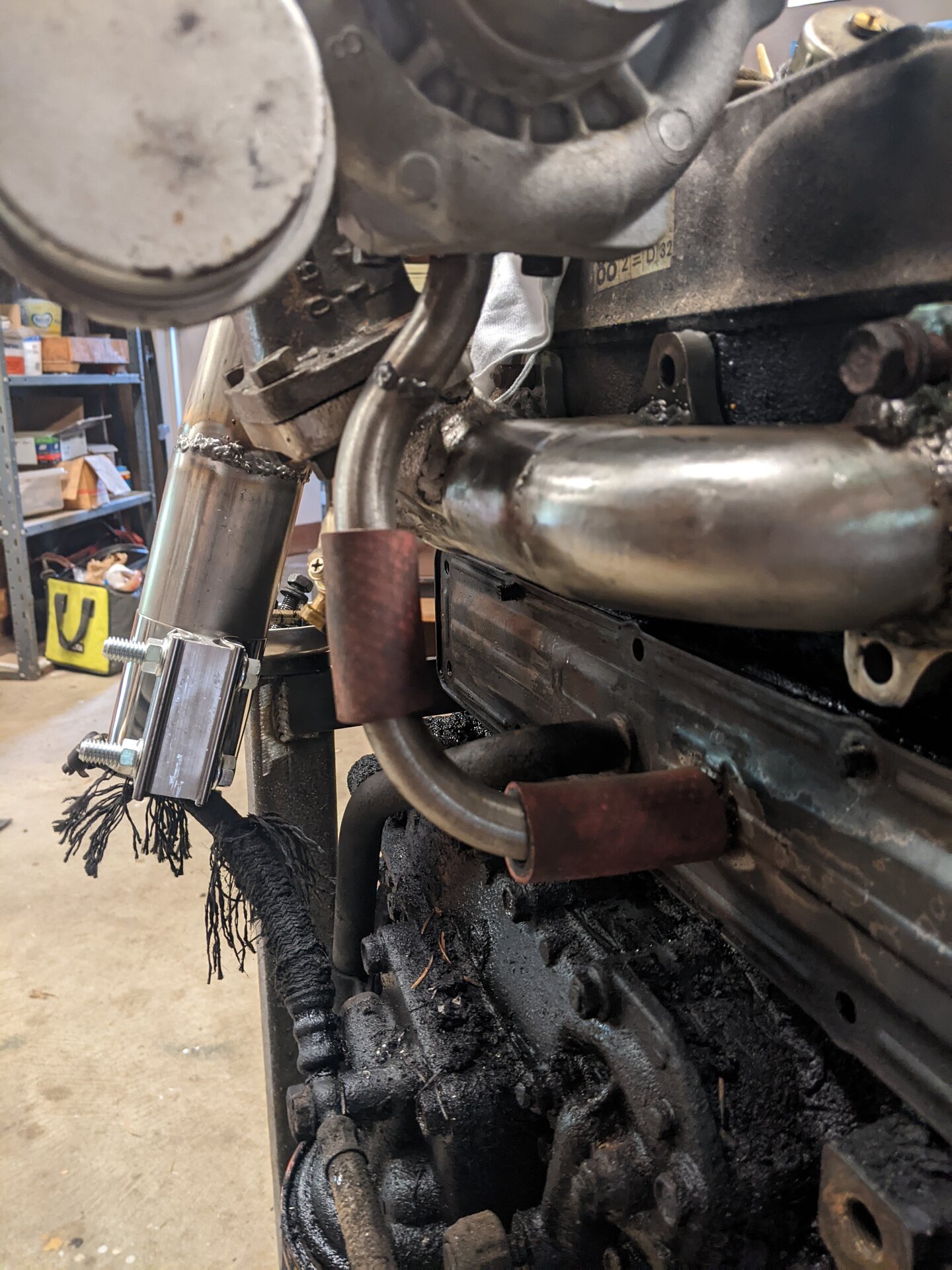

Got the drain sorta figured.
Not 100% happy with it, I've kinda had the fecal touch all weekend, so I'll probably change it.

on the line I’d be inclined to loose the upper rubber connection by the hot manifold.

With the drain, It's not actually that close to the manifold, and I have some high temp hose, so between that and some shielding, it'd be ok.
It's the hose clamp farm I'll object to as much as anything, so theres a good chance I will. :lol:

I did a little monkeying with the oil drain, kindof a pain in the ass to line up, glad I'm doing this on a spare engine and not trying to do it in the truck.
Funny how the camera makes booger welds look more like booger welds. :lol:

Would be nice to find something like this, it'd make life easier, but I'm guessing the cummins turbo has a bigger drain flange, although I didn't really look for measurements.

That's pretty much the last thing I can do without taking the 40 apart, weather is kinda s***ty for a topless truck, I don't have to be back at work till friday, and Mel is away for a couple days so may as well see if that exhaust manifold will come off....
Ok. This was kinda comical.
I've been dreading removing the manifold because you know how fun that can be.
Well, the bolts were all finger tight 🤣
Apparently that exhaust leak I could hear that I was absolutely certain was a joint under the passenger seat was the manifold.
So now this officially a repair. Clearly had to happen :lol:
That's it for today. Manifold is on, and side covers swapped. Turbo is pinned but not tightened up yet.

Well I really tried not to point out the obvious crap welds but since you did. You are SOooo good at everything else you do, why the lack of welding skills? Must be your welder right?
