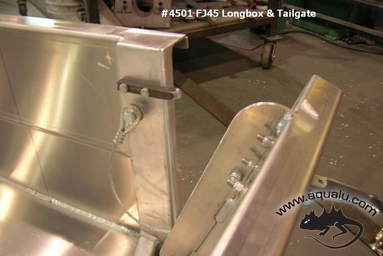

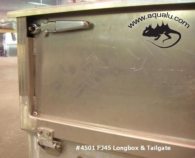

I have a real 45 tailgate, (beat to s*** wall art) so if I do a drop gate instead of bifold I'll maybe use those latches at the back.
Or something like these. I like simple things I can make myself.
If you had the factory interior cab latches you could make them like the Aqualu style.
They are functional.
View attachment 2224916View attachment 2224917
Trouble with that style (same as stock 45) is that the hook protrudes through the gate. Which is fine for just a tailgate with fixed sides but I want to be able to drop the sides independently too.
I'll have to think some more about tailgate. Drop or bifold because a fixed post at the corner changes everything.
